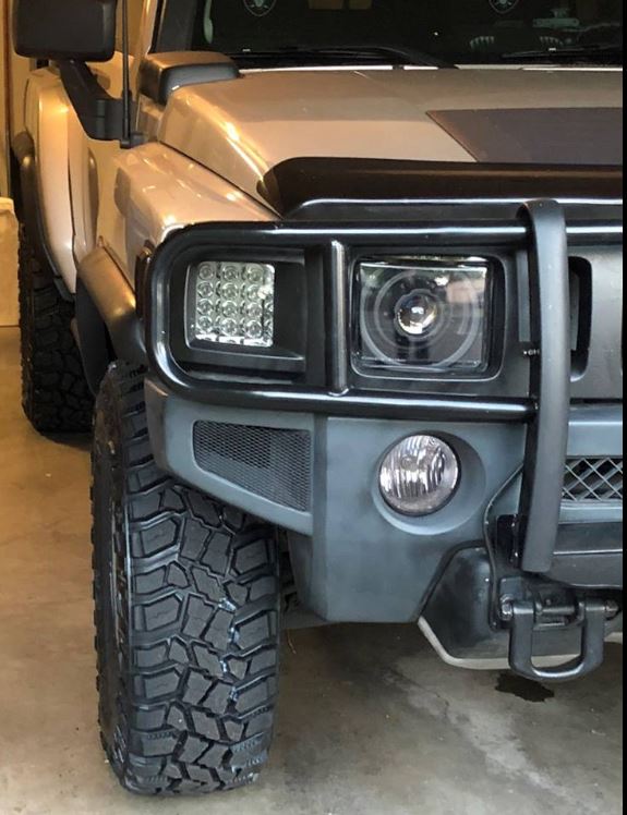

New shoes - Cooper Discoverer STT Pro's

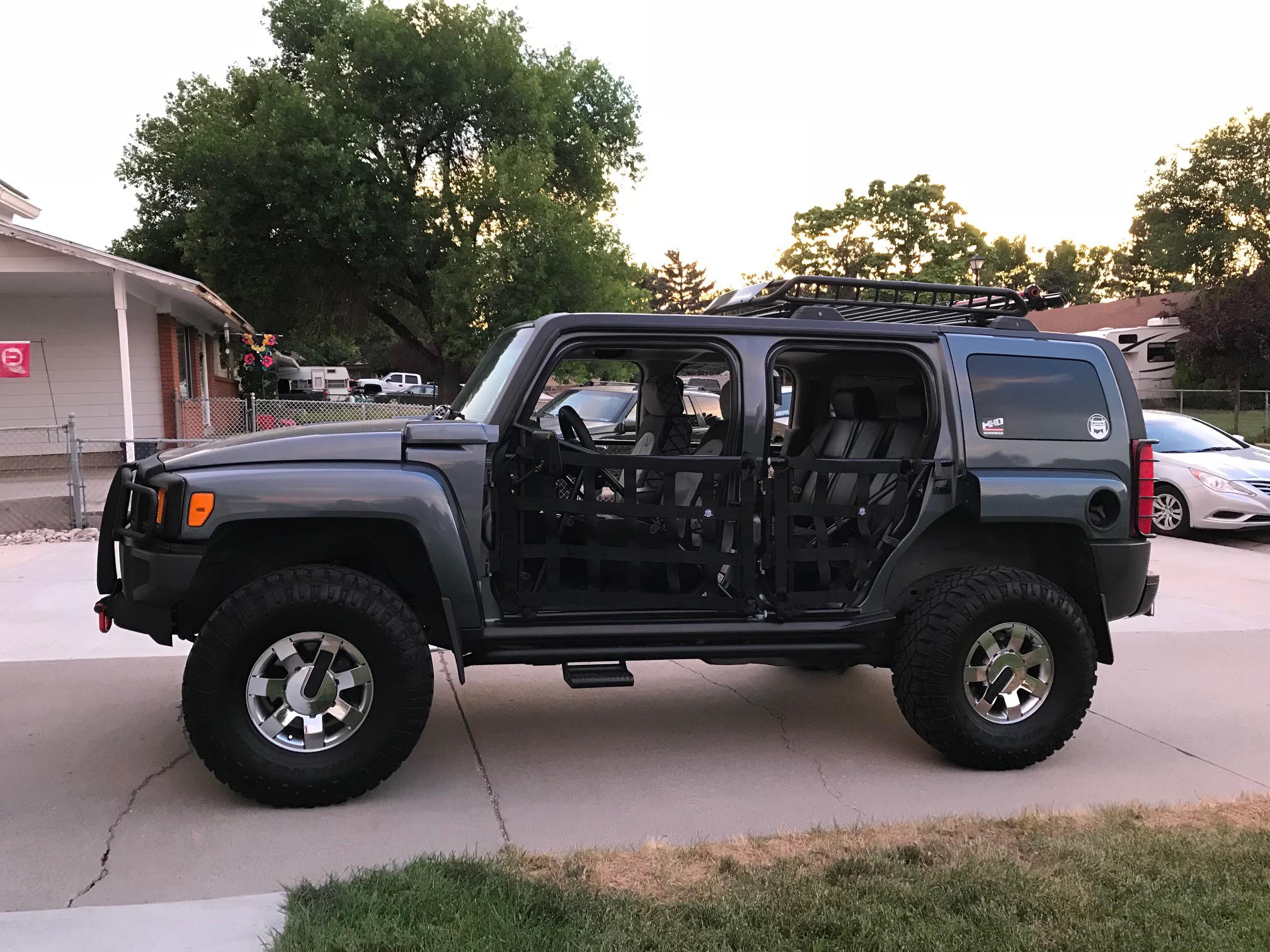

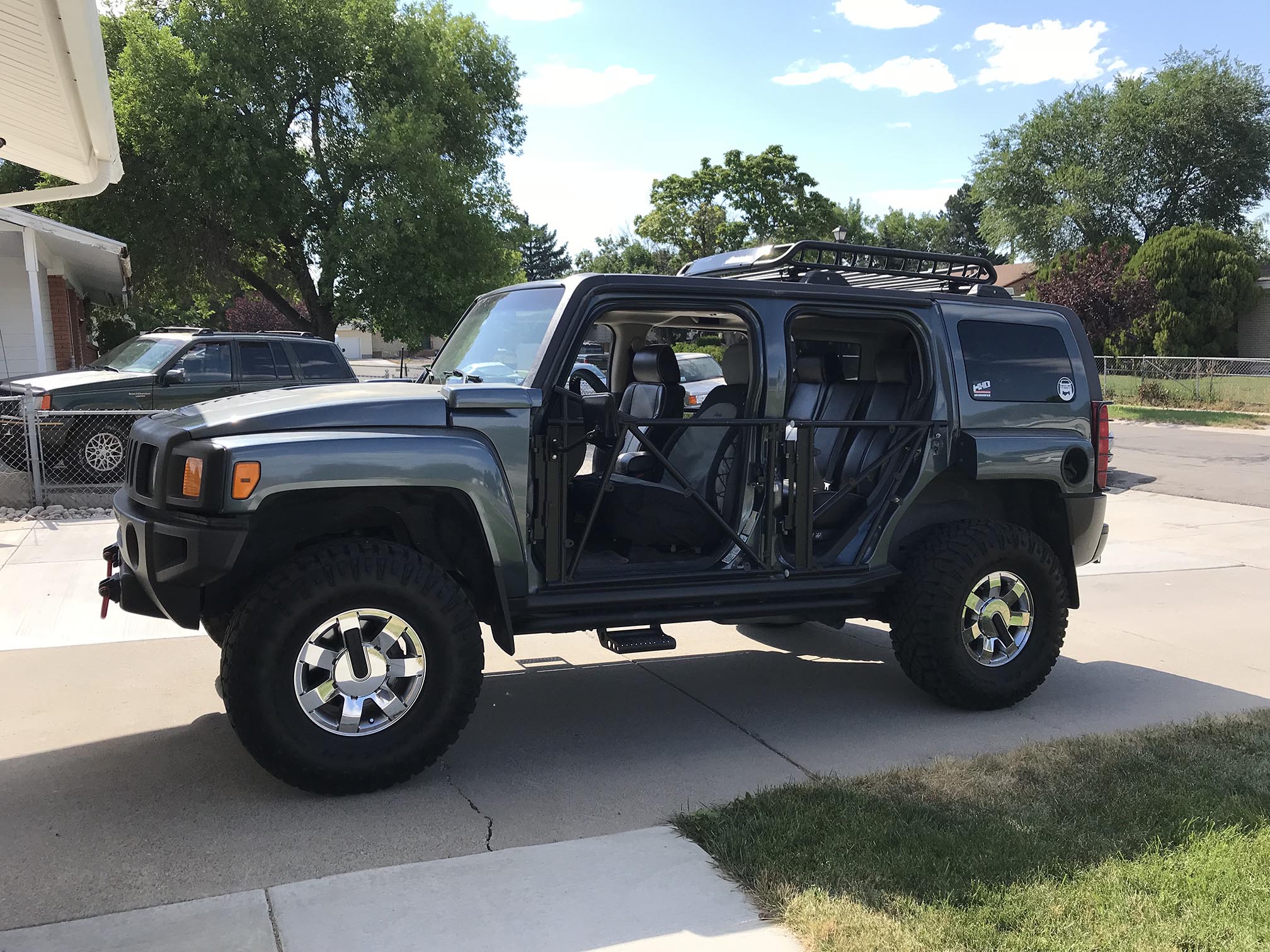

Some tube doors with safari nets. Still needs some work to install the front of the rear fender and also tighten up the nets. Been driving with just the tube doors for a few weeks and been loving it.
Acer4LO
Illinois
Looks good, and I like the photoshop skills ;)
Thanks! It comes in real handy alot espically when I do Concept Renders to help visualize my ideas.
Looking really good! Just throwing out an idea here, but another modification you could do is to add rear door fender flare panels like on the orginal orginal door.
Thanks. The guy I got the tube doors from had two tabs/holes put on it to mount the fenderto but the two are not enough for freeway speeds and the bottom does not sit flush. It's a work in progress but I do plan on being able to mount the fenders eventually.

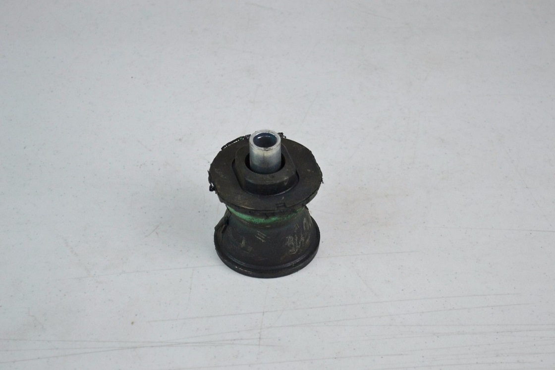

Hello. today i finished replacing ALL bushings in my car to polyurehtane. all works fine. only body bushings left. they are on bad condition.. does anybody know where i can get body bushings of hummer h3 maded from polyurethane ?
Yeah. Chuck a stick of this in a lathe and make whatever thickness you need. The stuff cuts like butta...any shop with a lathe can make em in 45 minutes. If you make em thicker, you’ll need longer body bolts...prolly 14mm.
If you’ve installed the daystar kit with the bolts they provide, I believe you’d have a bit over an inch left if you decide to swap out the mounts with 2”. I know for sure you can get away with 1/2” more.

The body mounts have a sort of D shaped flange to keep them from shifting. Not sure if it would matter if you spun some round ones out on a lathe.
