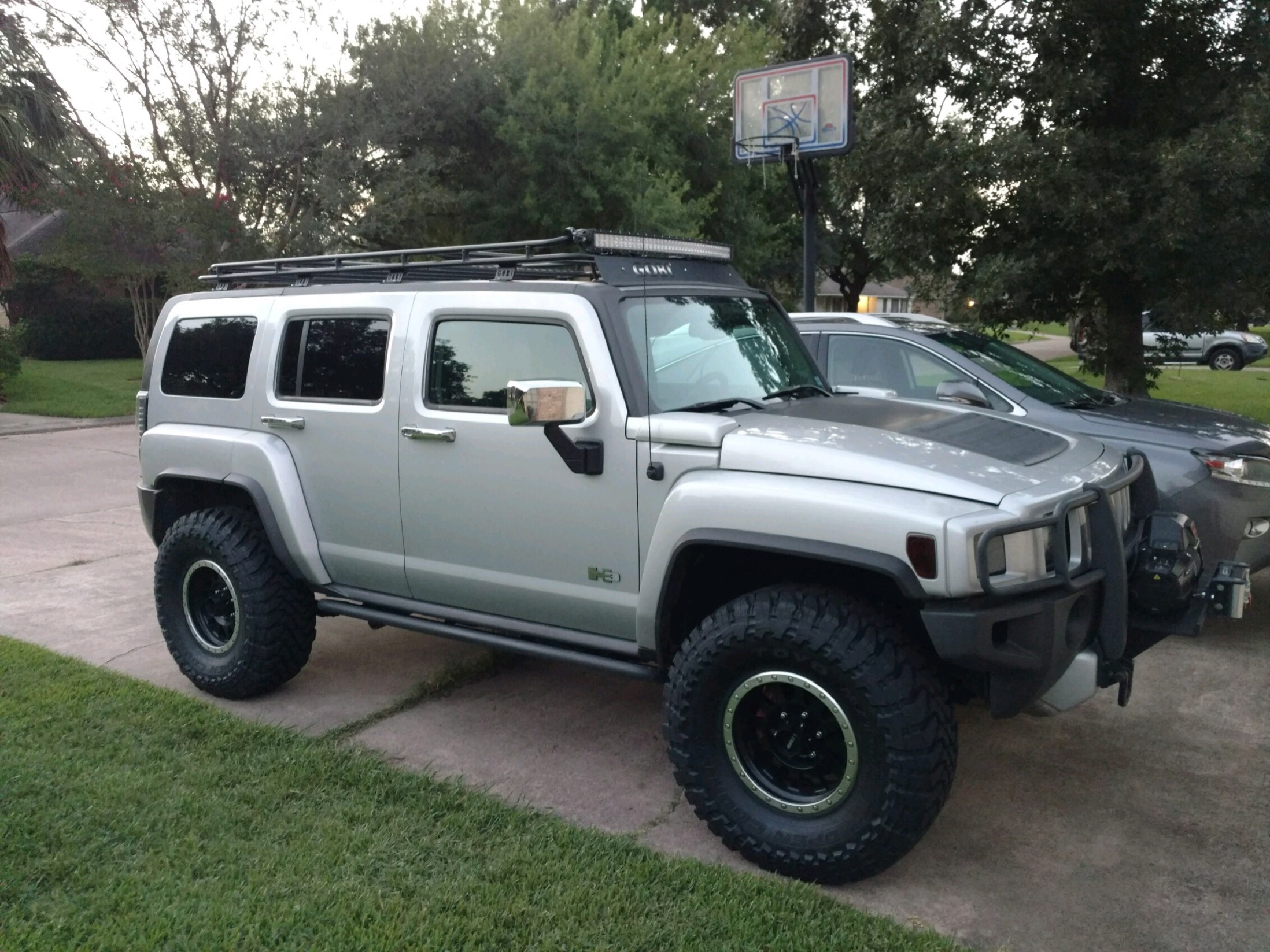

Added few things since I posted last.
1. Snorkel from Amazon(safari knockoff)
2. Front Arb bumper
3. Rear Thor parts rear bumper
4. Led taillights
5. Sprayed bedliner on fenders,side mirrors,handles and grille
