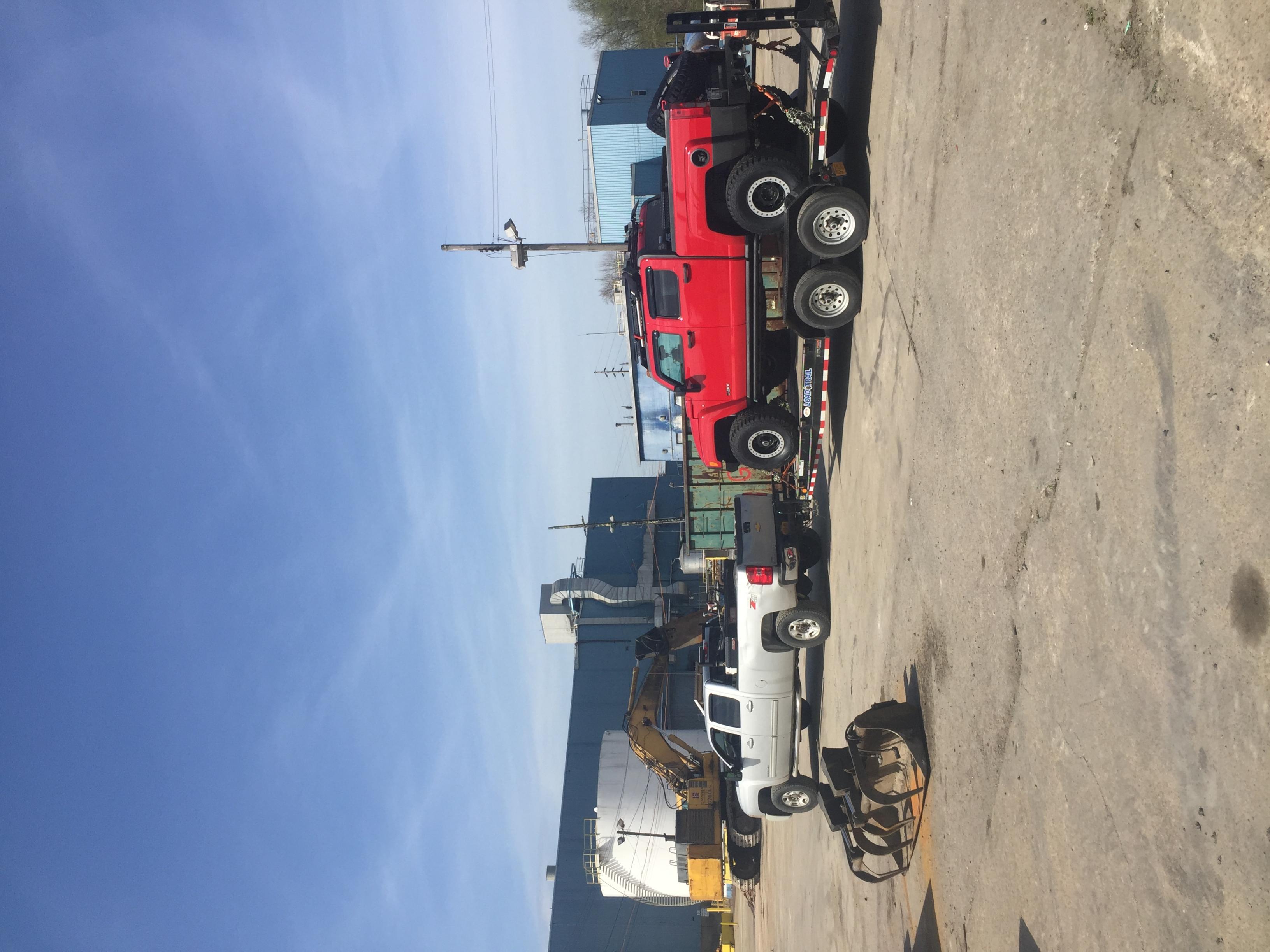

IMG_1258.jpgIMG_1263.jpgChanged wheel bearings, greased big red up, waxed it for the very first time. Now loaded up and heading to Windrock.

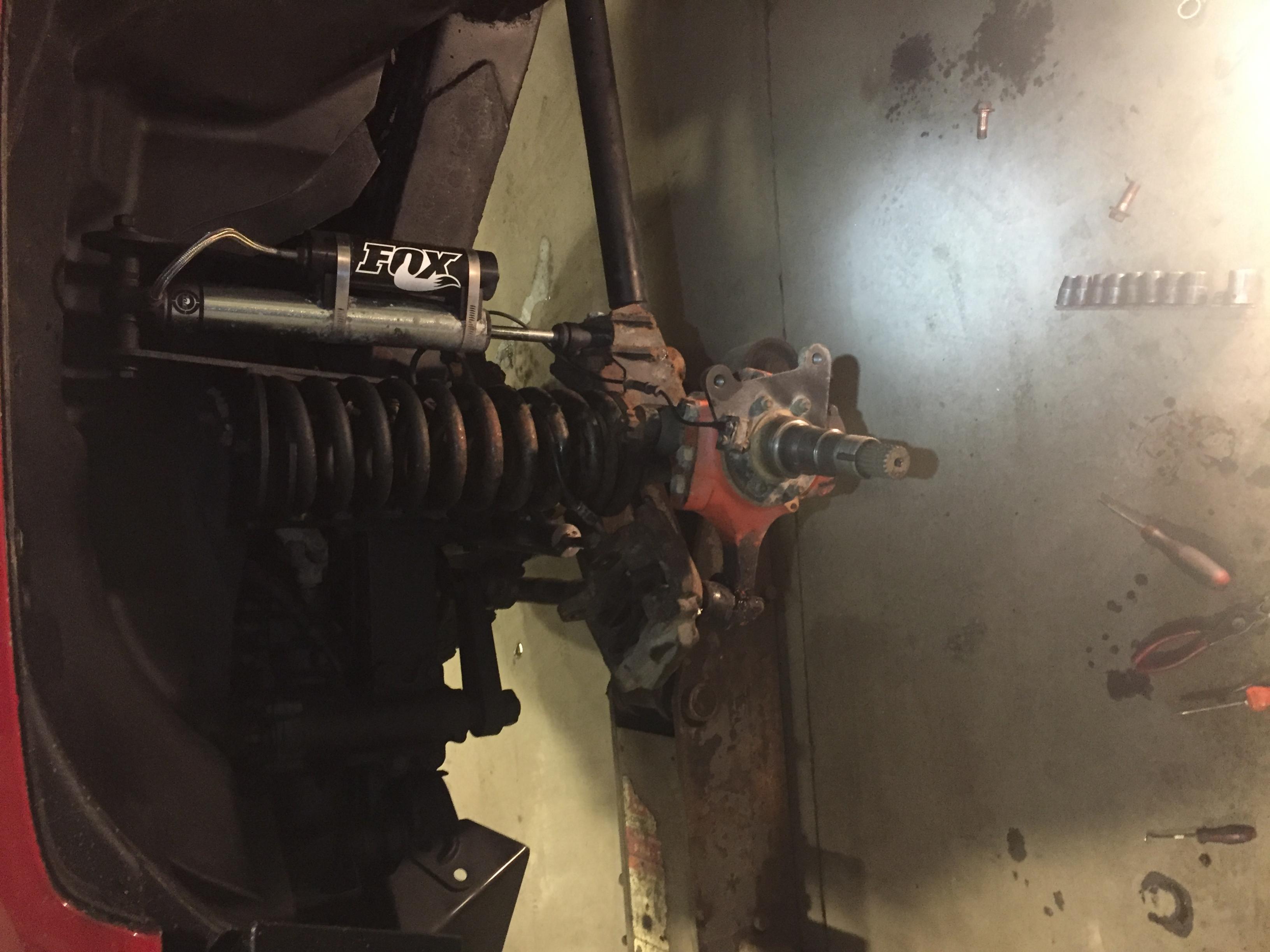

Actually, replacing CVs is pretty straightforward. The hubs would have been easy as well except that mine were seized by rust in the knuckles. I soaked them with PB Blaster and beat the holy crap out of them and they did not move so I removed the knuckles. My buddy has a press in the shop where he works and I took him the knuckles with hubs still in them. He said it gave the press a work out for sure.LOL Amazingly, the dust shields were both intact and I re-installed them with the new hubs. I highly suggest that if you are going to replace the CVs, obviously do both sides and re-torque the new axle nuts TO SPEC. Many shops ( and youtube videos) will use the air impact to tighten the axle nuts. This is a sure-fire way to a premature death of your hubs. Put on your man pants, grab a torque wrench and torque them the correct way to spec. LOL
The next project will be removing and replacing the front diff bushing.
H3 wolf- Just a side note you don't have to remove the hubs to replace the cvs, it's a pita without doing it but mine were also frozen to the knuckle so I did without. Either way was still a simple job

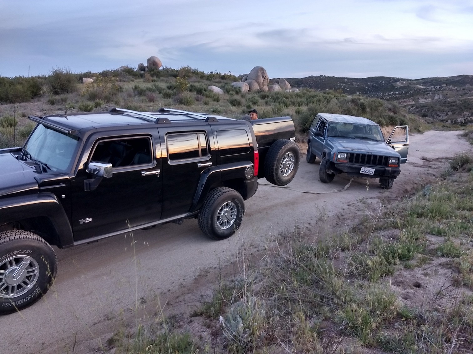

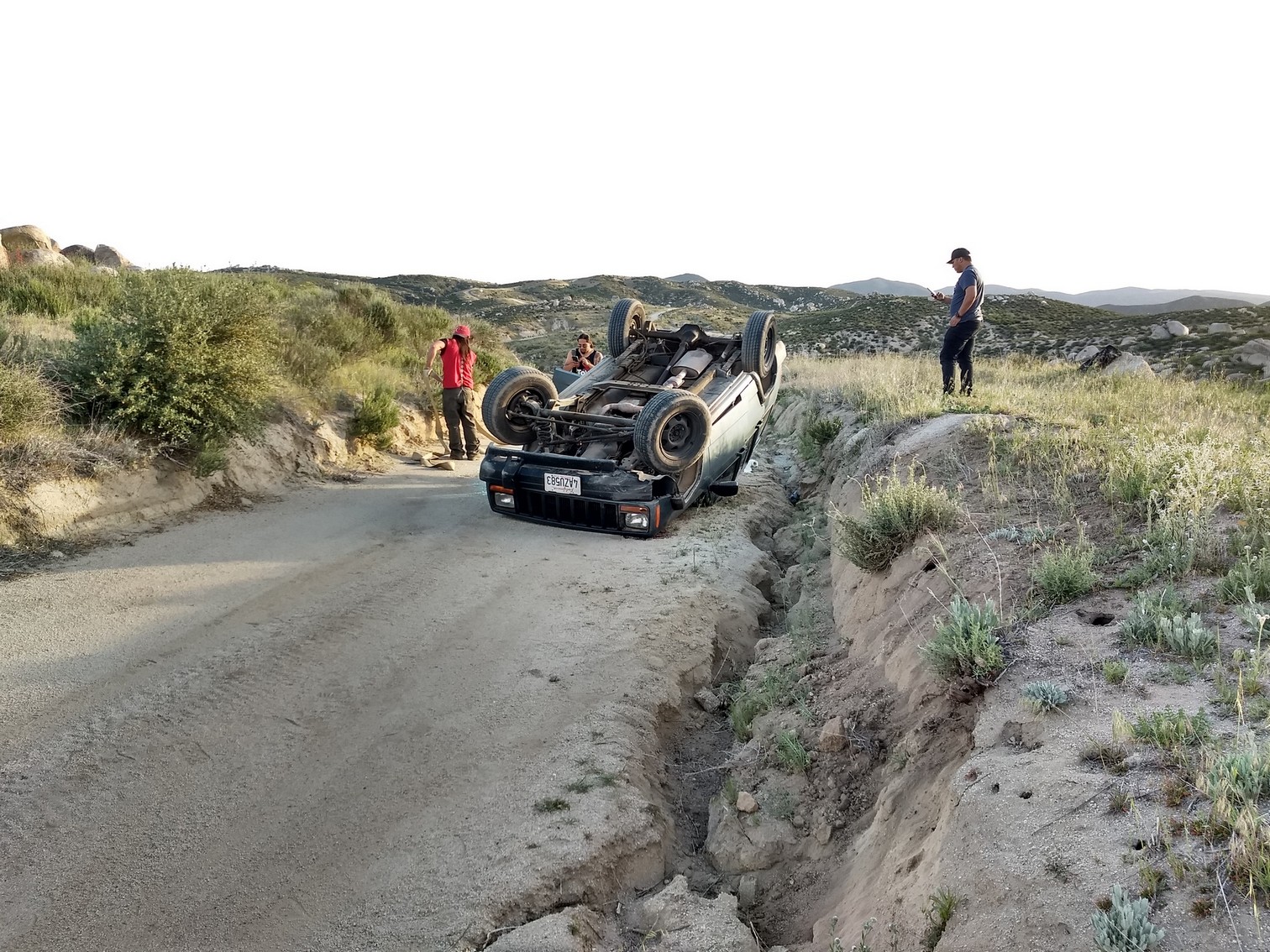

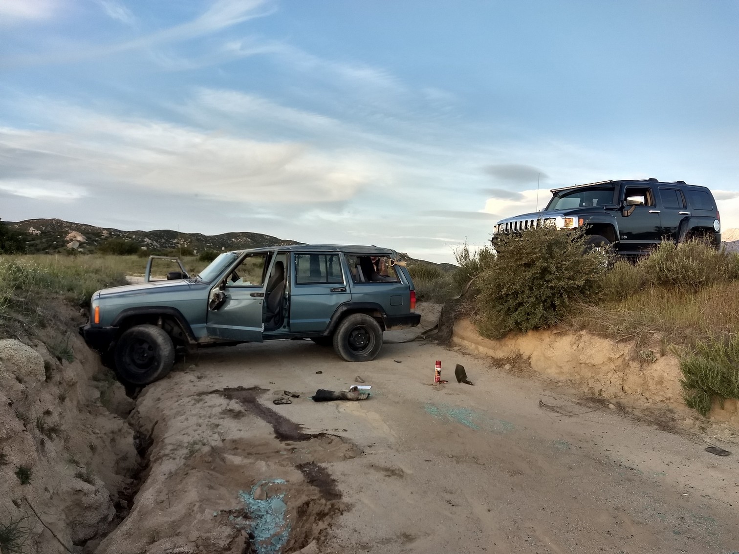

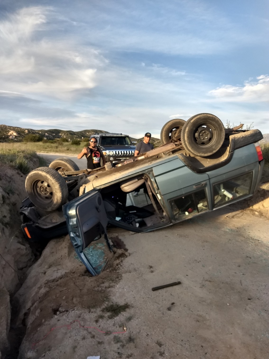

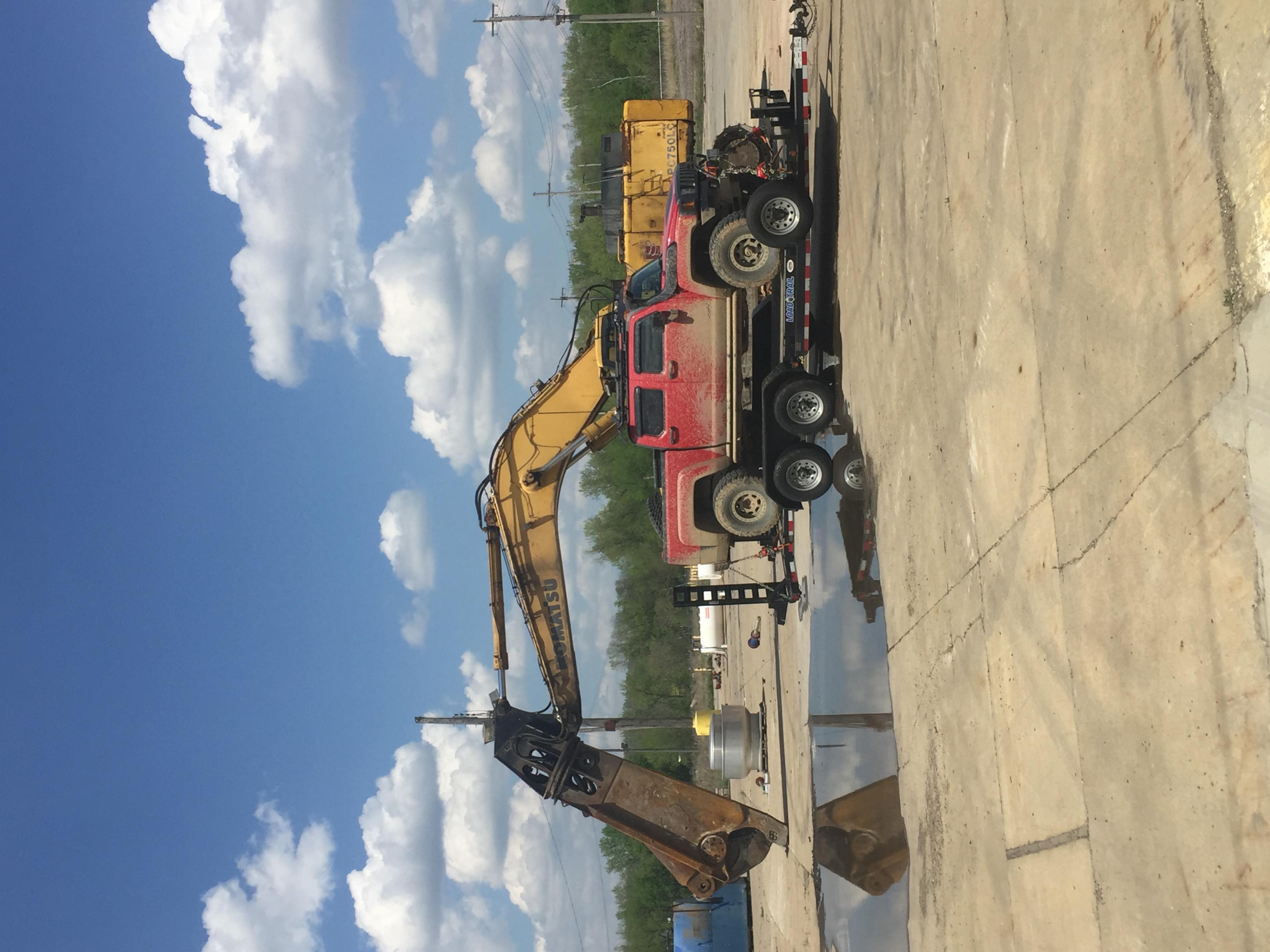

Got a call from a neighbor/family friend that had gone out and rolled their Jeep Cherokee. Had to drag it around, then flip it back onto it's wheels, then get it turned back up the road. Finally, towed it about 5 miles back out to the pavement.:cool:2a.jpg3a.jpg4a.jpg6a.jpg

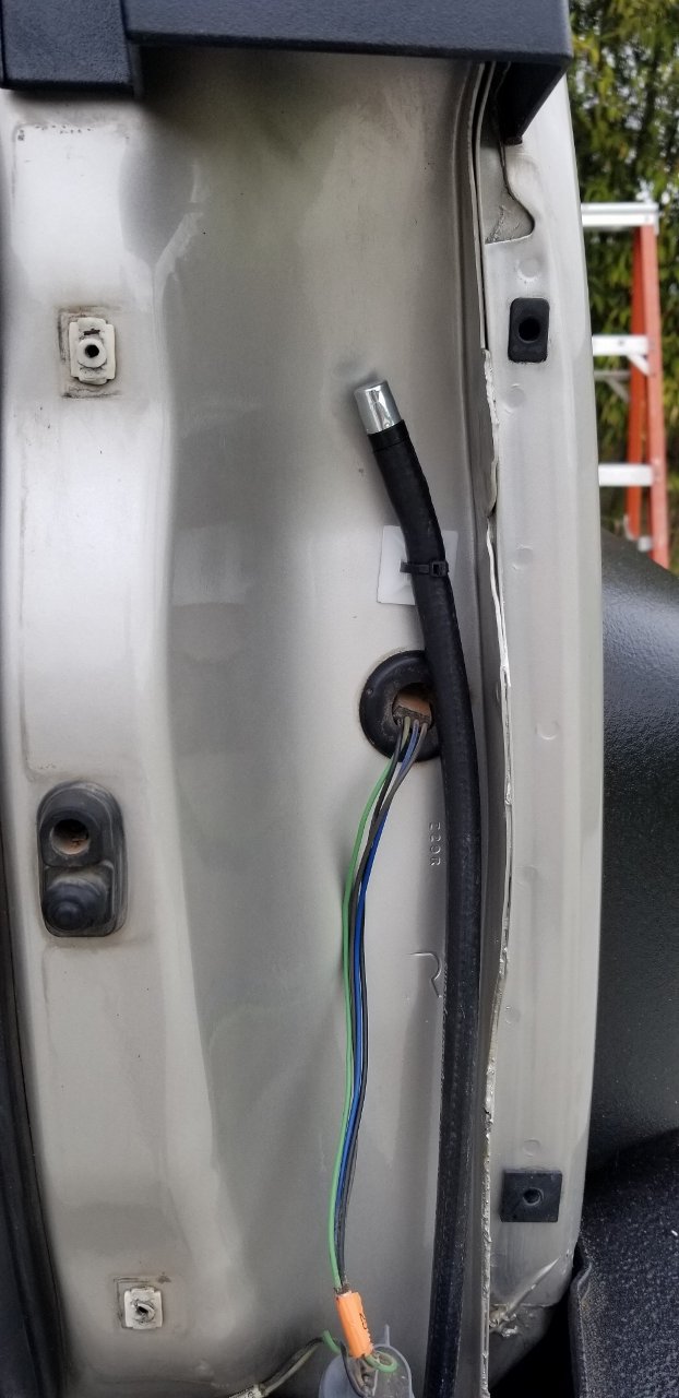

I have several small projects going on now with my 3. I pulled off half the top plastic trim to repaint to match the other side. In doing so I decided the void behind the right rear brake light is a good place to run the rear diff breather. During my last service the breather was plugged solid with mud so this should keep it clean with easy access.
