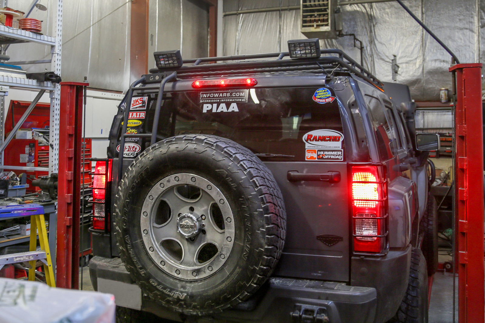

What is the third brake light mod? Mine is not working and I refuse to pay $200 for a replacement
Sent from my SM-G965U1 using Tapatalk
I did this:
http://www.hummer4x4offroad.com/forum/showthread.php?6364-Hummer-H3-Third-Tail-Light-Repair-Mod
Mistake I made was grinding the old components off too hard, left me with a rough surface, but still works, especially since you end up clamping the strips in there. Im sure some led strips are narrower and might fit better, i just used ones from autozone, spliced them together, then spliced them to the wiring harness in the H3. Soldered and heat shrunk all of my connections
Acer4LO
Illinois
Or you could go with a $15 to $20 Light from amazon. Mine already had it when I bought it, but I had the pleasure of wiring it up since the prevoius owner didn't bother.

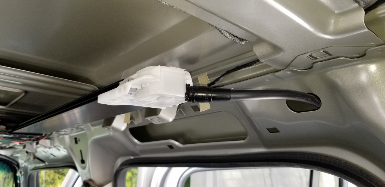

Decided to drop the headliner to do a better fix for the sunroof drains, silicone and zip tie should keep it from leaking. Added a full size USB power plug behind the rearview mirror to power dash cam/trail cam.
Make sure u great the rails and oil the plastic chain with some off road motorcycles chain lube. The moon roof is gonna love u for it...
