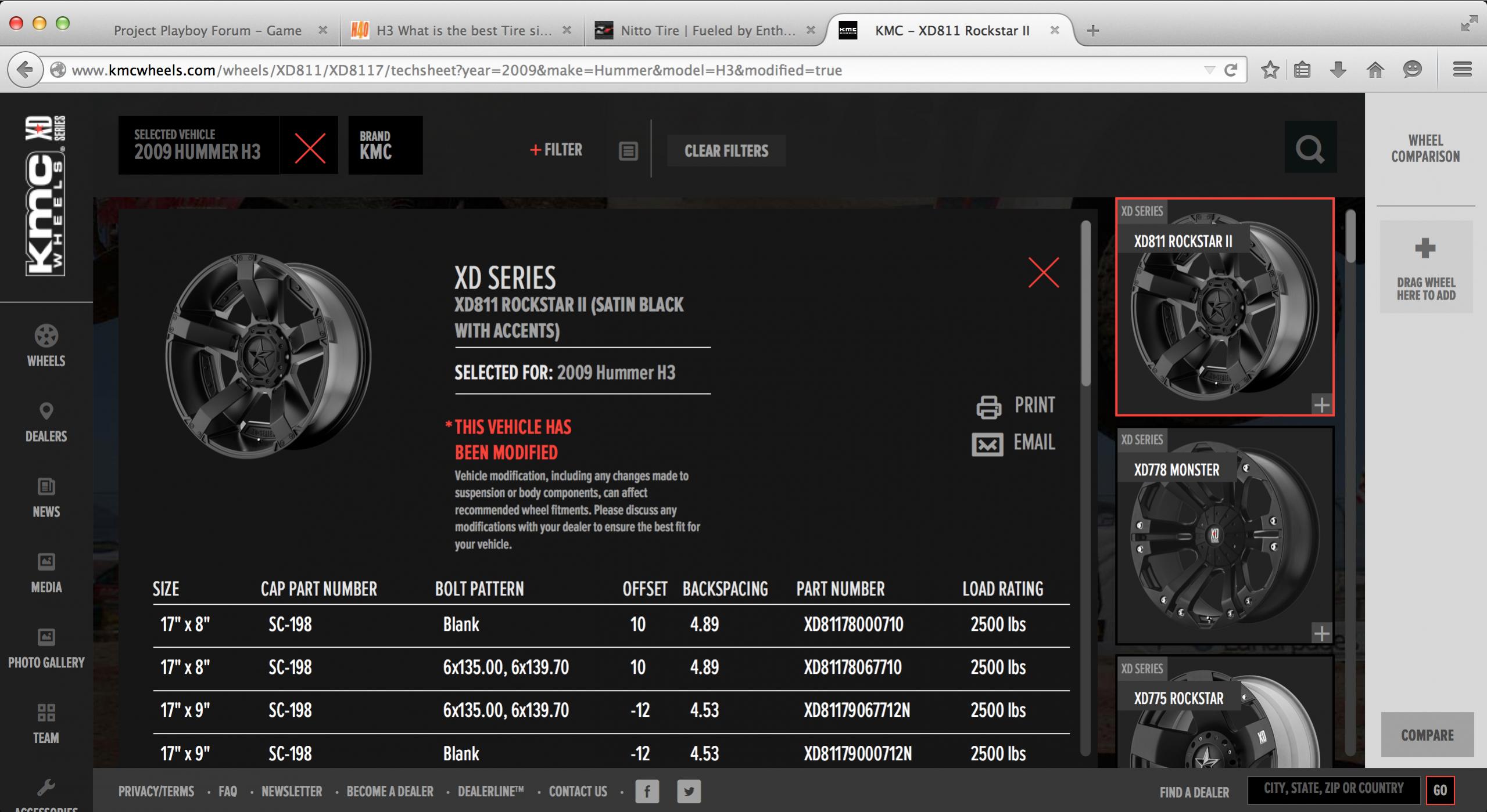

since I'm having trouble understanding all this, will these 17" rims work on my H3, or do I need mods to make it work?
17x9 with 35" tires you will need to rancho lift
17x8 with 35s fit stock H3 (my current setup)
