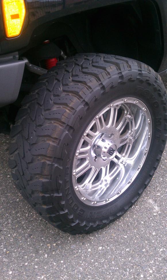

Well am currently running 20' 35 x 12.50, am thinking on going back to stock rims on 33, but I want to be able to ride with u all...
9,503
Your running a rancho lift so your angles on the tie rods and halfshafts are alot nicer then the typical torsion bar cranked H3. I think you can successfully run tough trails without breaking on 35s. It's all in how you wheel. If I never went out with the so cal group back in sept of 2010 I would of been looking for a solid axle conversion. the H3 IFS can withstand tough trails if you learn how to use the IFS. I didn't, I wheeled IFS like a solid axle. Foot down and throttle out. I am slowly learning how to use IFS. One trip out with the so cal guys you will learn sooo much! Btw I will be installing my lift in the driveway or friends shop and I will be using the stock rims. You are more then welcome to stop by and do comparisons with my 3 and yours for rim clearances and such, 16s are tough to clear so i can be the guinea pig. I think I have 2 other guys on here that want to stop by and check it out also. Install will be early january.
9,503
Whats up Chris... My engine is stock what about ur's View attachment 2468
One thing you might want to do if you stay with 35s is to get a PCM tune. The computer is set up for 33s right now so if u tune it to 35s the driveability gets much better, you will probably stay in the right gear more often and have better mpgs with more power too
