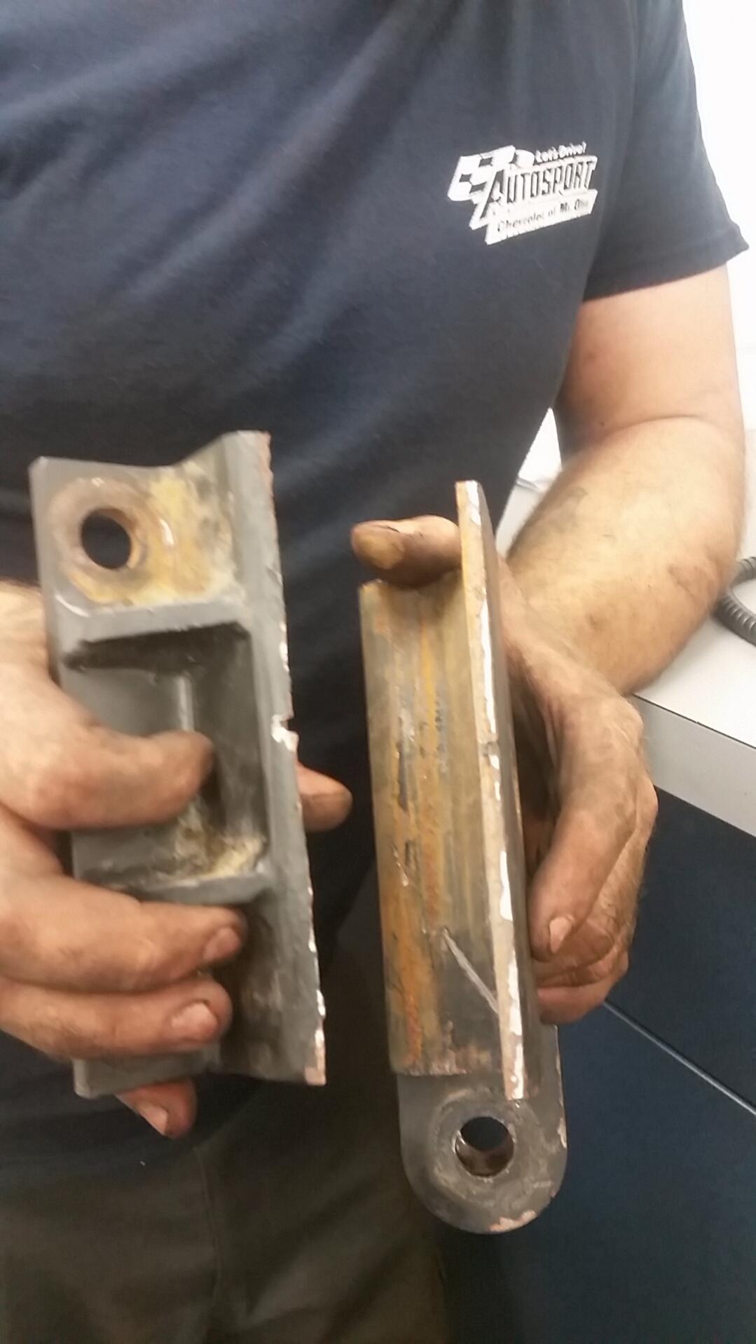

this is my broken plate should be one piece not the case was on the side of the road for hours almost 400 later had a road side weld job was going how do I get a replacement I get no reply 25110.jpg
Wanted to update you guys on what has been going on.
Again, I apologize for my mistake.
Yes, there is welded leaf spring bolt plates out there that I'm calling version 2. I had completely forgotten about that change because I didn't exactly make the change, I just verbally approved it.
Below is Version 3, it will be bent like the original design so that it cannot have the same failure. It also has some minor changes to improve the ease of installation. To make it easier to manufacture, the shock mount is 1/4" lower.
While this decision this isn't final, currently the thought is that there was no penetration resulting in a poor weld which caused failure. Again this isn't final, but this is currently the only reported incident so far.
I plan to replace his High Clearance Leaf Spring Bolt Plates free of charge with the new design. Although I would want to know those particular ones are destroyed somehow because shipping them will cost a ton.
I plan to offer everyone $10 off every part they purchase for the next month with the idea to raise awareness and to check their High Clearance Leaf Spring Bolt Plates.
For anyone that ever has any issues with my parts, know that I will do everything I can to take care of you within reason.
I'm curious when you purchased yours. I have a set of these also but I may take them off and throw them in the recycle bin.

this is my broken plate should be one piece not the case was on the side of the road for hours almost 400 later had a road side weld job was going how do I get a replacement I get no reply View attachment 24012
Schwarttzy should make it right. I bought my pair after the discrepancy was found and received a proper pair. Have you emailed him about your issue?

Erick done well ! i can talk about my case. i send him message about my fail with plates and video. he says - ok. " i can make new ones with no weld". he kept his honest word and sent new plates to me.. now i am waiting for them...
Sorry about the delayed response, always busy it seems. Working on getting a new set shipped out soon.

today i have got parcel from Erick with mounts. so what i see in the box. two mounts.... and nothing more.. no ubolts, no nuts ... mounts painted bad.. no powder paint..
Just check to see if yours is bended or welded. Mine look good. Haven't had a problem yet. I would keep your old spares with you just as a precaution tho.

I would never trust anything that was welded like that. Especially considering how far out you range on your trips.
This is a low budget show... the Old U-Bolts and Nuts will work fine. You put me under pressure to ship it out sooner and the only option I had was to paint it. Regretably, I was told the paint had been drying longer.
ALL of the "High Clearance Leaf Spring Bolt Plates" are Powder Coated. This was a one off to get the parts to the customer sooner.

I have no bad about Erick ! He good guy. I talk him about my problem and he fix it. he sent to me new plates and take no money from me. not for plates, not for shiping. i think he honest man. thank you Erick !

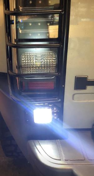

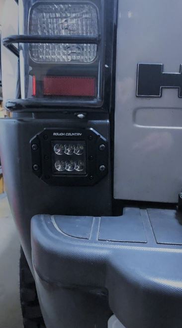

The hardest part was making room for the pod behind the plastic, but the lights themselves are switched with no connection to the reverse lights. I never had the oem roof lights, so a few months ago when they were available on Ebay I bought a couple of OEM light switches to use in the center console of the dash where I just had the two blanks. GM Part #88963885, plus the wiring pig tail GM Part #12101864.
