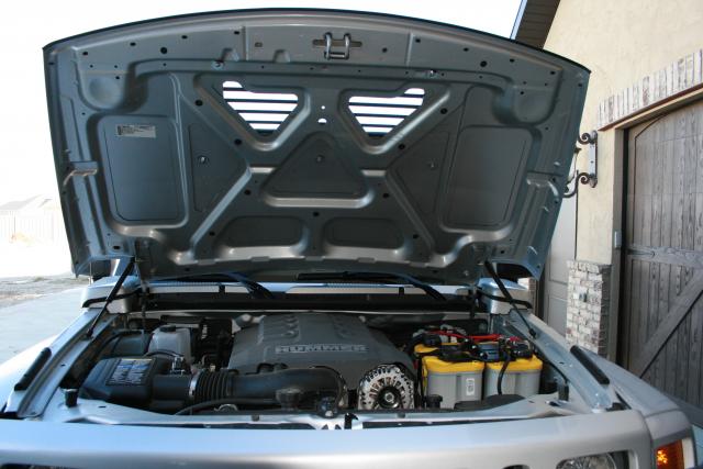

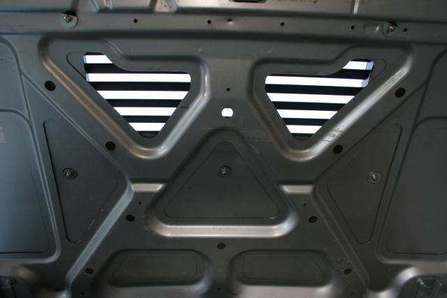

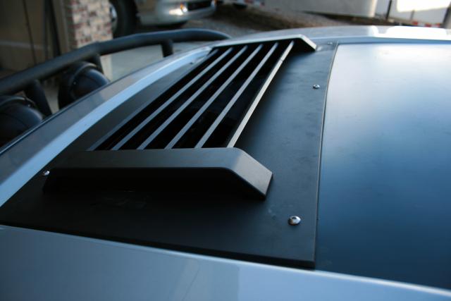

Here is a picture of my RealWheels steel hood louver/overlay from the side and rear:
You'll notice that, unlike the stock louver, it is ridged and spaced, exposing some of the hood beneath it. The hood below is not normally noticable because from the front, side and top, it looks like one solid piece. Only the flash clears away the shadow enough to notice it here.
So, my curious mind reflected on the HMMWVs that I've been around and how their hood louver functions with the thick screen that allows the vehicle to breathe even under extreme conditions. Why could this same setup not be done with my louver on my H3? It would require cutting through the hood and placing in one or more screens which would then be covered by the hood louver. That would allow more airflow to the engine, but water access as well from rain/snow/ice. The screens would be protected from large debris by the louver since the spaces are small between the louver's fins. Thoughts???

Will it allow more airflow, yes. Will it help with a hot radiator? Try and keep detailed records to let us know.
However, it might cause problem with an I5 engine and rain falling directly on the head and into the plug/coil wells. There has already been a bulletin about rain in cylinder 1's plug well. So, not sure how this will affect that area.

Since my louver is already bolted down, and with leaving the hood supports as they are, I don't think that the hood would be weakened. I have an Alpha, so I don't think water will be an issue either. I'll look again tomorrow with better light to see where the water would come in. Great points about painting. I plan on keeping this rig for as long as I can keep it running; there is no possibility of trading it in for me. I need to find some good wire screens for this, but I think that I'm going to give it a try.
