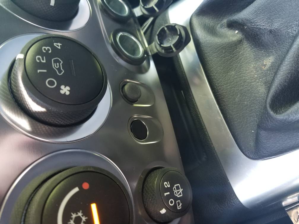

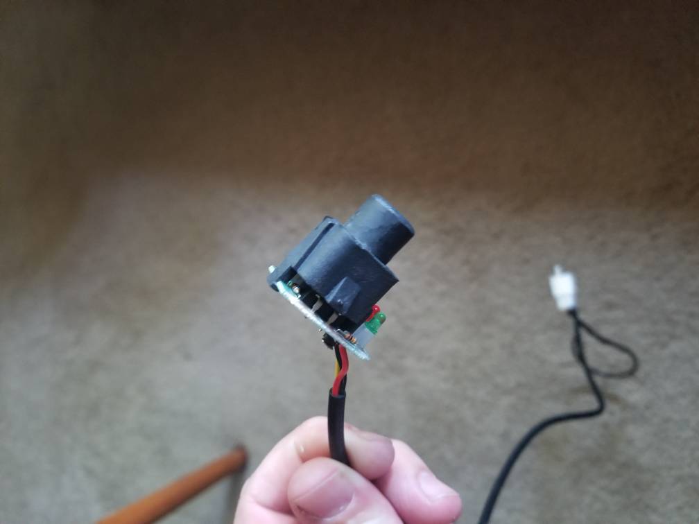

Designed a switch to control my led light bar in the grill, wanted a switch that would go in place of the stock dummy plugs for the off road lights.
Used a universal push button switch that comes with most light bars.
Designed and 3d printed a new button and housing. 20180607_181645.jpeg20180607_183849.jpeg

Other button is planned for a door opener with a momentary switch. Waiting on the switch to arrive.

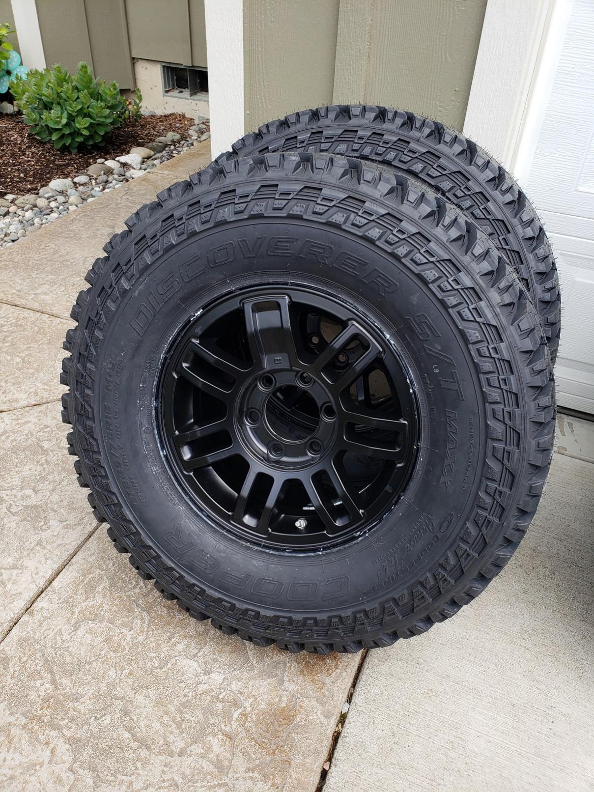

Picked up the wheels from powdercoating and had the tires mounted. I left off having the 5th one coated since it's under the truck and gets chewed up anyway. Removing the lift next weekend, just waiting on the steering rack kit from Outfitter Design.

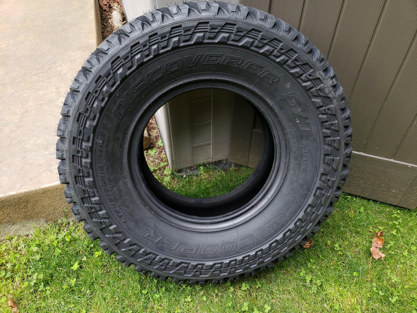

The ST Maxx get great reviews all round. They wear nicely, and weigh considerably less than the rest.
I used to be able to find them in 37s on 16" rims online, can't seem to find them now.
I really like the way the stock wheels look and don't want to settle for 90LB+ tires.
Also. very excited about this

If you find them again in a 37 for 16 rim please post a link I need to order 10 of them asap thanks!

I think they will be a good compromise and remove 30lbs per corner in unsprung weight from running 35's on 20" wheels to 33's on oem wheels. The Rancho knuckles don't leave a lot of tire choices if you want to air down unless you want to run a ridiculous offset. As it is-12 offset sticks out too much, for me, even with a 11.5" width tire and only leaves a half inch between the sidewall and knuckle. I don't know why Rancho couldn't have turned the bolt on the upper knuckle 90 degrees.
I'm more of a function over form type, I like the current look of it but I know it handles better and is more surefooted sans lift and the required higher offset wheels.

Well, between the wheels and tires your increasing the track width about 6 inches which affects the steering, and how the rig handles overall which I don't like. The heavier wheel and tire combo drastically decreases braking, the minimum required offset for wheels results in your tires slinging crap all over the side of the truck which would be fine if it didn't include the door handle. :)
Some people say it rides like a cadillac with the Rancho lift which is simply untrue. It rides like a lifted truck. I have a stock adv sitting in my driveway next to mine for the week, I know which one rides better. Most of my offroading is longer drives to and from fishing or hunting places so taking it down a notch to just leveled on 33's works for me.
Can you elaborate on this? Does the Rancho lift make it feel top heavy because it raises the center of gravity?
