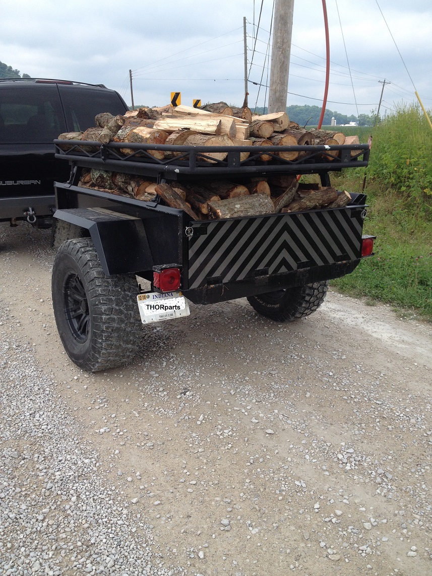

Yep. The BA is the best rack for the H3...period. Aluminum! I got one on my trailer...
