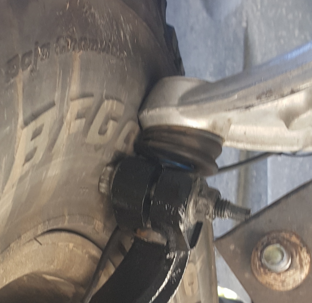

Why didn't any you tell me that rims with 4.5" backspacing won't work with a Rancho? Just finished my Rancho install today and found out my tires barely rub the UCA bolt. Using some big washers as test spacers, I will need 1/2" spacers to clear. Pissed but glad I'm almost done.

Running 16" x 8 with 35" BFG AT's. 17" wouldn't do much either, the wheel cannot be turned when bolted up, too much tire biting the bolt. Will post a pic in the morning, beer and football time now. Looking at spacers on Amazon now for a temp fix.

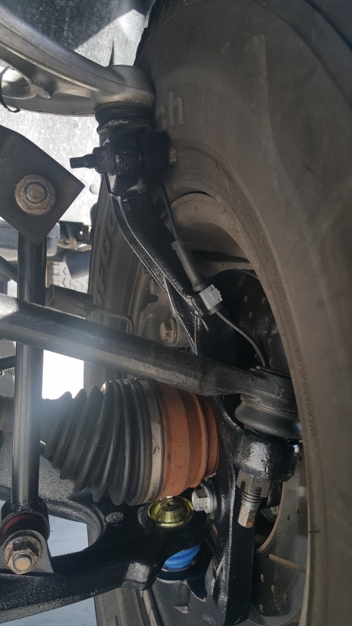

Noticed in your picture that your new ball joints do not have a zero fitting on top. I put 90 degree zero on mine to make them greasable.

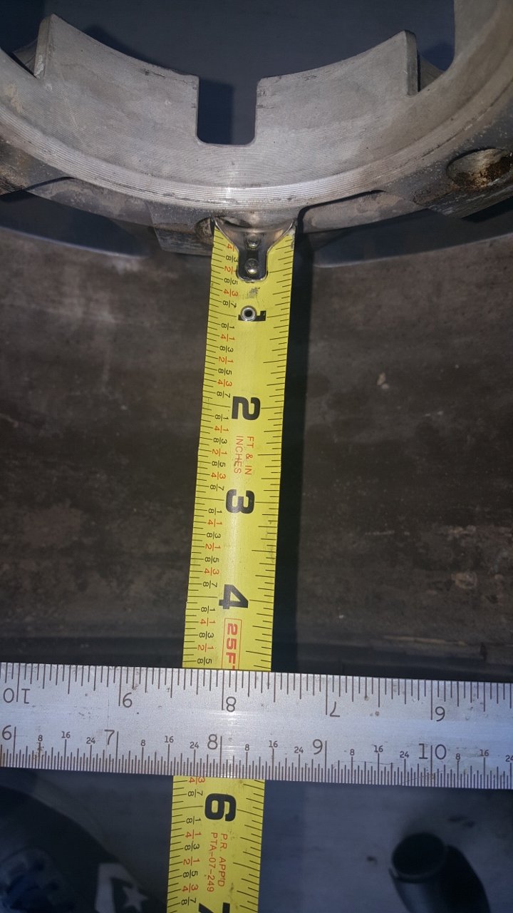

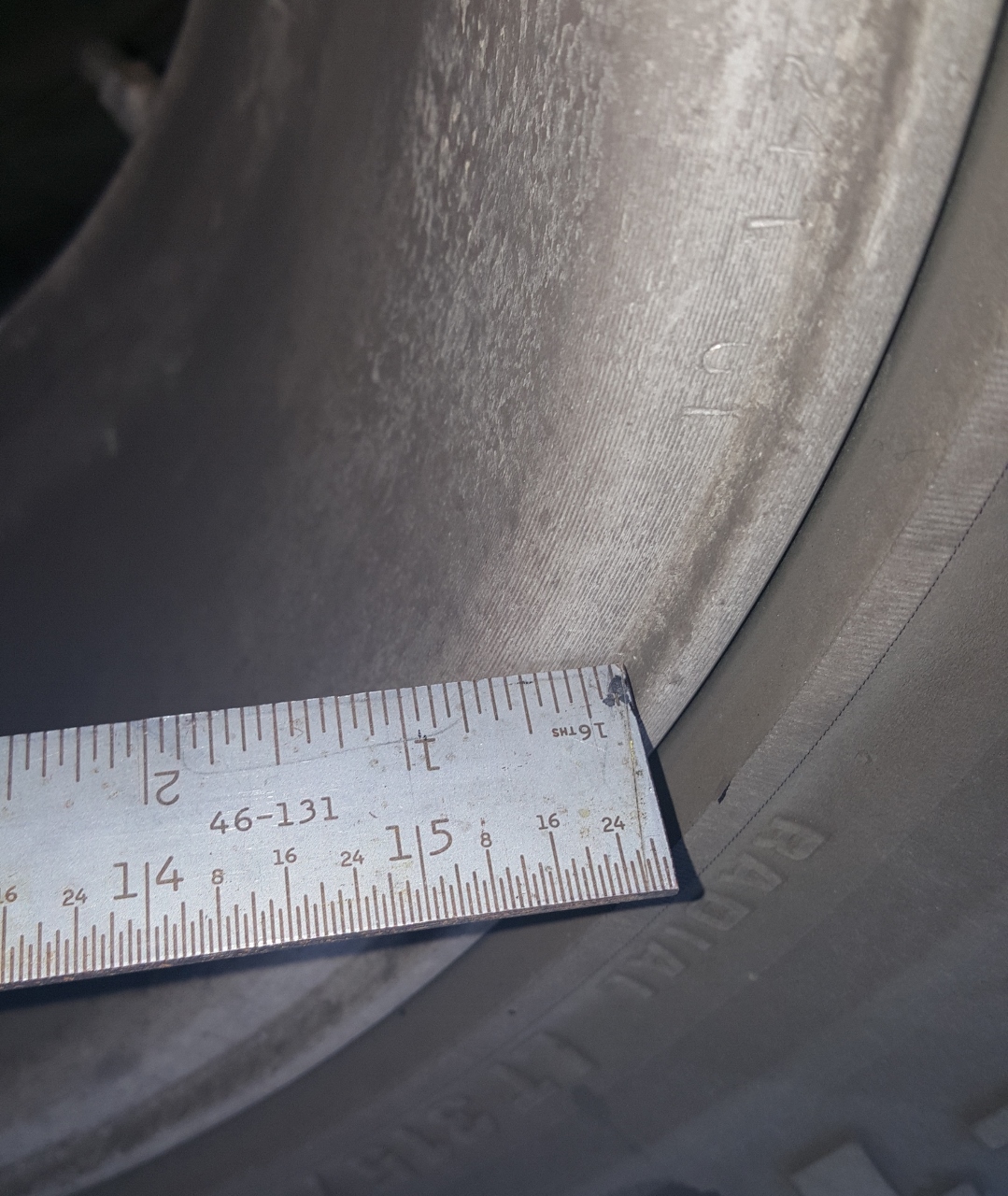

So I double checked the measurements and I'm still scratching my head. My 4.5" BS rubs.
