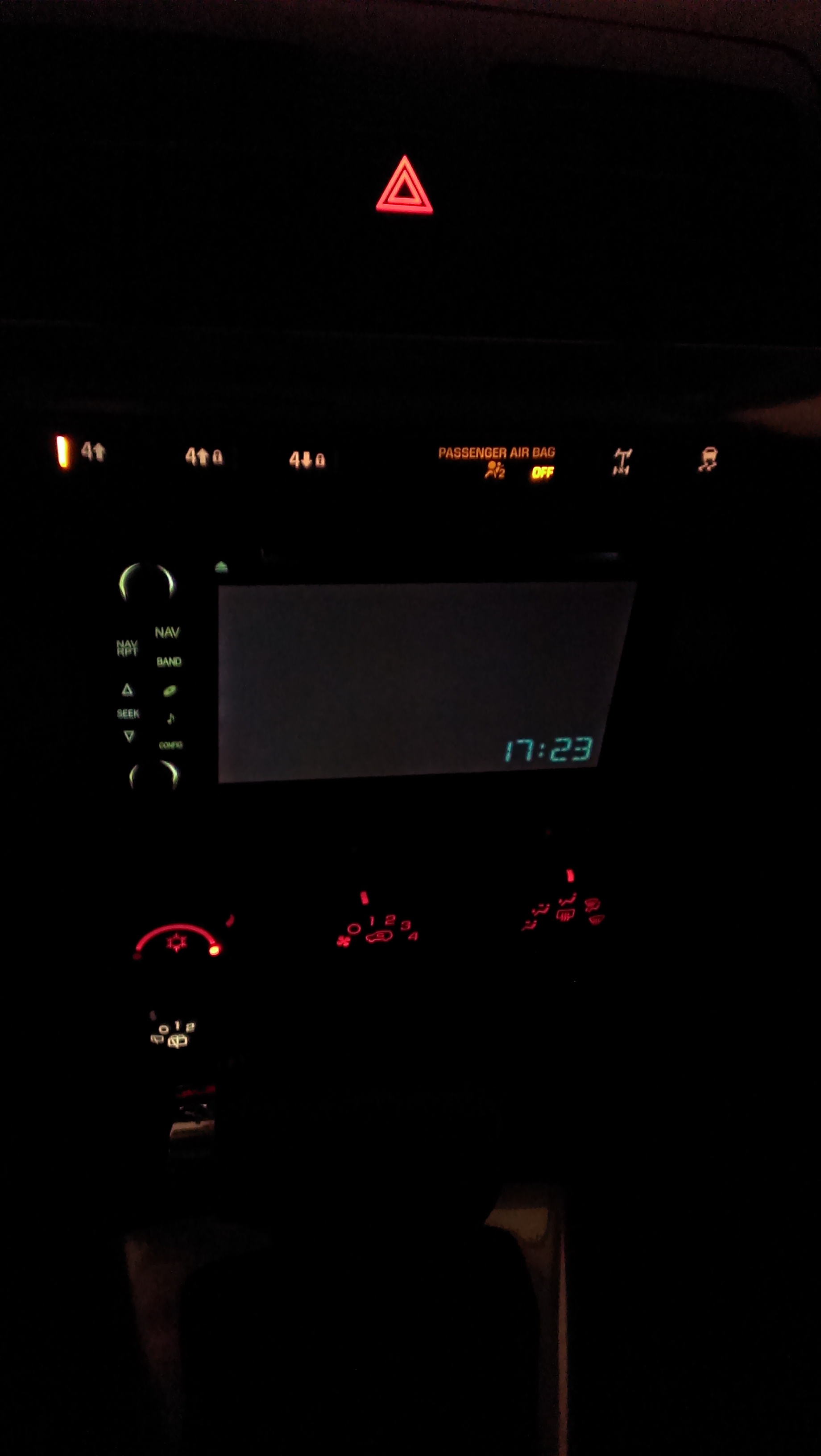

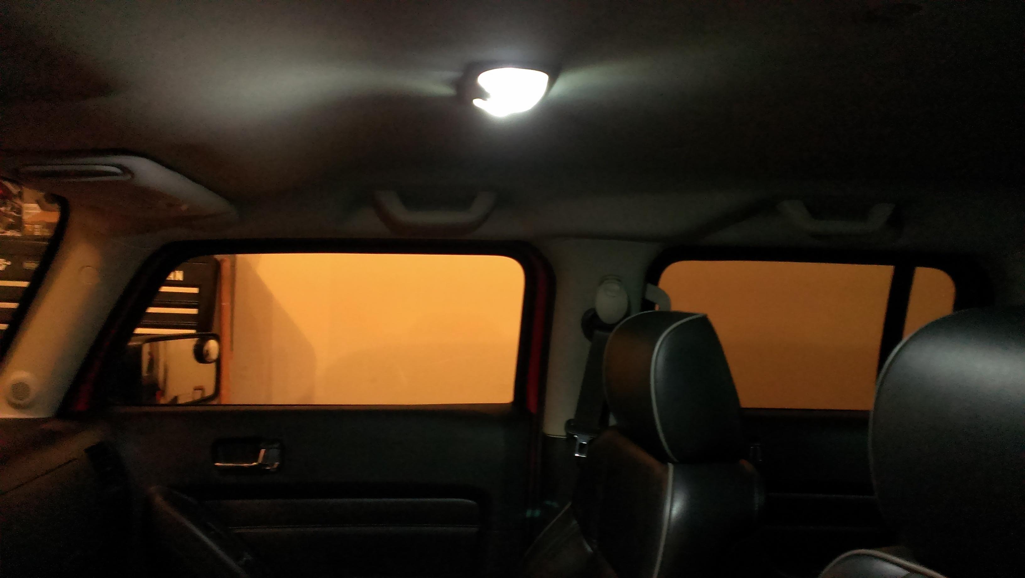

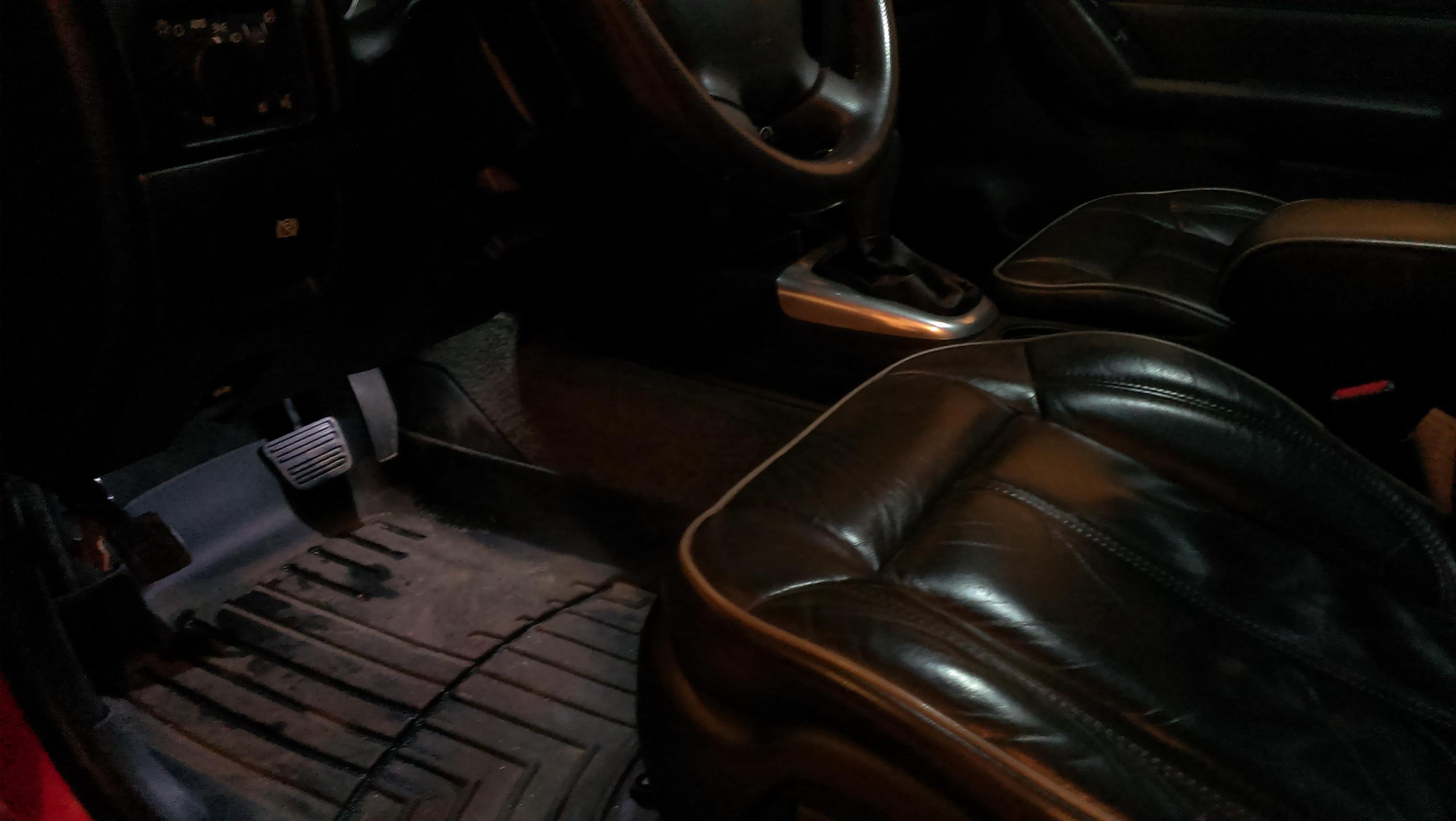

installed some led lighting for the map, courtesy lights, and red led for the temp controls. Does anyone know how to get to the light on the rear wiper knob? Also, are the arm rests the same bulb?
I ripped the door handle off my rear driver side door because I thought it was just slightly frozen in place, but it turned out that the rest of the doors didn't unlock when I used my keyfob. Irritatingly, this happens more often than it should. I think you have to give it a couple seconds between button pushes for it to register unlocking the passenger doors. POS.
