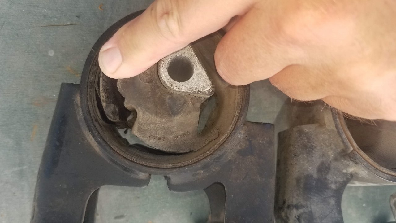

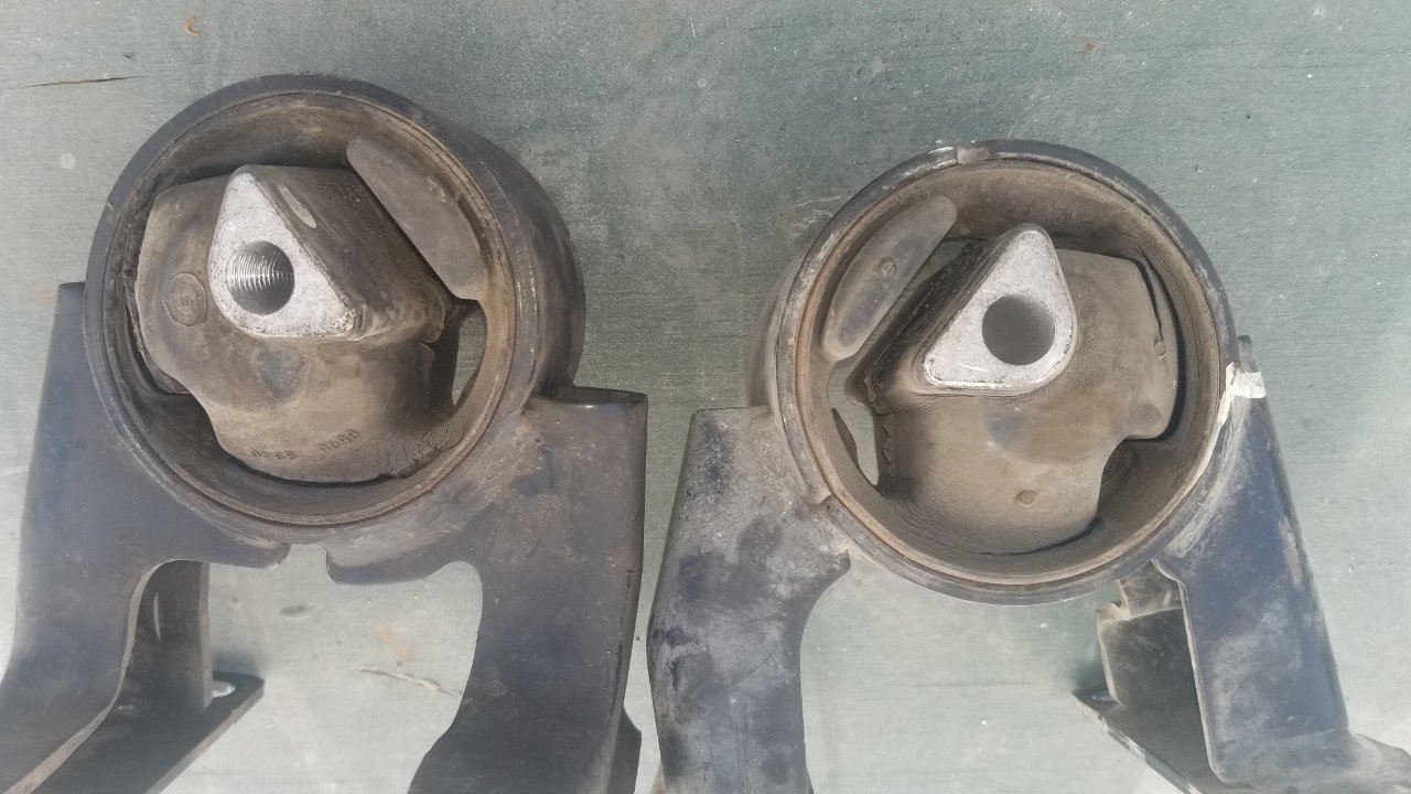

With the help of a great mechanic friend we replaced steering rack, power steering pump, idler pulley, tensioner pulley, both motor mounts ( bad shape), and both CV's. All were not too much of a PITA but it's always easier with a master mechanic. The motor mounts while inplace didn't look bad but a preemptive decision was a wise one. Both were bad, couldn't see the tears until after they were removed. If you have an I5 with over 100k you should consider replacing the motor mounts, vibrations are reduced a lot.

Did you use an engine hoist to support the motor when replacing the engine mounts? How did you end up supporting the engine?

Yeah that’s a good question, some cars it’s easy to prop the motor up, high clearance 4x4’s maybe not so easy.
