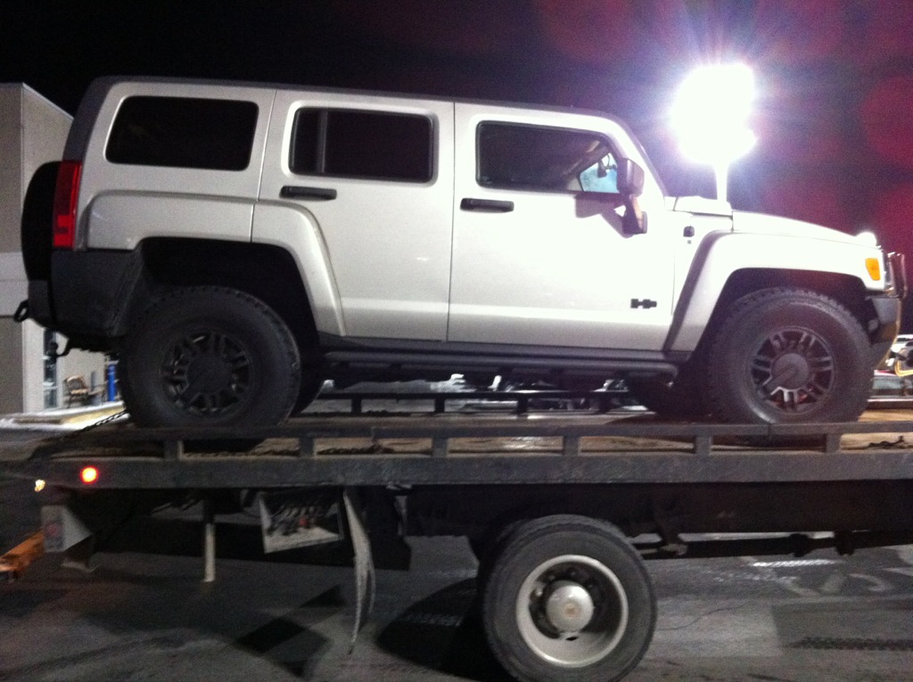

My night... I think a conversation with the service manager is order.. That
$1k head replacement just got cheaper in my opinion. ( and yes my t-bars are cranked he has his winch pulling me down) he was however pretty impressed with all my recovery gear as it helped get me up on the flag bed
