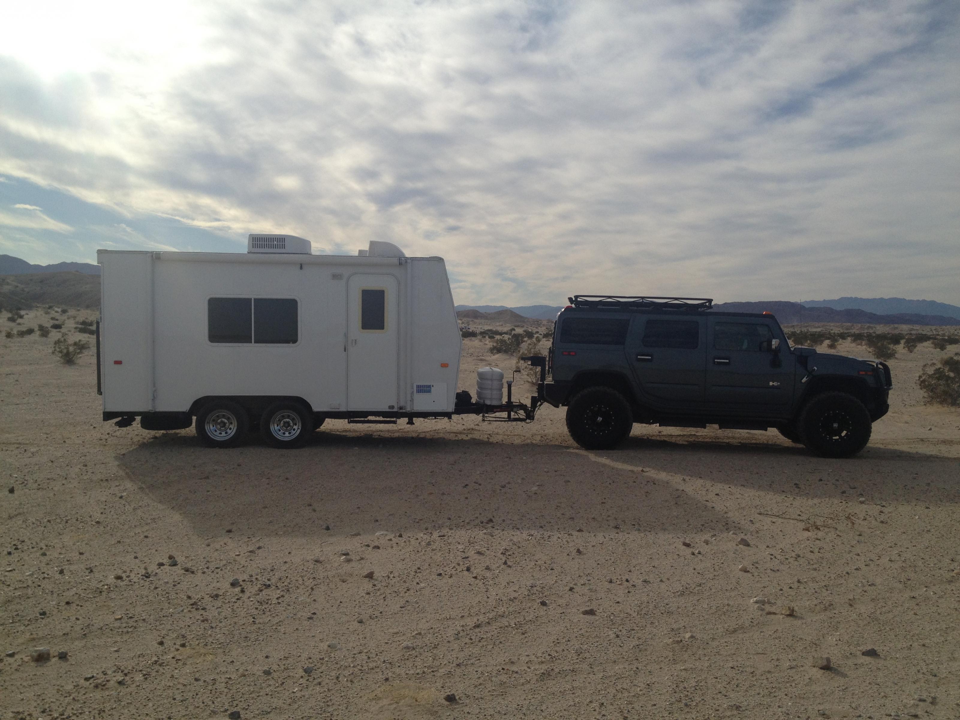

I tow my toy hauler which all loaded up is easily pushing 6500-7000 lbs. I have 37's and no gearing and it tows it just fine. It even does pretty good on hills. I use the tow haul button when its really loaded up but if I'm not carrying that much stuff I dont use it.

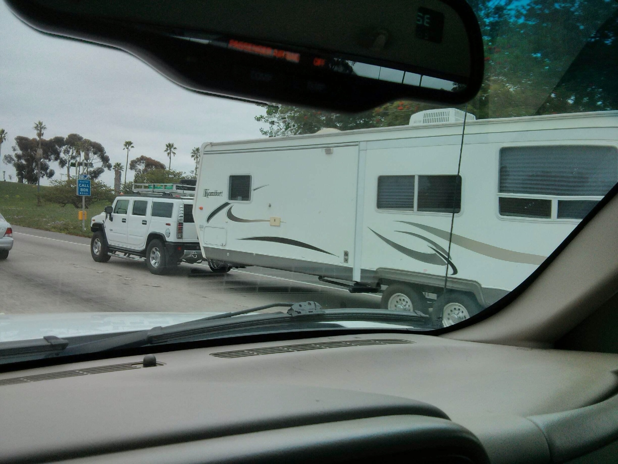

My friend sent me this pic awhile ago, I think it's safe to say this guy is towing more than he should be.
