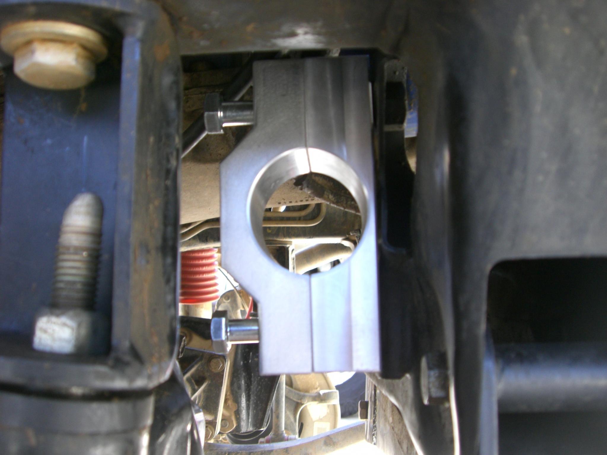

There seems to be some confusion/miss communication regarding the "360 degree" comment made by the OP.
DISCLAIMER: The following info is correct for my product, I am pretty sure it is correct for the outfitter kit, and I think it is correct for PCF.
The mounting bracket that is welded to the frame is reused, the stock rubber bushing and metal "u" strap are discarded and replaced with a two piece clamp that fully circles the rack. To the best of my knowledge none of the options require replacement or modification to the mounting bracket that is welded to the frame or reuse of any other stock component of the pass side rack mount.
Here is a pic of a clamp that is loosely installed without the rack that might help clear things up for people that have not had one of these apart.CIMG3008.jpg

Yes, I confused the matter with my wording. I attempted to correct that with the post below. Sorry if my clarification was no clearer.
I made a kind of confusing comment with the "360 degree clamping...". What I actually meant was that any design needs to have the piece on the back side (against the crossmember). Just replacing the strap with a machined piece won't cut it in my opinion. I may hold out a little longer just to see what the PCF pricing is going to be. Like I said in the initial post, both look like solid designs. Price will likely end up being the deciding factor for me.
