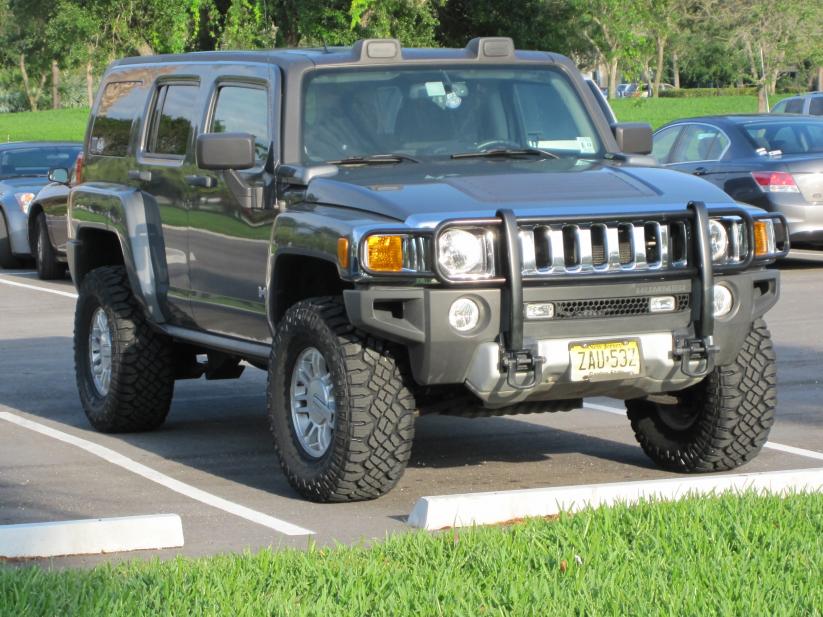

Take a look at the duratracs in 305, thats what I have and I have no complaints at all, little to no road noise, and they handle great in mud, snow, and rocks. I have a about 10k on them so far and they still look brand new IMG_0758.jpg
