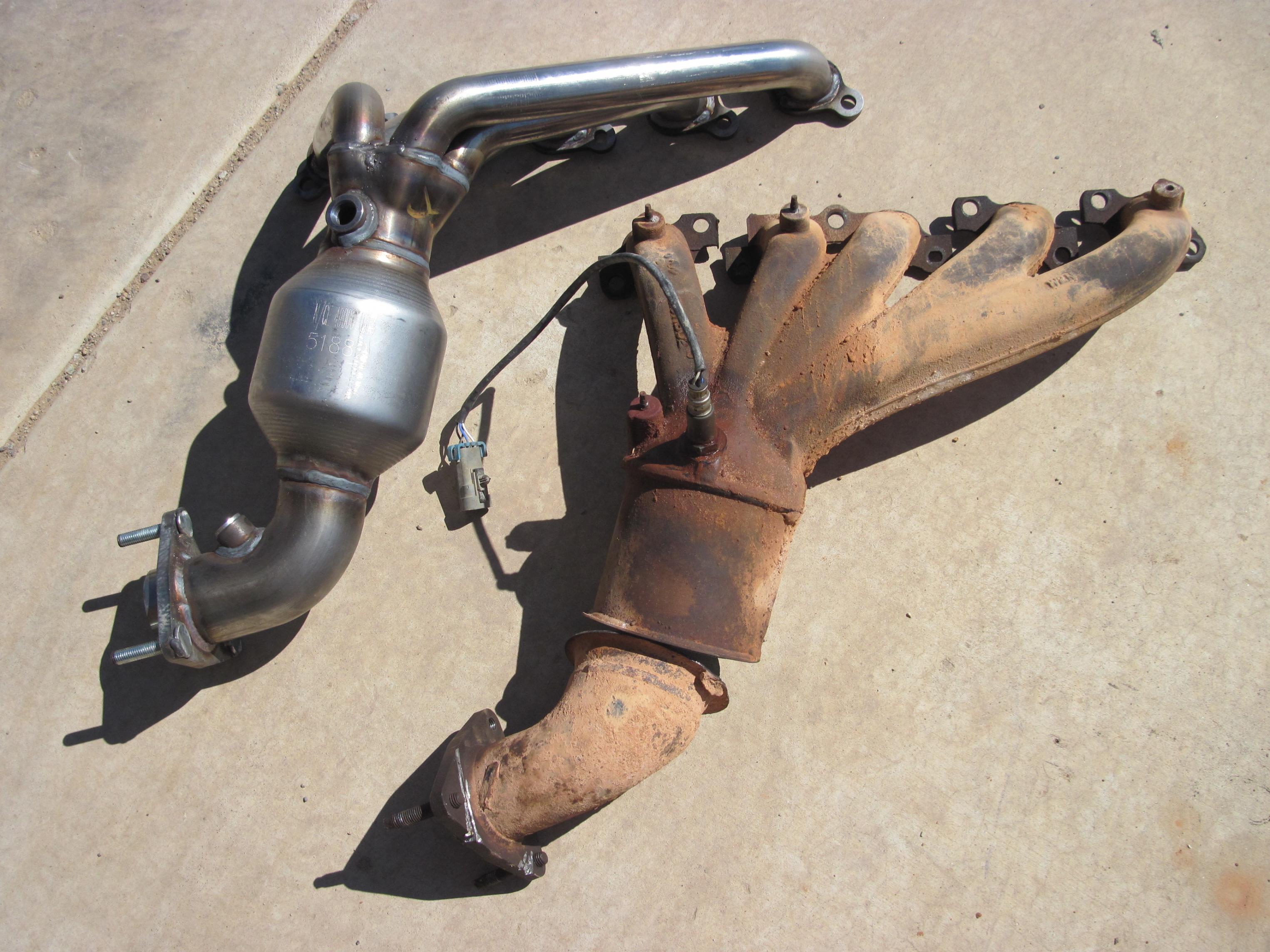

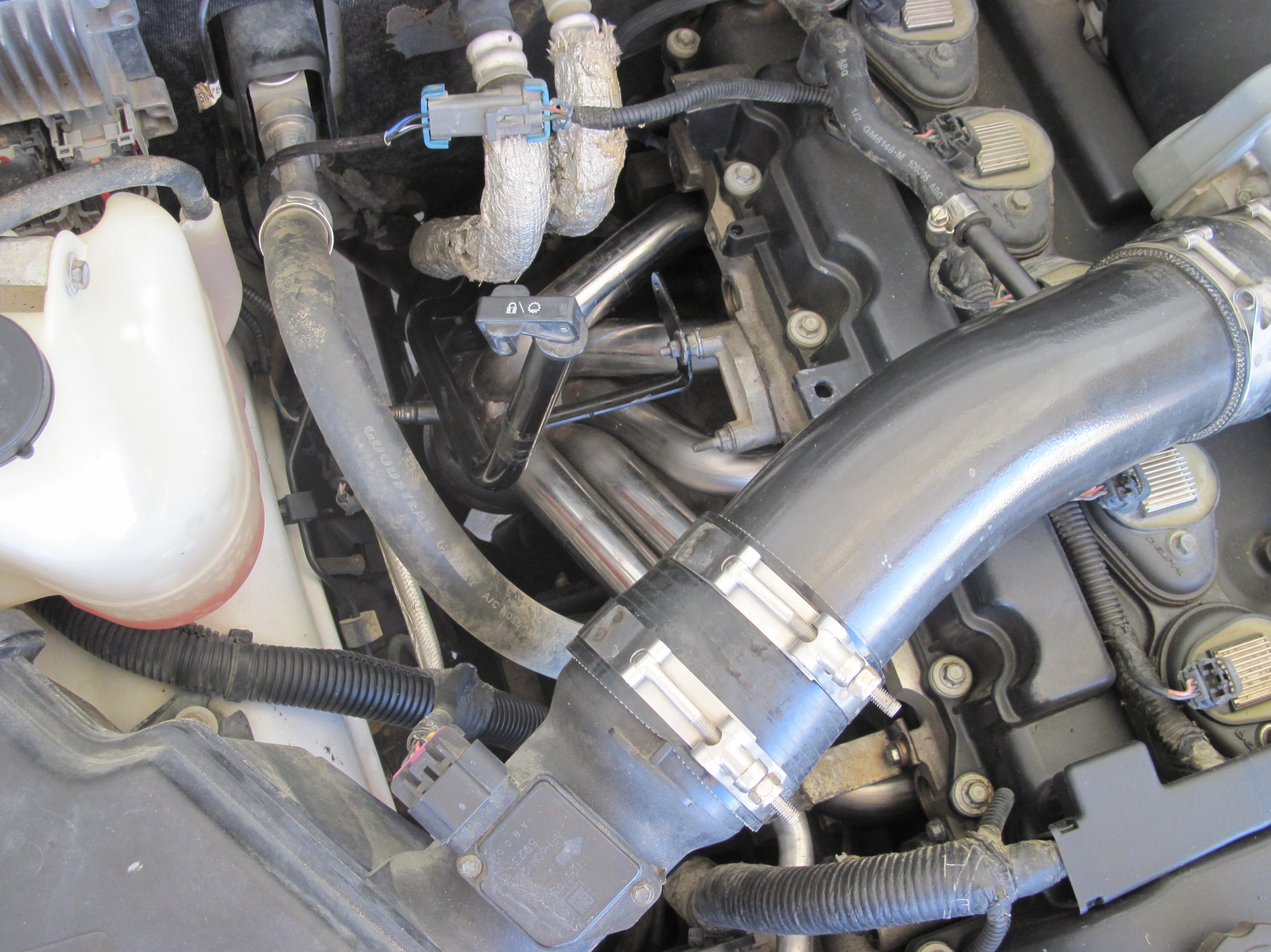

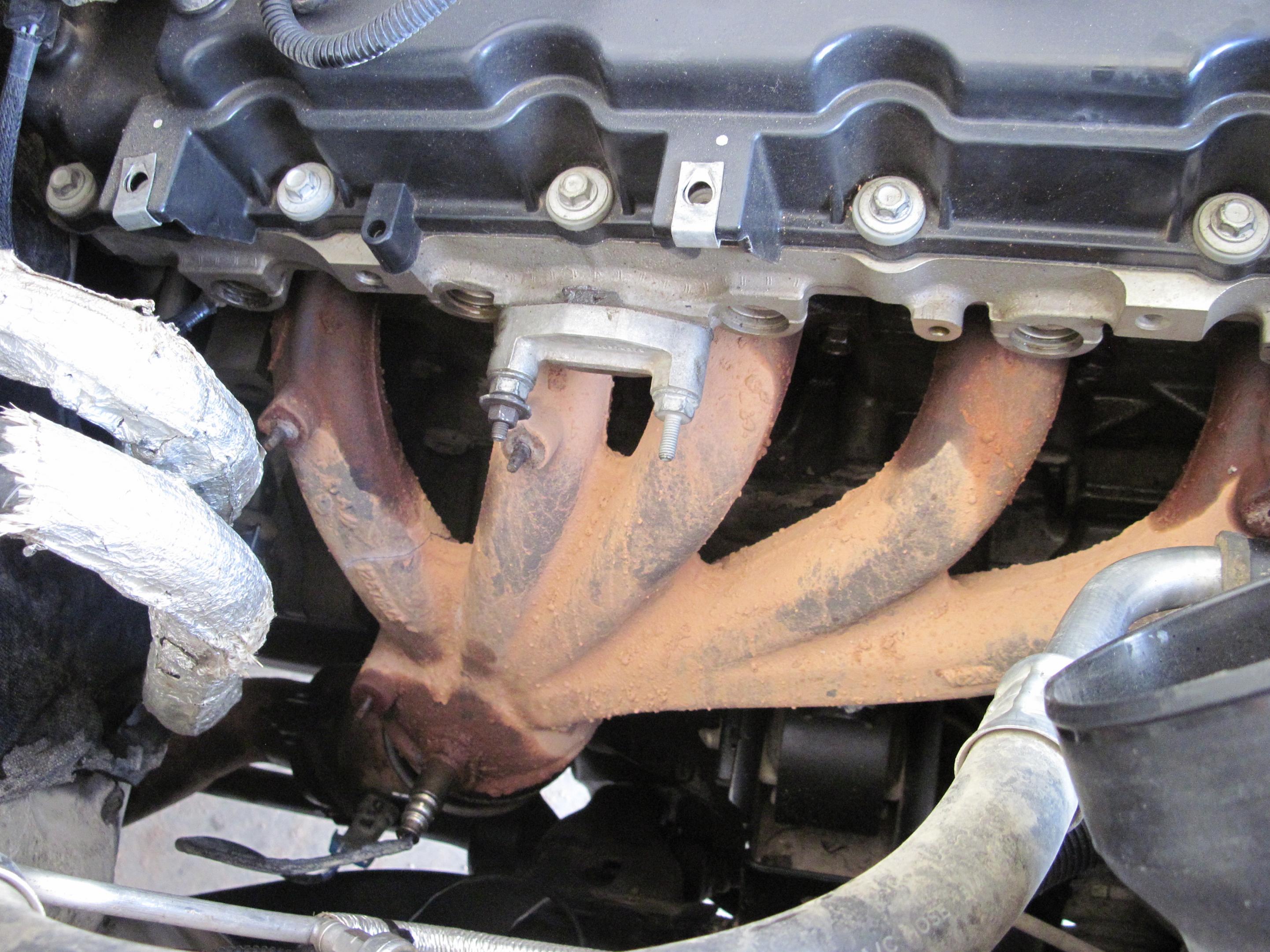

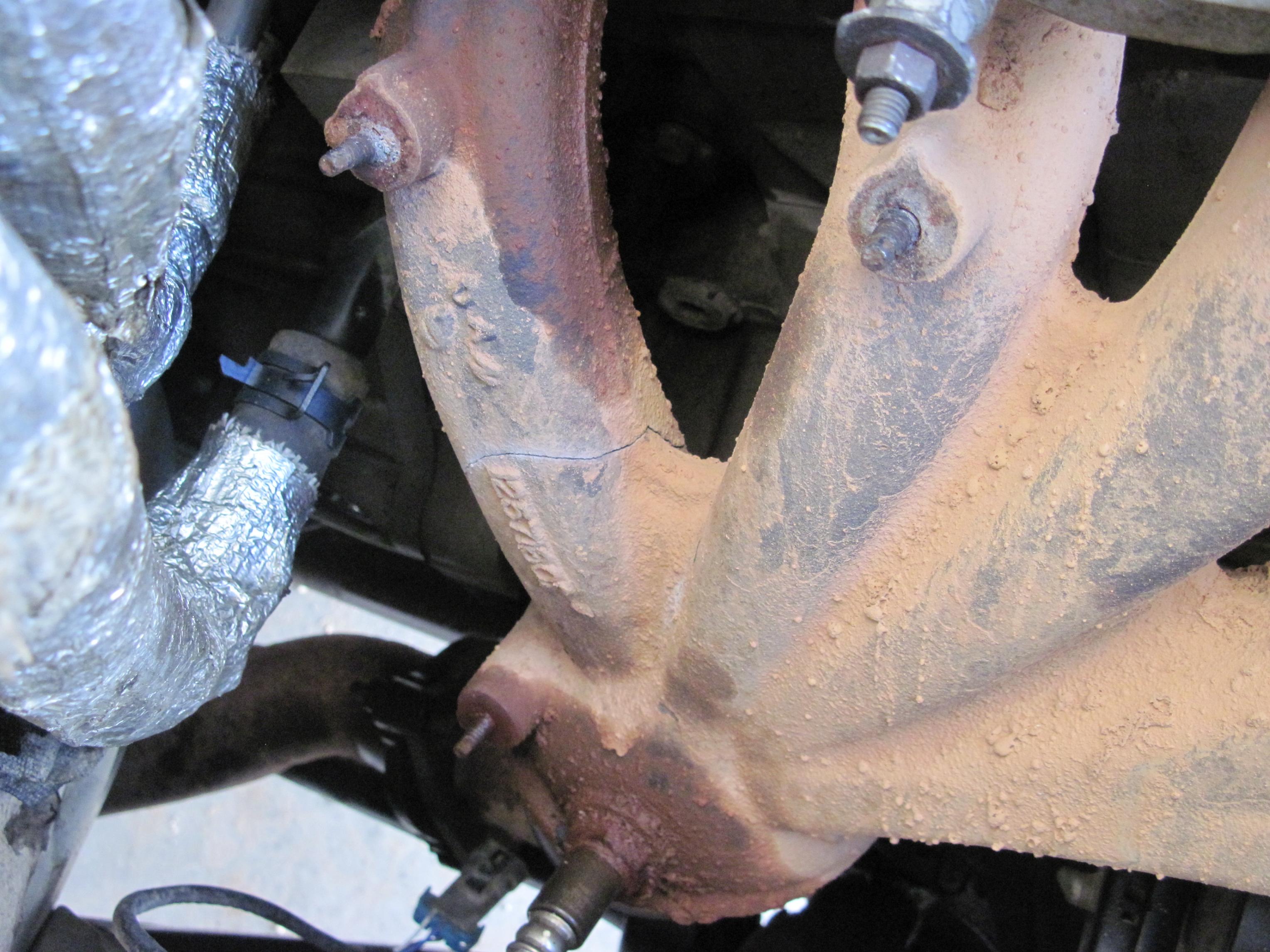

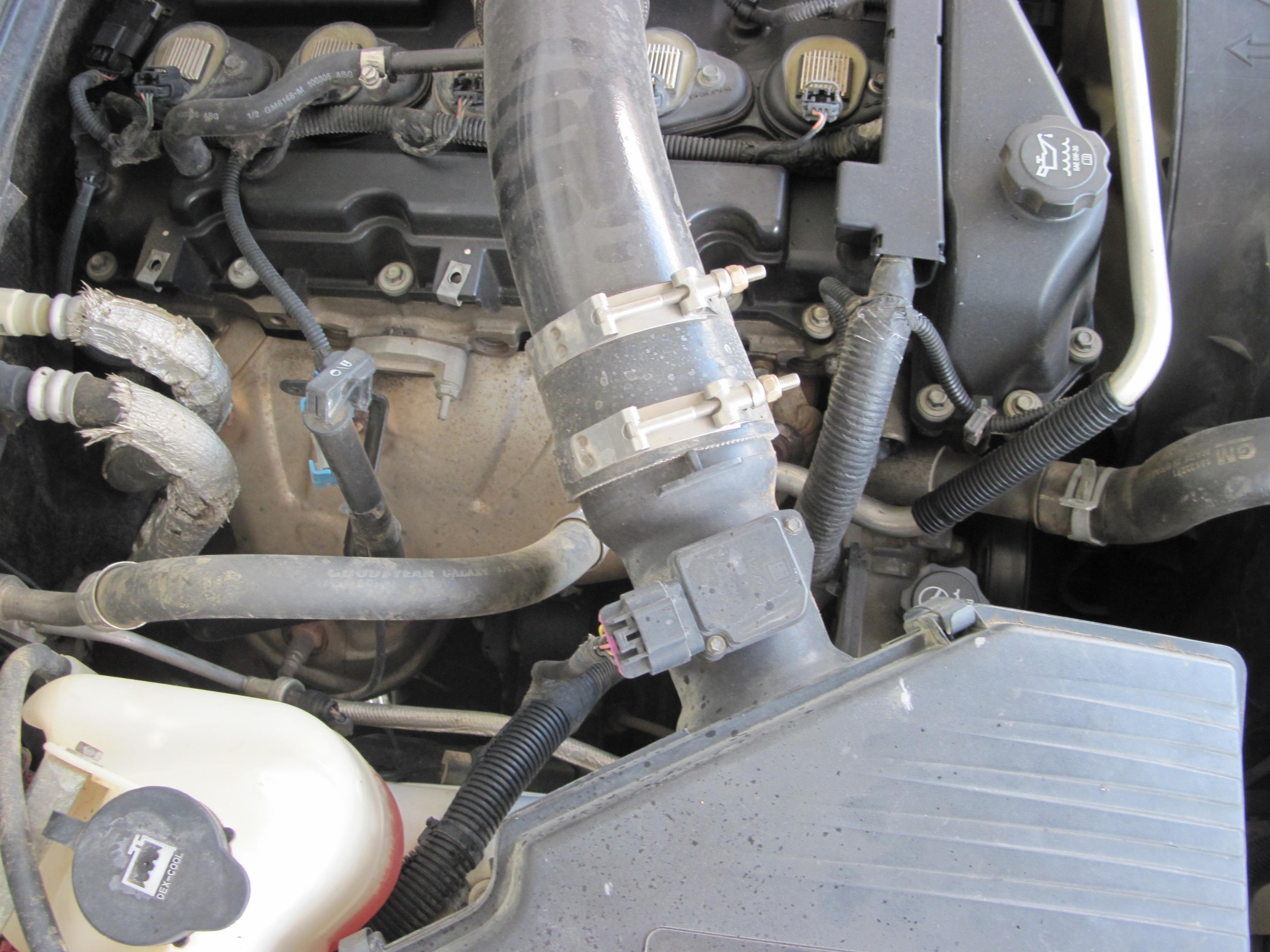

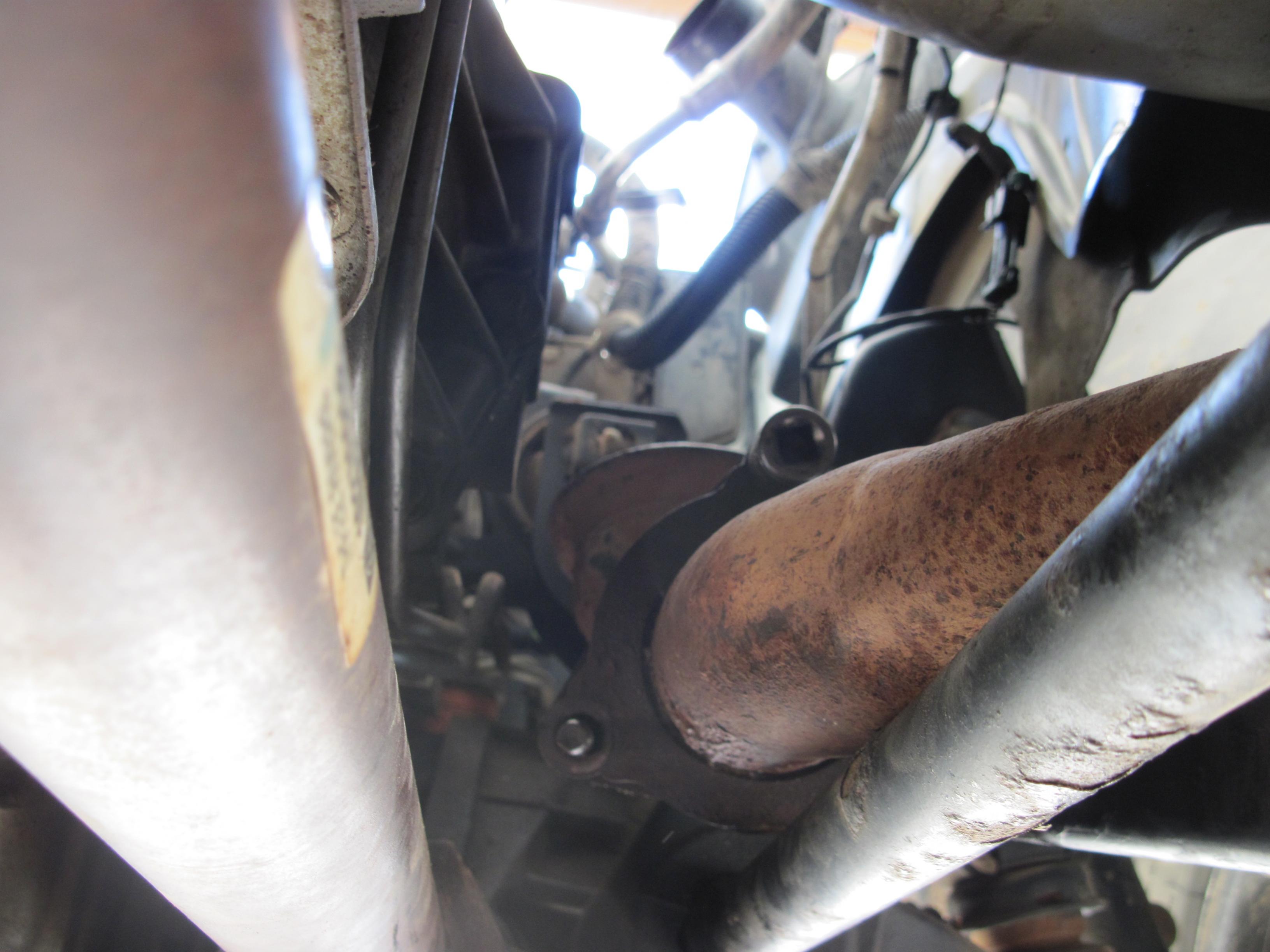

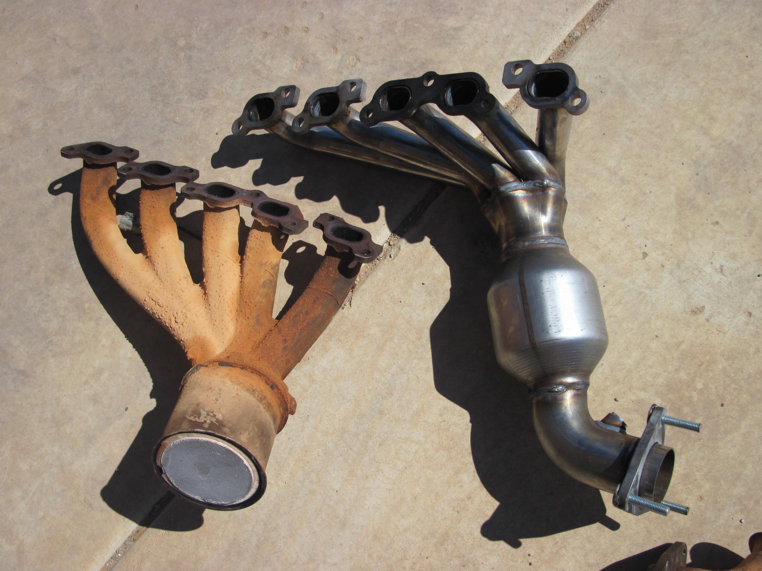

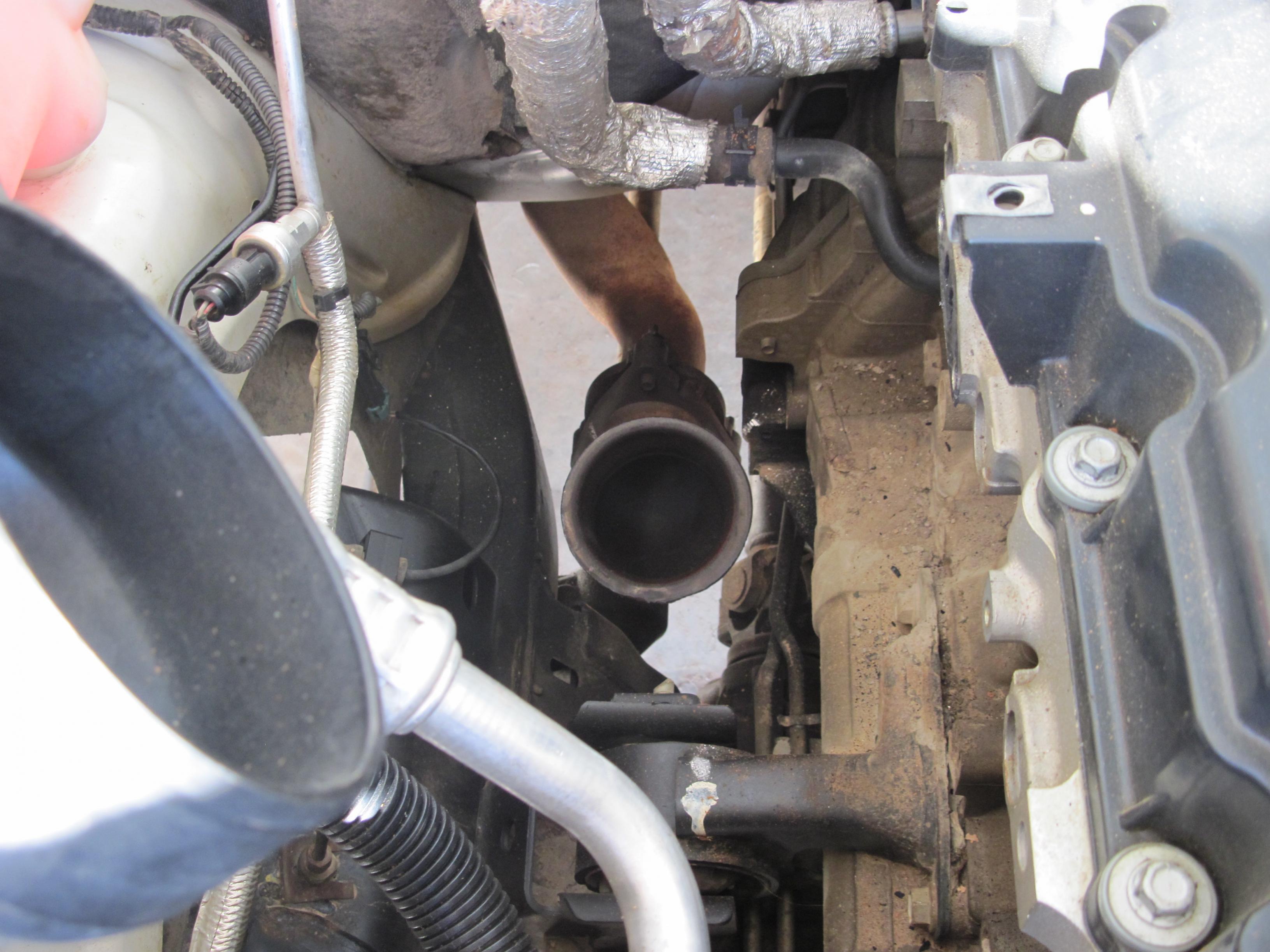

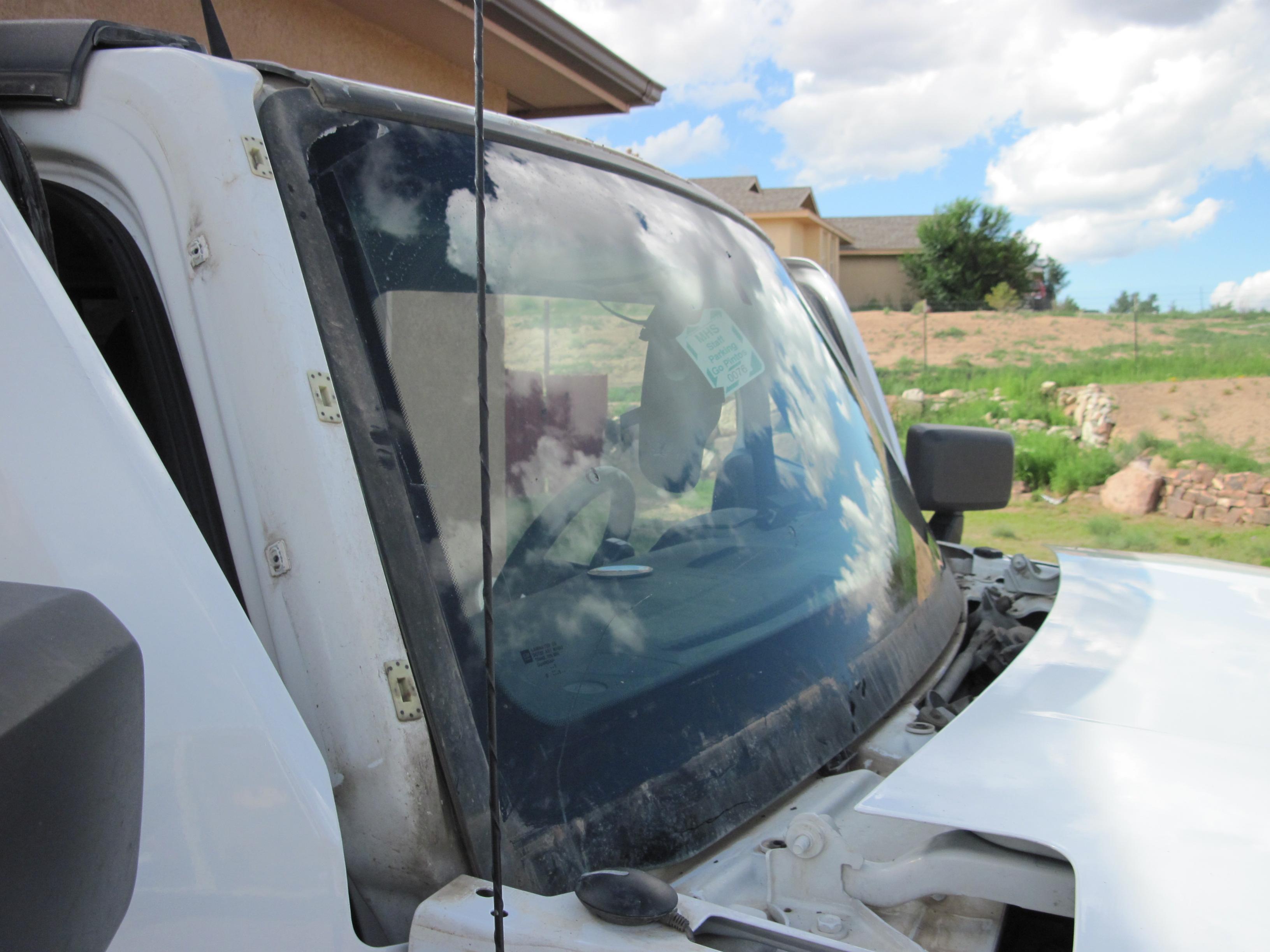

On an earlier thread I listed some options. I went with the MagnaFlow Exhaust 51882, $422.54, free shipping, arrived at my door in 3 days via FedEx, ordered through Amazon. To remove start underneath. The 3 nuts are the worse. Impact driver would be great. I had none. I removed the front drive shaft to get more room. Also remove rear exhaust from hanger to get more movement. At top removeAirDoc, remove tranny dip, 4 bolts for heat shield, 2 bolts from that cover thing(what is this thing for? I replaced it a while back, it cracked) Removed 9, 1/2 inch bolts. Were fairly easy, none broke. Remove manifold. Insert new, torque to 15 foot lbs. Don't install o2 sensor till you got manifold in. I did manage to IMG_1339.jpgIMG_1344.jpgIMG_1345.jpgIMG_1346.jpgIMG_1347.jpgIMG_1348.jpgIMG_1340.jpgIMG_1341.jpgIMG_1342.jpgIMG_1343.jpg remove and reuse old one.

well did some more research and the one you ordered is made to oem grade and the one i found has less precious metals in it... i guess i should go oem grade

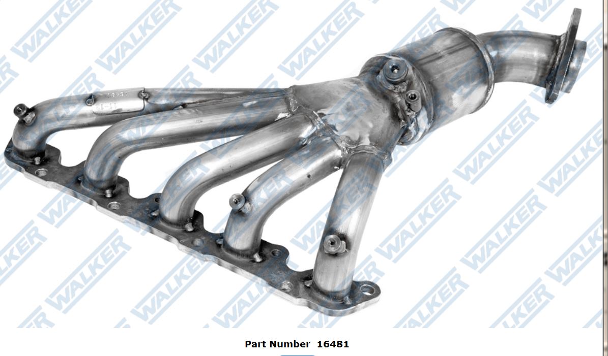

The Maganflow for my 2007 is $700+ as compared to the 3.5 2006 header.
I did find the Walker 16481 for $413 from rockauto.com

On my 3.5 i was able to get a wrench in and around them. it was the bolt at the front of the engine on the bottom that had me cussing. the hardest part By far is the three bolts below the c.a.t. attached the the exhaust.

If you can take some pics as you take out and install that would be great! I am wondering about the AC or heating lines that go thru the firewall aboe the manifold. Do they need to be disconnected or not?

so the ac line are not a problem they are flexible enough that you can get the header around them with a little elbow grease. So it showed up yesterday and i went to install it and i got 8 out of 9 header bolts to line up, tell me how 8 line up an one doesnt... idk so then i took a break and went underneath to hook the exhaust to the bottom of the CAT. well the flange on the exhaust that slides over the three new bolt of the CAT would not slide over all three. I do not know if the three bolt are just slightly further apart or what but it was not happening. A normal fix would be to just bore out the wholes a little more and i see that being an easy fix. I am in colelge with out all my tools with me so either my dad is coming to come up with the compressor or im going to have to take it to a shop! which is a worst case scenario cause i love doing things my self but i will keep you updated

Update with my new exhaust manifold. Getting 2 more miles per gallon! On install did not have to remove any lines. All 9 bolts were easy to get out. But need a deep well and swivel 1/2 inch and several different size extensions. The hardest part was getting the 3 bolts on the bottom removed. If you have an impact they should be no problem. Everything lined up with mine. As for the bottom 3 bolts not lining up, you sure the collar that the 3 bolts slide into in not warped? Mine was slighty and need to take several wacks to get the bolts in. Likewise, when taking apart It was difficult to get the collar off after the bolts were removed.
