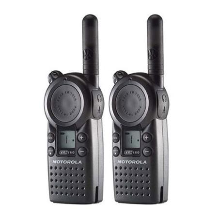

Seriously. Hand-held two-way...the only way to go. 08H3 turned me on to using these, and I love em. No static. No squelch. No Trucker chatter. No wiring. No antennae. No expense. Read some reviews...range can vary quite a bit but, I've never had an issue with range for wheeling purposes. Cheapo Walmart 2-ways totally blow away my Cobra Roadtrip HH CB (an absolute total POS of a radio) but, I'll admit...my wife misses flirting with truckers to/from the off-road parks!
I specifically like small AA-battery powered units, and some of these work with mini-headsets (ear-buds) so you and your spotter can discuss a route without yelling at each other. The FCC frequency range is the same on all of these, regardless of brand...so multiple users can all tune-in to the same channel regardless of manufacturer. Prices range from $27 for the Hello Kitty model...
...to pro-quality for $346...
Also look into motorcycle 2-ways. These are small, voice-activated, two-way, head-sets...perfect for spotter-driver communication.

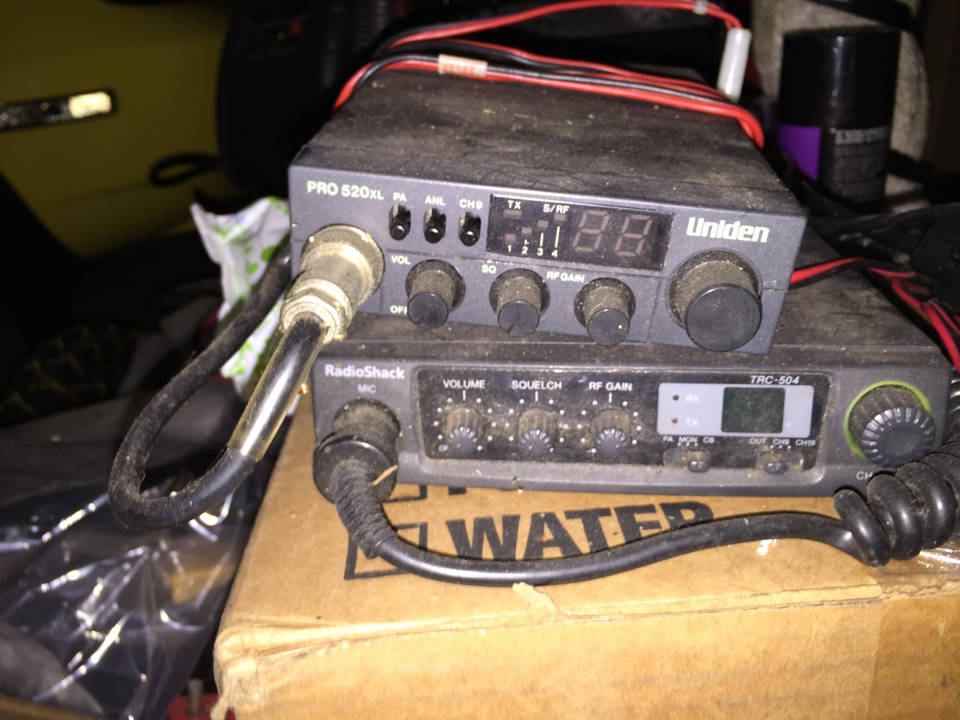

I found these in my garage, are either one of these any good? And if so, which would be the best suggested antennas for them, or in general which are the best antennas in case I end up upgrading to Ham radios?
