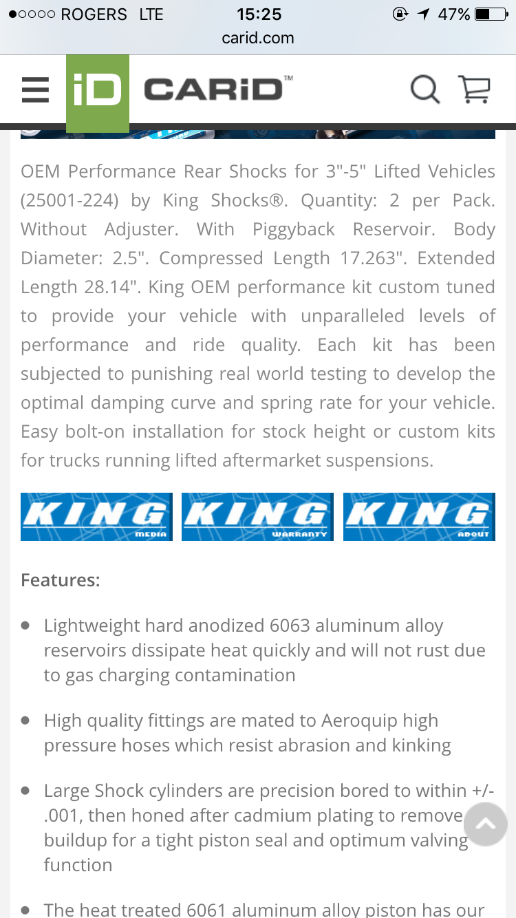

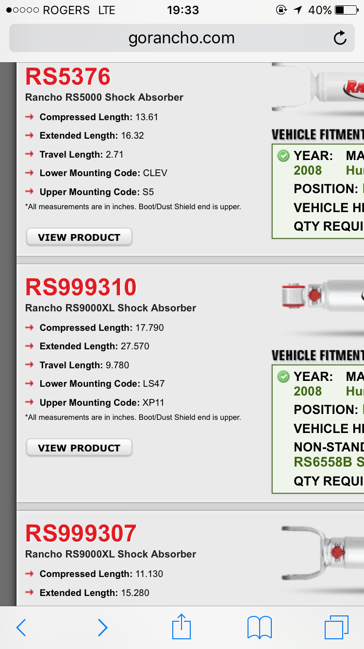

Sorry to hijack thread, i wonder if I can use king shock for Jk application for rancho lifted h3 , seem to be pretty close image.png, is collapsed length 1" difference gonna effect up travel?

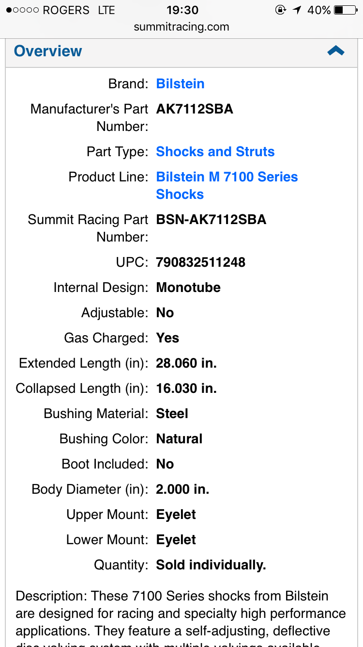

Here is Bilstein 7100 1" shorter collapsed length compare to rancho one , King is like little shorter, that why I'm debating on getting King shock one if that fit
