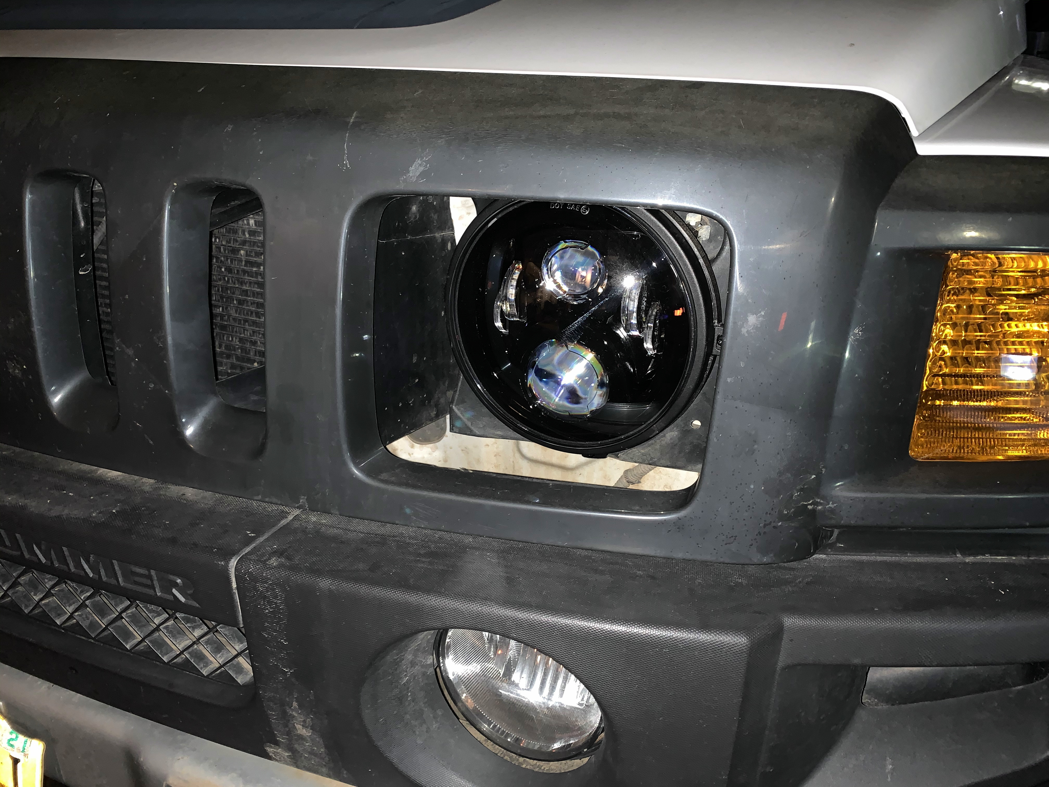

Finally got around to installing new headlights with the Lased Designs adapter kit for Jeep headlights. Took a bit longer than I expected, but I suppose most of that was due to me running back and forth to the store for things I needed and did not have.

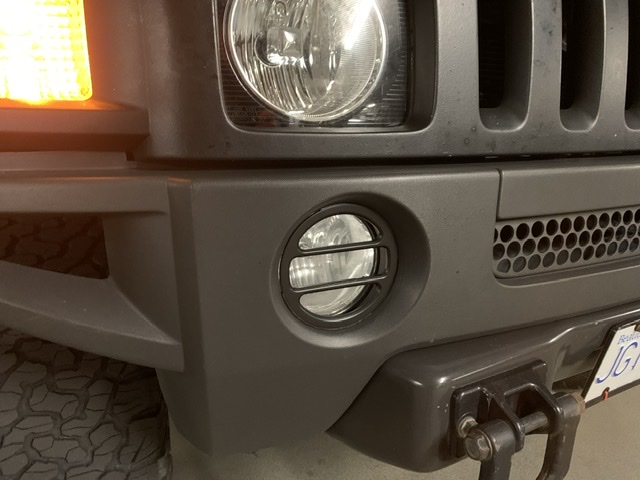

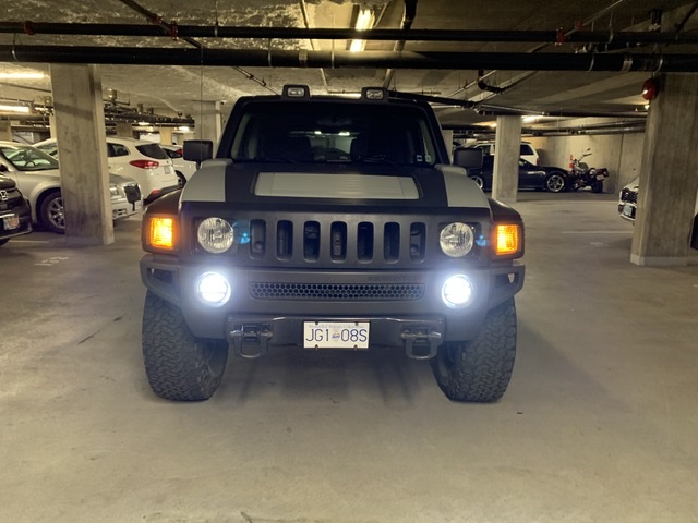

Foglight guards
I installed some foglight guards. They’re ok, no measurable decrease in light output, and It looks a little tougher.

Sorry, when I bought it last year, I also got a bunch of stuff buddy hadn’t plastidipped yet. Slowly going through it, lol. Still have a set of lights for the lower grill that needs dipping
