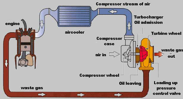

Consumption of fuel is regulated by computer for optimal performance. Proper mixture of gas and air gives you the right amount for good bang to create the pressure to push the piston down. But naturally aspirated engine have a pressure of 0 or even a bit on the negative side when piston is in the low position. What turbo does is forcing the air in to the piston when it is low and air valve is open. That creates a positive amount of boost pressure, multiplying it when the piston at it's high position and the mixture ignites, resulting in more pressure to push the piston down (pressure = piston is going down with more force = more torque and pressure = piston is completing the sickle faster = more hp) But forcing just air is not enough, more air mean you need MORE FUEL for the correct mixture, that's why in most cases when you instal turbo you have to get bigger fuel injector and tune the ECU so it will accommodate for the positive air pressure and dump more fuel.
In all turbo application that I've seen the fuel consumption drops lower. HOW DOES TURBO INCREASES THE MPG???
Please correct me, if I'm wrong...
Its not 0 pressure its 1 atmosphere ie 14.7 PSI. Boost is is any pressure above 1 atmosphere, so when your BOOST Gauge maxes out at 8psi that is 8 psi above 1 atmosphere. The pressure doesn't push anything, your increasing the volume within the piston area to burn fuel more efficiently. There is a boost relief valve as well. You need to Google Turbo charging before you question its capabilities and function.
