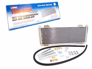

Now, because the trans temp, I am going to install these trans cooler:
I am from Spain, here, the climate is usually hot (40 ºC in summer), and I usually go to Sahara desert once or two a year. So I am going to install the trans cooler without bypass valve (winter temperature of 10-15 ºC).

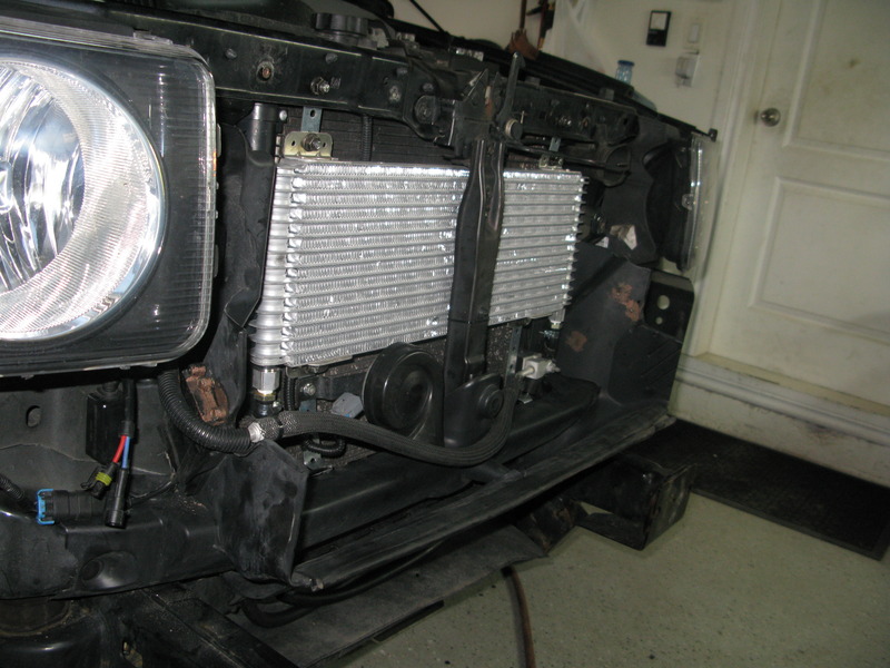

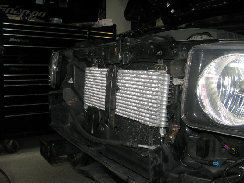

I see in a previous post of ''Citiboy'', that he install this transmission cooler in a Hummer H3 v8 Alpha, here are the pics from his install:

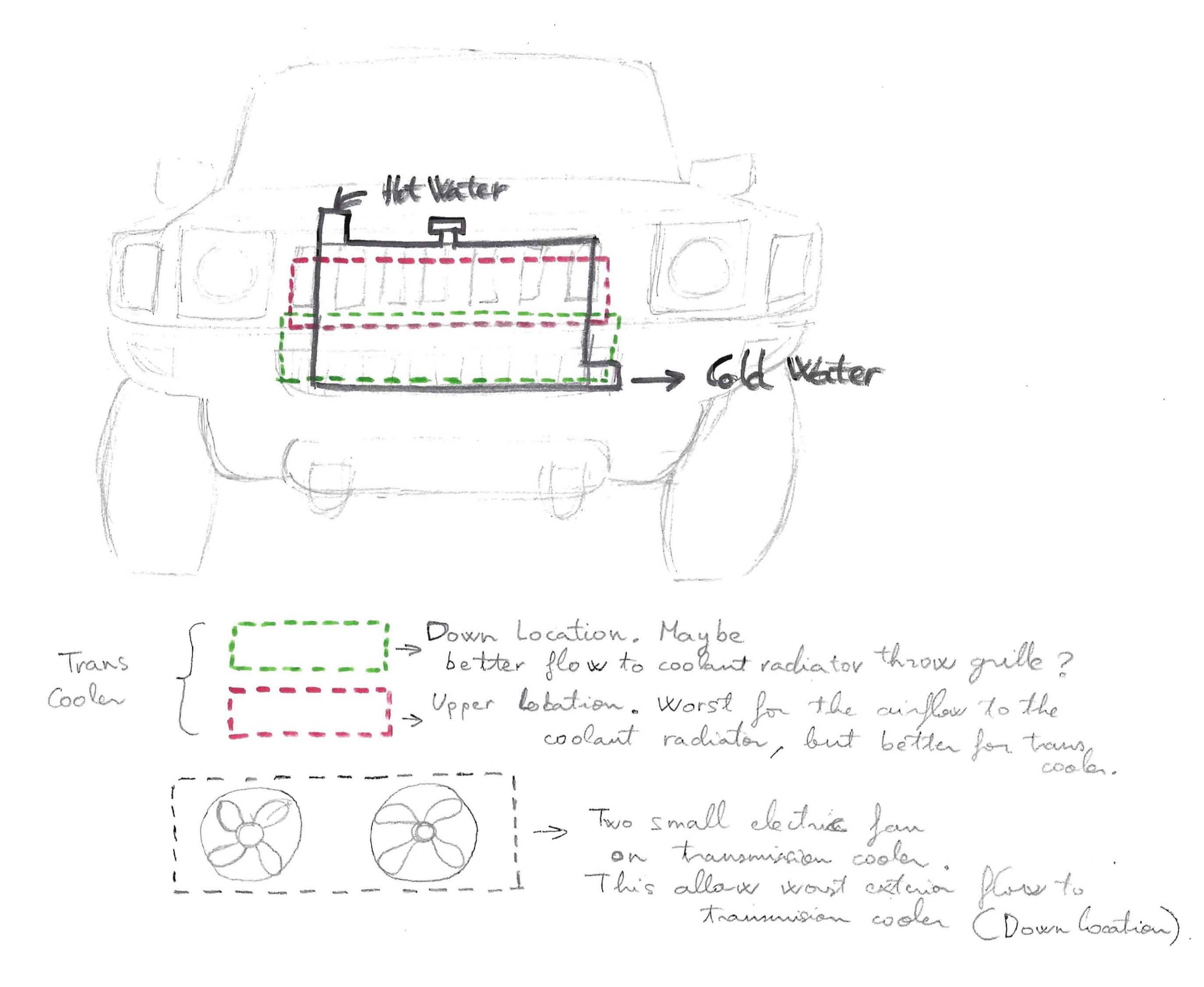

Here is my question: I want to put two small electric fans in front of the transmission cooler (sahara temp of 40-45 ºC), so I am a bit lost about location of the transmission cooler in relation to engine radiator (I dont want to cut air flow to engine radiator (smaller cut possible)).
So here are a draw that I made about the location, there are two location possible, upper or lower...I think because of the two small fans in trans cooler I can install it lower, because the fan will compensate the lower airflow from the exterior, this solution allows the engine radiator to have better air flow throw the front chrome grille.
Here is the draw:
What do you guys think? I am going to put two buttons for each fan inside the cabin.

1. The trans cooler 40K is too cool for your application. I ran 30K on my V8 and when I go offroad in the desert in 50 celsius summer the trans temps didnt go above 85 celsius. On road I get 70 celsius in summer
2. I run a new stall converter at 3200K (much more heat than stock) so I upgraded to 40K. Its great but on the highway it gets too cold (45 celsius). Weather here in the winter is usually 15 celsius in the day. I will add a bypass to get trans temp 60 celsius at the least.
3.The only way to run the fans is behind the radiator support bracket. The H3 alpha from SA came with 2 fans (11" and 9") put infront of the condenser. There is a 7 cm gap between the condenser and the radiator support.
Your setup should be: condesner - fan (s) - trans cooler.
If you try to run the fans infront of the trans cooler, the radiator support bracket will come in the middle and this will force you to use two small fans (approx 8" fans)
Btw, You can instal one spal 16" pusher fan that will fit between the condenser and the radiator support bracket.

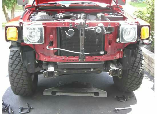

Below is a picture I borrowed from the site (shows the support bracket - vertical and the body - horizontal).

If I understand well, I have to install the bypass valve (hope that is reliable), for winter and onroad temps. And the correct setup is like amrg said: Condenser - Medium size fan or dual small fan - transmission cooler.
Then the location of the transmission cooler will be upper, am i correct? And a very important thing is: there are two types of fan in my knowledge, one will suck air (like the mechanical stock fan) and other will push air. What type should I get? (with the setup that amrg said)
Thanks you so much again!
You need a pusher fan infront of the condenser.
The trans cooler doesnt block airflow because there are alot of gaps around it for air to pass (at idle).
If you want the biggest fan, get a spal 16" pusher fan.
This will barely fit
http://www.universalpartsinc.com/shopping/productDetails.aspx?i=750015&c=10502
It is the biggest fan you can fit with minor modification. The vertical support will need to have shims installed behind it to give you 0.5 cm extra space to clear the fan motor.
If you want, get a sensor in the radiator hose that when reaches lets say 99 celsius switches the fan on and when it goes down to 91 off.
