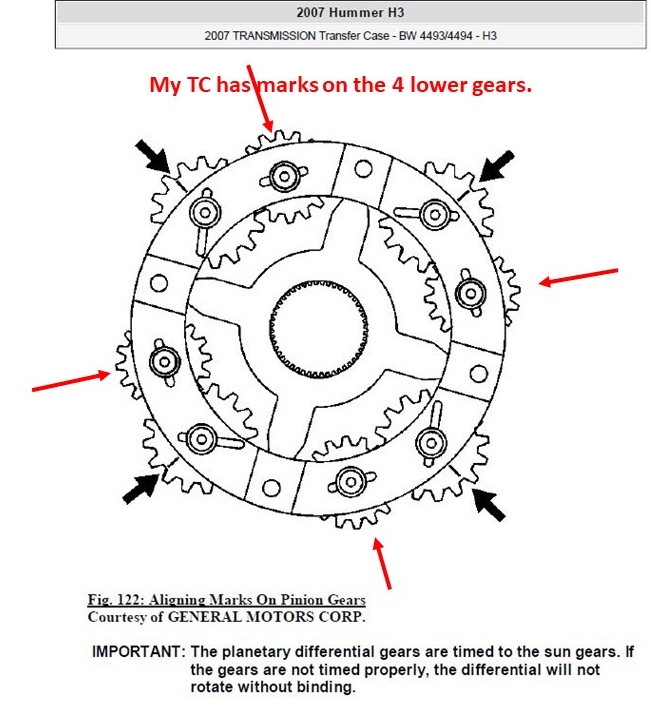

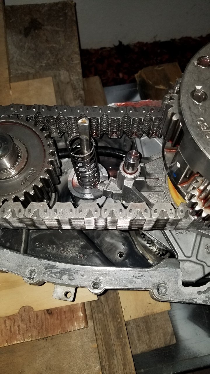

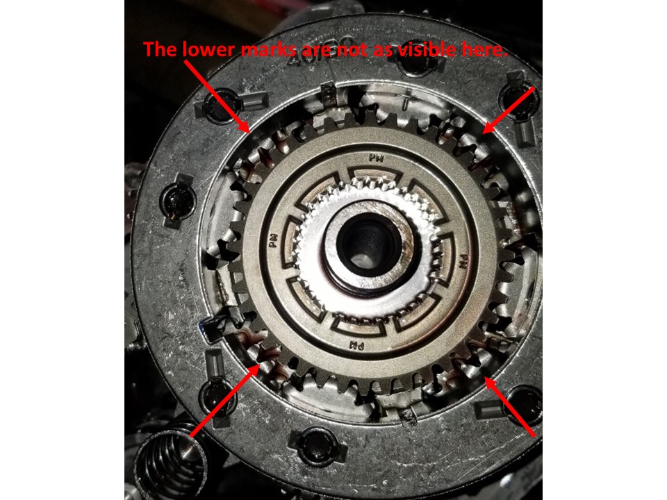

As I sit here a sipping a Belgian Tripppel (10%) I feel comfort in finally finding and fixing the transfer case issue. I was hesitant to split open the TC but after a day of videos and online posts and liquid courage, I took the leap. After 2 months of the shop and myself struggling with it being stuck in 4 High lock, and 2 tear downs I was ready to buy a used TC just to get it back on the road, almost accepted a $800 offer on ebay for a 180k used one. After I decided to break it open it took 5 seconds to find the problem. AHHHHHH, the stupid shift fork spring was on the selector shaft, WTF!!!!!!!!!!! After I split the case to clean the surface, I noticed the planetary gears were not aligned as the manual says. An ah ha moment I said "I know what to do, I read the PDF". WTF again. Those are a PITA to get aligned. My gears only had 3 out of the 4 with marks on the top gears. But nothing I did would allow the gears to align. After an hour of head scratching, I seen that the 4[SUP]th[/SUP] gear had a mark on the bottom side, clearly a manufacturing mistake. An hour and a half of struggling to try different positions nothing worked. Then I realized that the bottom planetary gears had marks on all 4, sure as scat it worked. Everything was aligned and re-assembled. Test drove it today in all 3 ranges and works like it should. Going to Cleghorn either tomorrow or next week to flex the legs a little. Happy dance was not caught on video.
