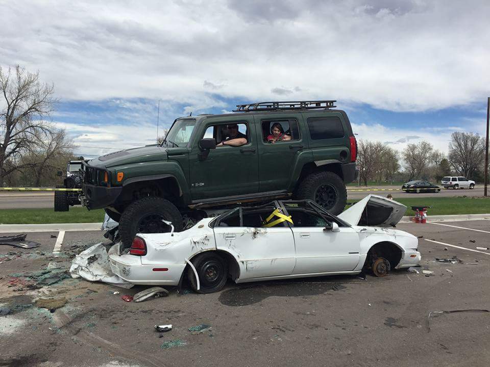

Oh yeah, and here's the fun pic... This was a "crawlers for Christ" event today. I was the only wheeling Hummer there.
It seems likeover the years whenever I push it hard the tcase stops shifting. Is this common or just me? Any tips?

Should have had the kids in front of the rig.

Fortunately I have a commuter car, which looks suspiciously like the white car in the picture.
In front? Are you mad?
