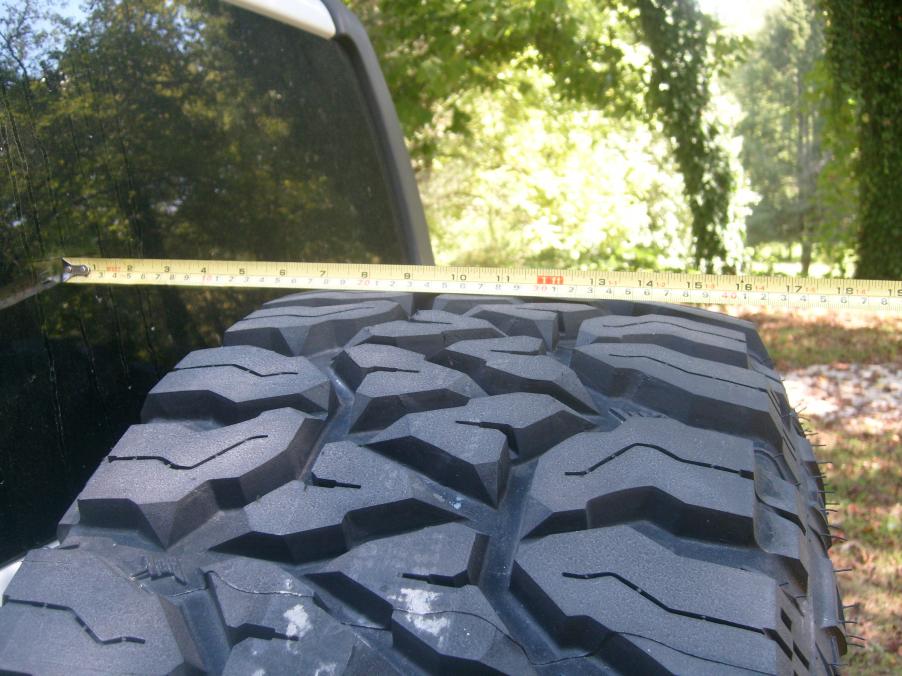

hey Hunner i measured how far my tire sticks out by measuring off the back glass. Its about 18'' from the glass to the out side off the tire. If you don't care could you measure from the glass to the out side of the rack?
Thanks JoshuaL
Thanks JoshuaL
Of course I don't care, it's my job. That and being retired.
Would you believe 20"?
