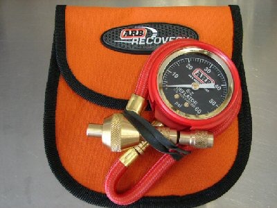

Alrighty well after last run with the guys over at big bear hosted by Zach...it was clear to me that it was time to get myself a tire deflator and a portable compressor.
So I decide to go with the Viair 450P
And the ARB Tire Deflator
I was Messing With It Today For A While And I Like Them so Very Much, I'm Really Happy With this Purchase.
I Got To See The Viair 450P in action during last run with the guys organized by Zach...JrWid aka John he drives a badass black jeep...he inflated his 37s with no problem and my 35s without having to let the compressor rest...so I knew I had to get myself one, specially after reading nothing but good reviews about this little compressor.
And as for the ARB Deflator Poncho Let me use his and I knew I had to get one as well makes airing down a lot faster.

That was Jrwid aka John with the bad ass JK.
Also had the ARB deflator. Works good but IMO a PITA. Went to stauns. Screw in and can mingle more lol
Panzer07
2,548
Ontario, CA
Thanks for providing the man's name...that way I can give proper credit to him...and I look at those as well but they seem a little pricy to me at Thai moment, I'll see how this ARB Deflator Holds On And Performs...and if anything I might upgrade later in if it doesn't performs to my standards.
Used the ARB for a few years. Got tired of one tire at a time. Also ran into a problem where it wouldn't catch the valve stem core. Why I bought the Stauns. Great product. Think the issue was the valve stem core though
Panzer07
2,548
Ontario, CA
Yeah I think I eventually will too and upgrade to those stauns or similar deflator...but for the mean time I'll have the wife use the compressor hose thingy to deflate one tire while I'm deflating the other. XP Team Work.
Great plan.
