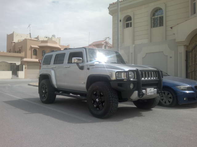

So tonight after work I took the leap of faith on the ole torsion bar lift and raised it up to about 23 3/4". Gonna drive it a day or so and take it in for a alignment probably Friday morning.
Here is a evening pic sorry I couldn't get one 10 minuets earlier when there was more light.
