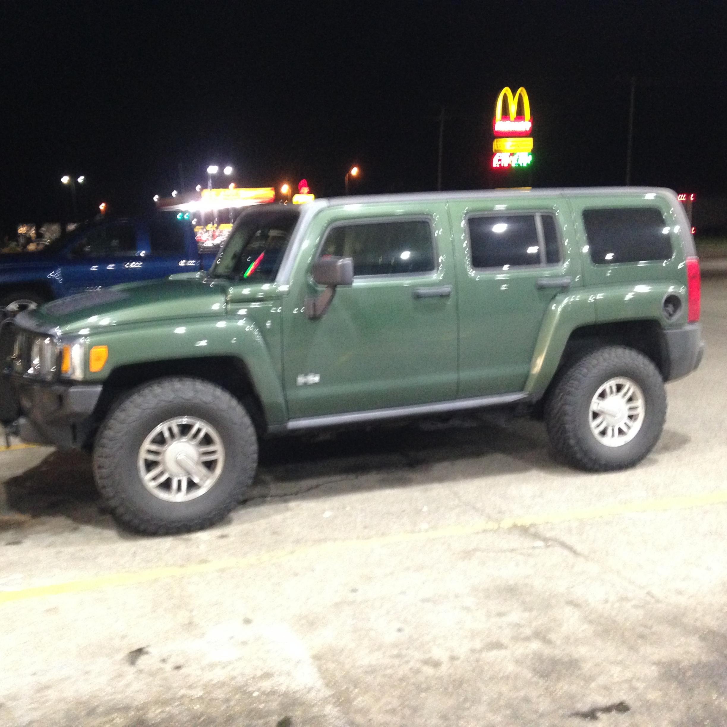

This is a bad pic but will give you an idea of what 285/75R16's will look like. truck 33.jpg

That green looks awesome. You dont see many in green.
Also, you have to remember that the bigger tire you get, the harder they are to balance. If I was purely offroading my truck, I would easily put 315/75/16 on but my little I5 might not agree on road.

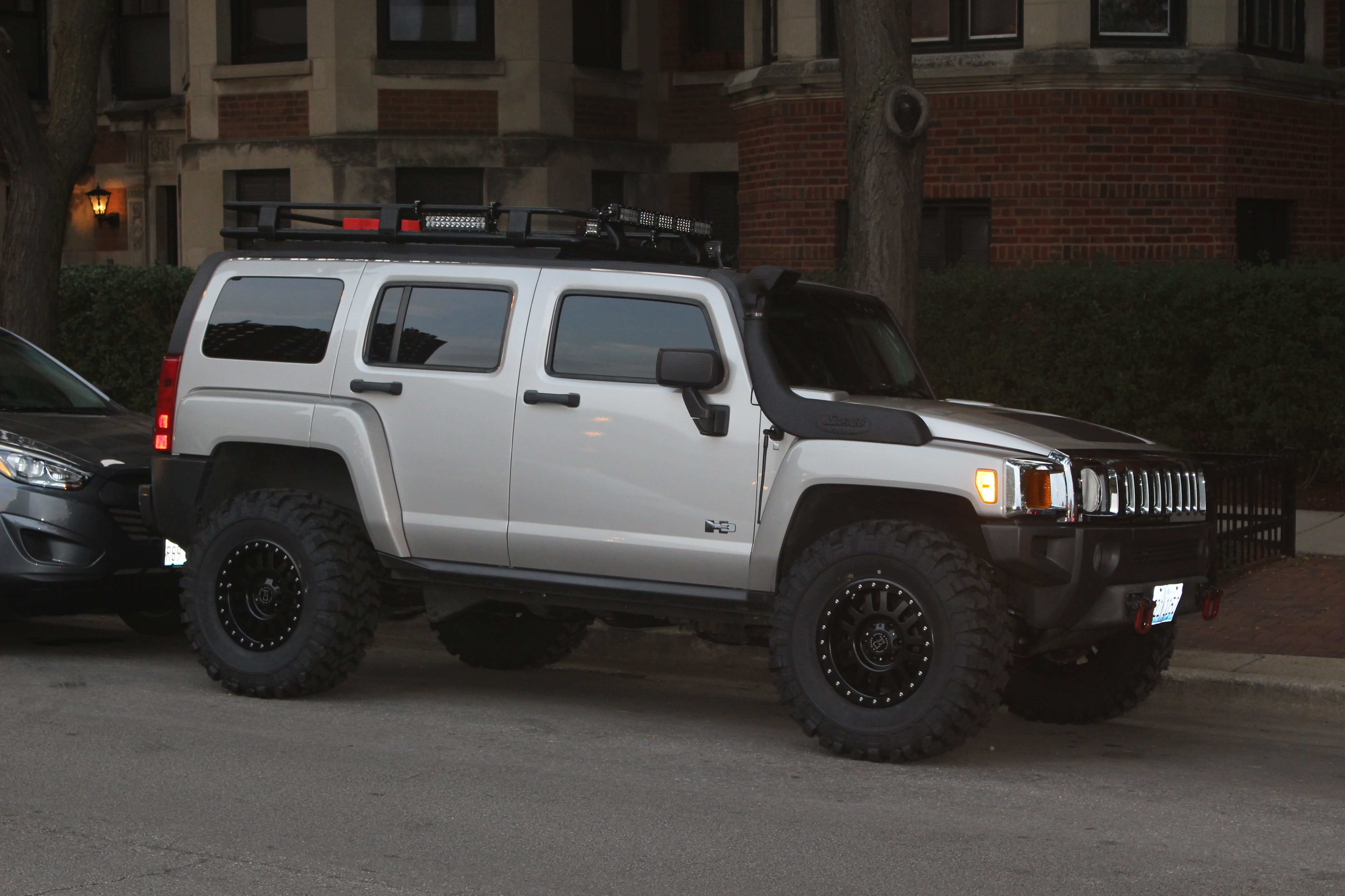

This is a true 35.20x12.5R17 tire on 17" rims. For them to no longer rub I have a 1" body lift and the front torsion bars lifted / replaced etc. Stick to the 285's unless you want lots of work to follow with it. Also, check the weight of the tire you are buying. Each one is different for example: Wrangler mt/r 35" tires weigh 64 lbs but the Pitbull Rockers weigh 85 lbs and yes you do notice the difference.
