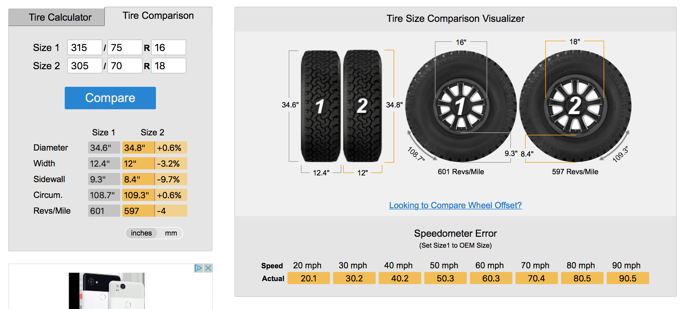

I also have the h3x, however I got rid of my 18's. Here is a tool that helped me, might help you.
https://tiresize.com/calculator/
Once there select compare then your stock size, and size you want then it will give all the measurements. And a picture for reference

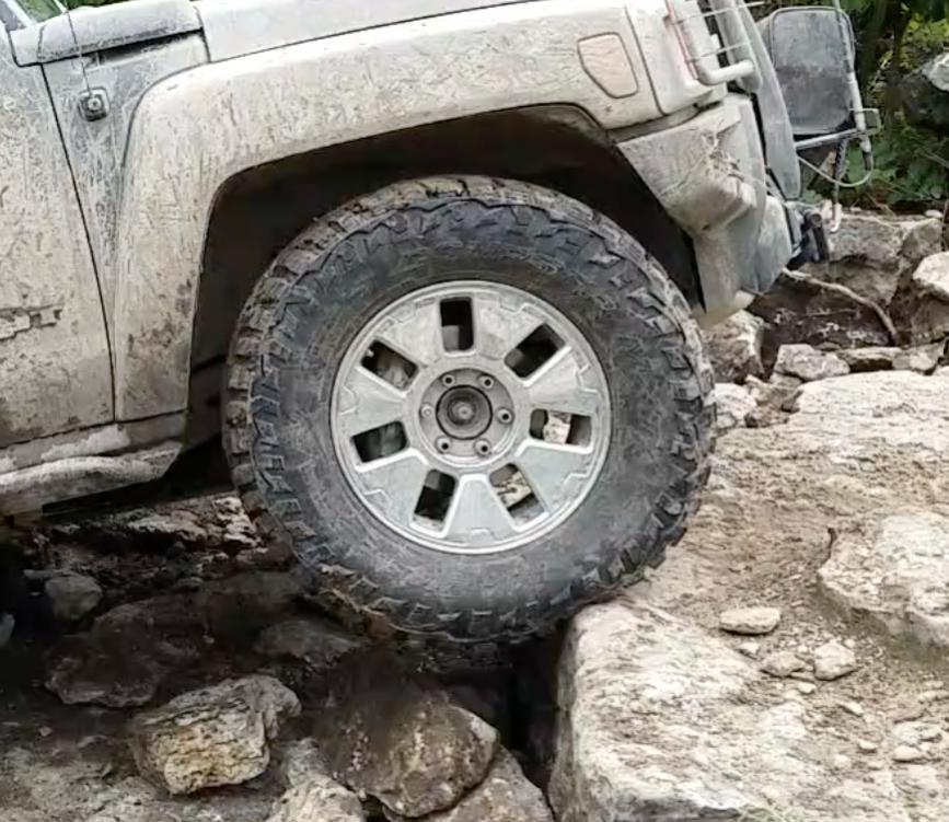

Wow! I forgot to update on this. I ended up getting 33 inch tires with a width of 11.5 back in June 2017.
Since then I’ve also put new upper arms, shocks, did some painting to the suspension so it doesn’t look rusty, and some other upgrades.
Don’t know how to post pictures so...

I have H3X wheels on my H3T. Maybe that makes it a H3TX. I have Mastercraft Coursers on it. 305/70R18. They are nearly the same size as 315/75R16 on factory Hummer wheels. Almost 35" tall, and 12" wide. My torsion bars are cranked, but not maxed out, they rub on the sway bar a little bit at full turns. I think this is the biggest tire that a tire shop like Belle Tire will put on a 7.5" wide rim. The next size up in a popular size is 325/65R18. I believe that tire it too wide for a 7.5" rim according to their specifications as to what they are allowed to install.
