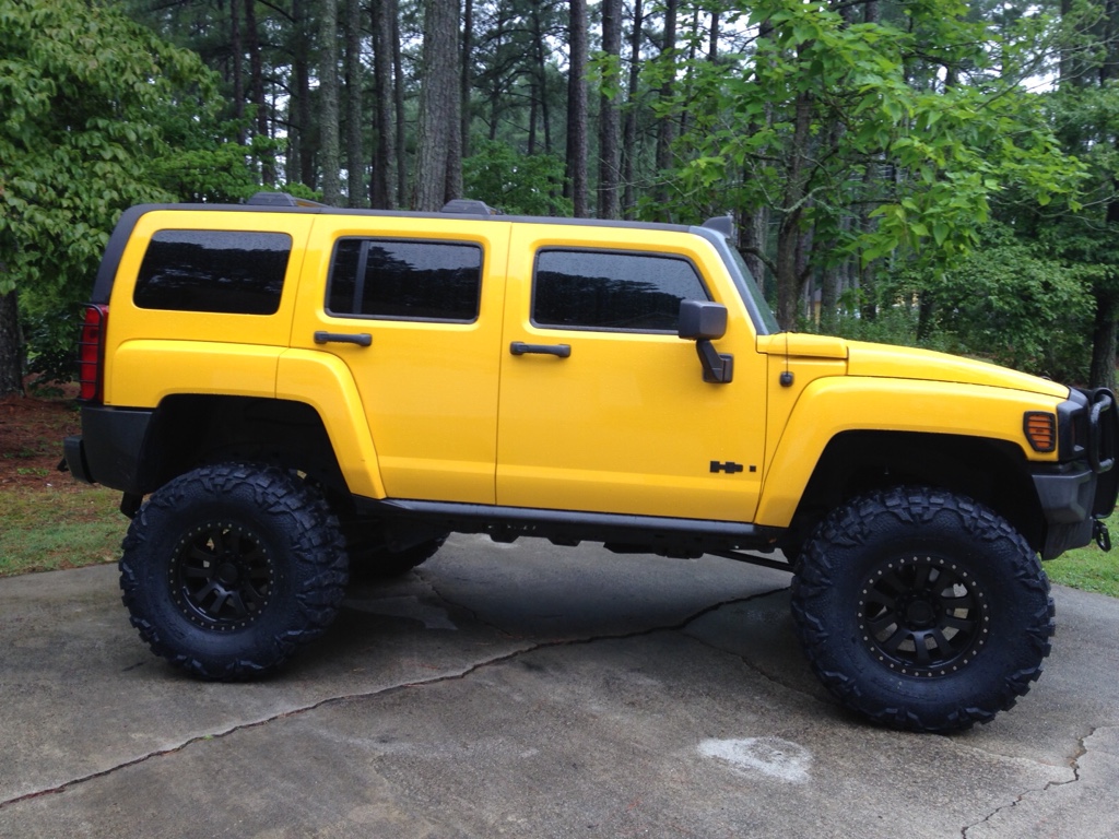

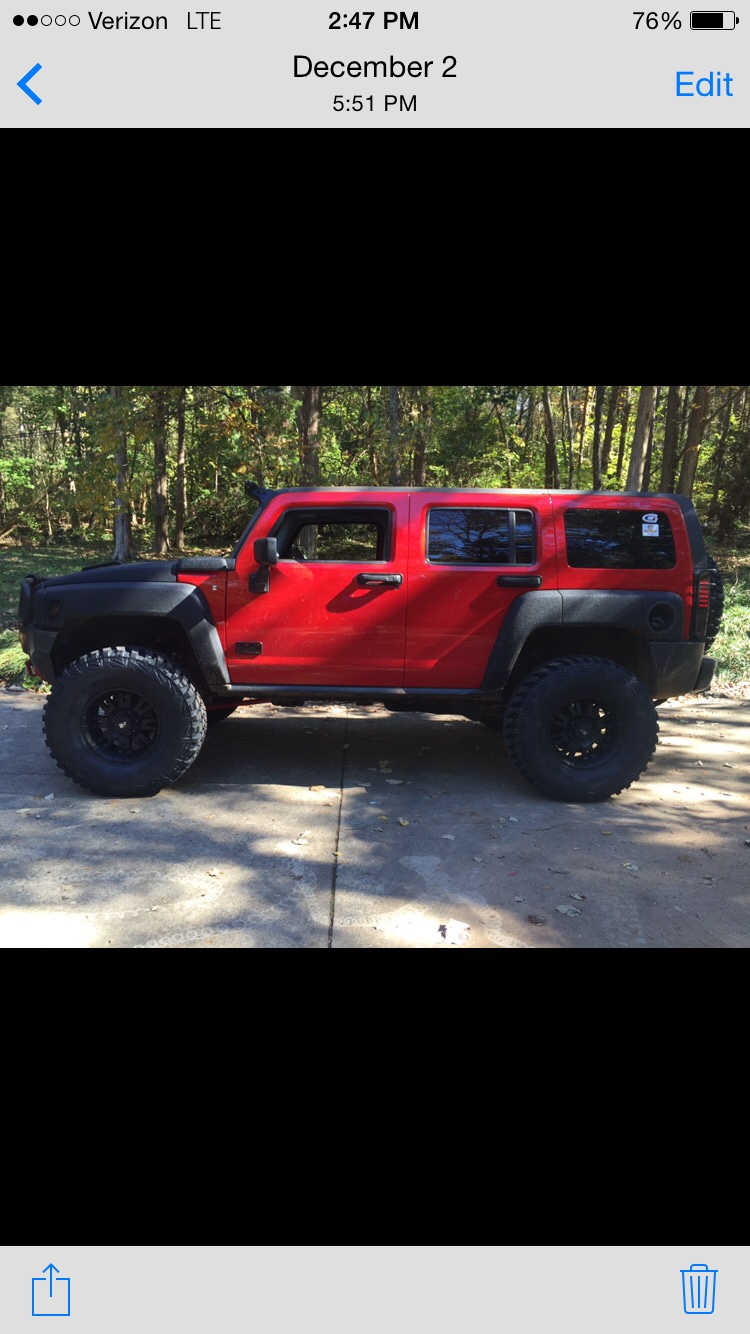

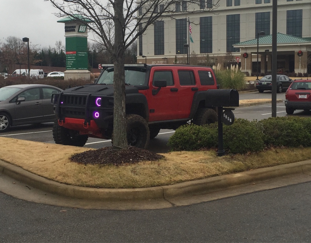

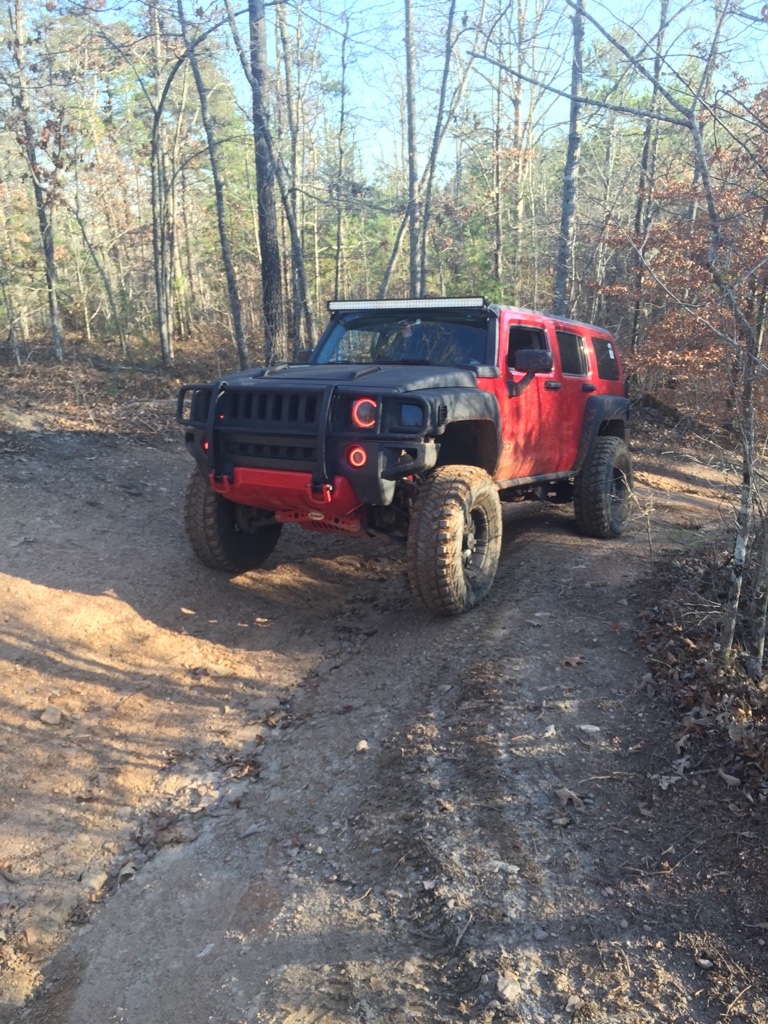

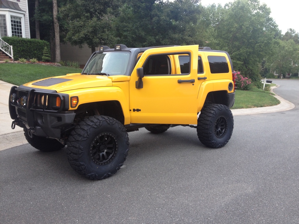

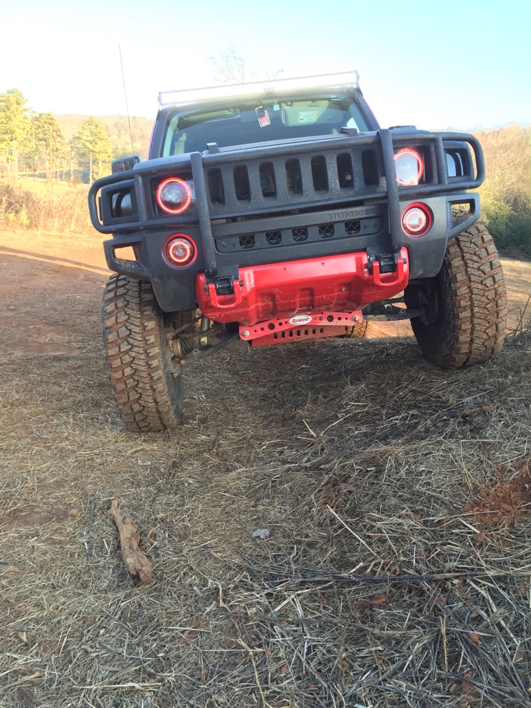

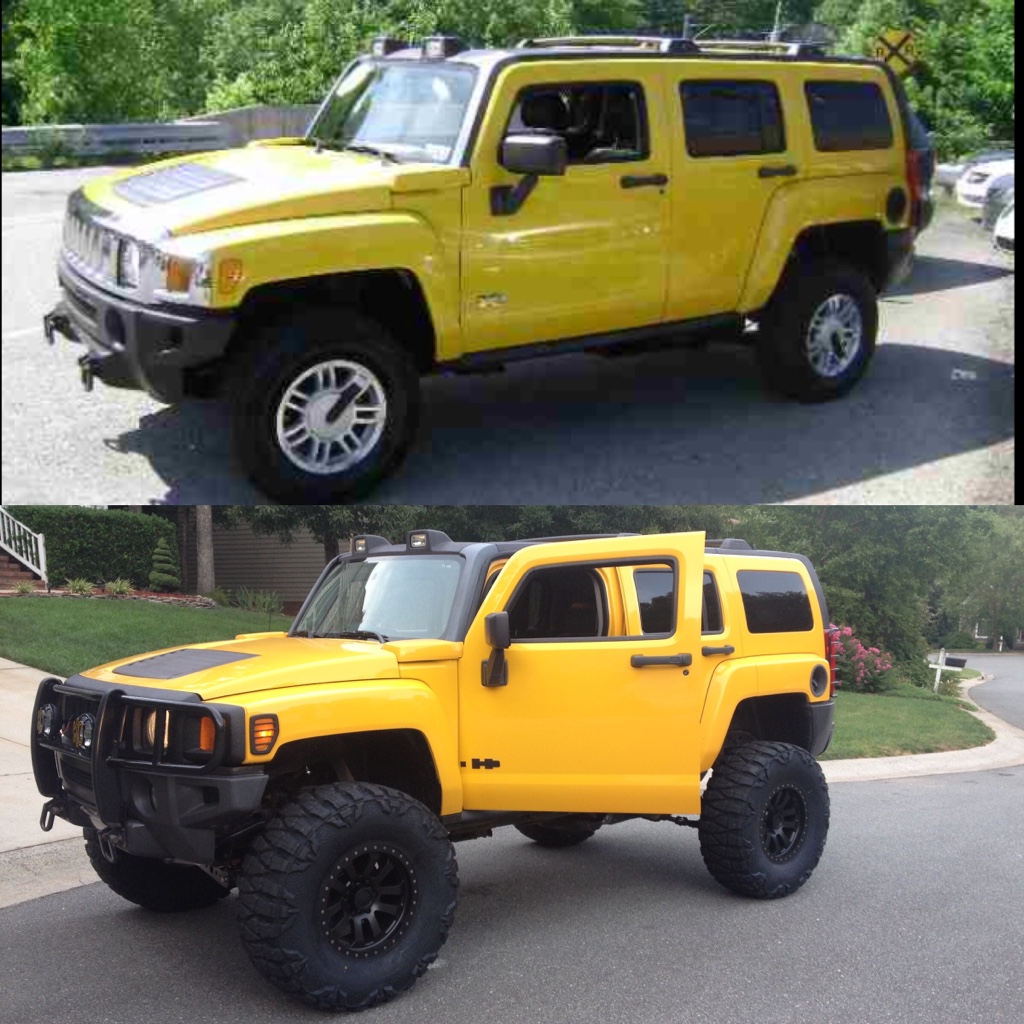

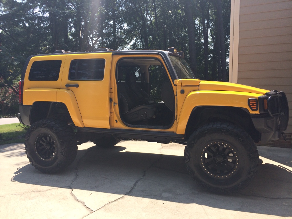

Go 40s!! Only posted pics cause I thought you have h3 and was showing what 37s would look like lol

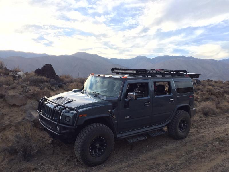

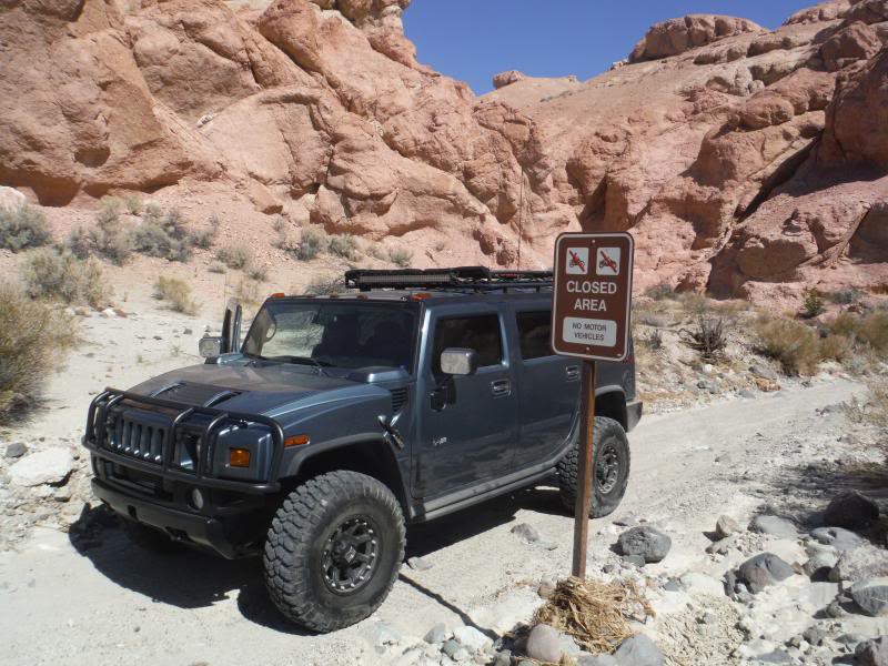

Here are a couple pics with 37's

Nice looking rig man! Just wondering, where'd you get that grill guard?
I actually scored it on Craigslist for $75, I got it powder coated and it's like brand new. I forget who made it but its a popular supplier, someone here probably knows as they were fairly common but I'm just drawing a blank. Running 37's is not an issue at all, I have a little rub in the front at like 98% turning but that's it. I would definitely go for 37's if you are gonna get new tires. :cheers:
