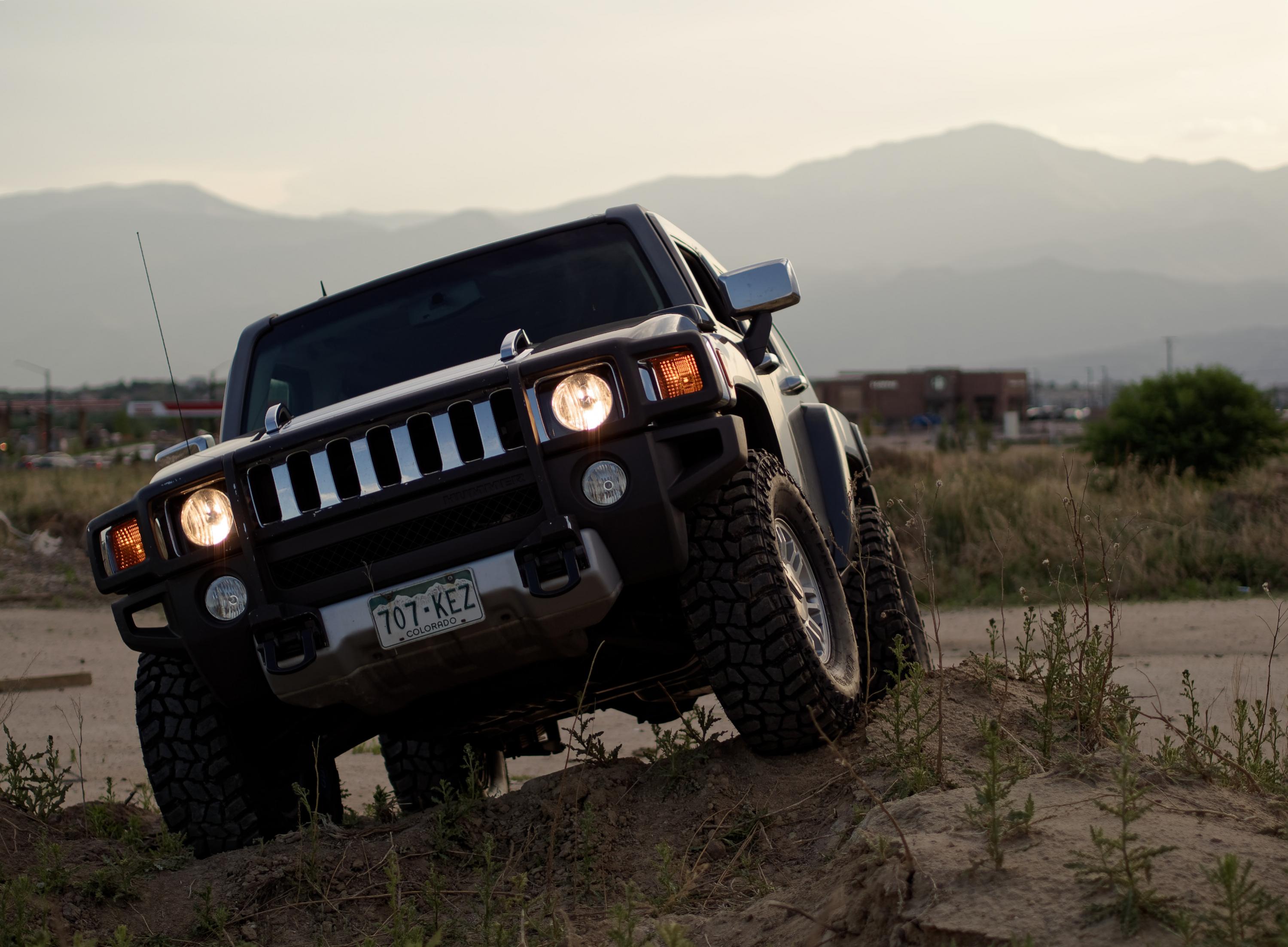

Went into my favorite Discount Tire around the corner from where I live today (been doing business with them for over 10 years). They talked me into making the transaction happen today so I could take advantage of some memorial day specials, (MIR's), and I went ahead and went for the 1 year no interest on their CC to get a couple of $50 gift cards. He made me a great deal on the tires and studs.... Similar to the best prices I've seen online for the same tires over the last few months so no complaints. Discount tire has always been good to me!
The H3 is getting 9 X new 315/75-16's. 5 X STT Pro and 4 X Studded DuraTracs for winter. I'm excited!
STT Pros will be a few days to come in but no big deal. I'll try to get some pictures posted when they are mounted.

I've taken the STT Pro's far enough down the road and trail to have some initial impressions:
Road noise is reasonable for the type of tire. Just noticeable with windows up, Easily drowned out by low volume on the stereo. At highway speeds it almost seems like they get quieter. They remind me of pretty much all aggressive AT's I've run in the past for road handling manners, as in, they don't "track" straight like a proper highway tire. Be prepared to take on more steering responsibility for the direction of the vehicle with tires like this. I am surprised that they do not exhibit low frequency "thumpy" ride at low speeds. Even my previous experience with less aggressive duratracs developed a thumpy ride at low speeds as they wore on. So far these are smoother than I would have expected with ever so slight vibration at medium and low speeds. Based on my experience with duratracs, I don't expect these to stay this smooth and quiet as they age but here's hoping they prove me wrong.
They don't seem to have any trouble balancing or running highway speeds smoothly (I've had em up to 80+).
Chalk test on these tires will have you down at <24PSI before making contact across the full tread width in a straight line test. It rides very sloppy at this pressure and with very high rolling/steering resistance on the tarmac.
I've resorted to setting them right at 30PSI cold, which keeps the TPMS system happy, provides a good balance of ride quality, rolling resistance, noise, etc.
With the 3.7L mated to the 5 spd manual I have no complaints about power on 315's that I didn't have already about the vehicle on 285's. The tire size makes very little difference here other than spending a bit more time in lower gears, which is inconsequential in a manual in terms of driveline efficiency. I still have use of 5th gear on the flats and mild uphills, dropping to 4th and 3rd for most mountain passess, with the ability to sustain somewhere around the speed limit reasonably well. Fuel economy has dropped on average maybe half a mile per gallon, but its hard to quantify as I haven't ran a full tank since putting these tires on that wasn't interrupted with some sort of unusual usage scenario that would throw off the measurement (pulling a trailer, off roading, etc).
On the trail I've been airing down to ~16-19 PSI hot, (so they probably lose a few more as they cool off at low speed), Traction offroad is excellent, but after running 3 trails they have suffered a fair bit of chunking on the outer lugs and the biting edges on the outer lugs are all pretty much rounded/chunked out/over. The center lugs have held up better. Very minimal tire spin in all 3 trips, but in the tires defense, 2 of those trips were on some of the roughest, rockiest trails any "normalish" SUV with skid plates, rock sliders, and lockers could ever go on. Chinaman Gulch and Holy Cross.
The 315 size is very hard on the front end of these vehicles for trail use. After running the first trail, the front diff crossmember bushing went out, and a steering tie rod inner joint developed play. The second trail wiped out a steering rack bushing and took it out of alignment again, the 3rd trail broke a half shaft, which I replaced on the trail, and also threw the front end out of alignment and has play somewhere (haven't found yet). I drive as slowly and carefully as possible over obstacles, often slipping the clutch at idle to ease it over stuff. Only using the gas pedal on spots too steep to pull through without it.
Bottom line... 315's look great and DO give this vehicle some serious off road capability for what it is. That being said, I'm not sure the 1/4 ton front end on these H3's is up to the task of tires this big. So far it is reminding me of my isuzu, requiring front end repairs and realignments after every trail.
