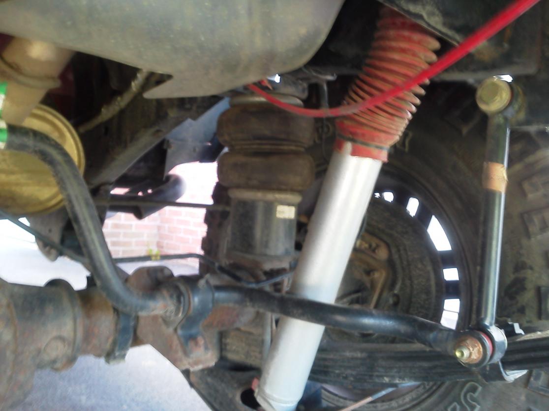

Rancho performs well, rear springs are weak far as weight is concerned so I added airbags. IMG_20110909_144754.jpgIMG_20110909_144809.jpg
