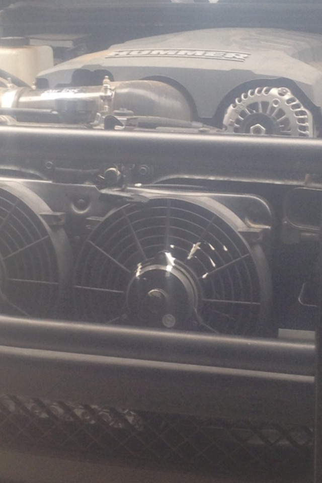

Just installed my dual fans but ran out of time to do the wiring!! I will wire up this weekend .. I haven't decided if I want to wire to the ignition or to a switch!! What do y'all think???
I did not take pictures of the beginning stage because we all know what it looks like behind the grille.

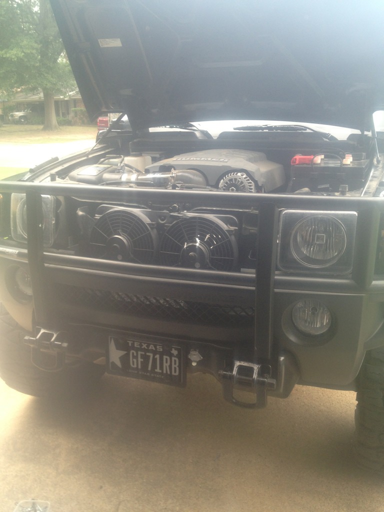

Here is the final product without grille..
To mount, I had to reverse the horn mount and notch the top of the fan to allow the release lever to swing free. I also had to notch the bottom and cut 2" off the plastic shroud so the fans would sit smooth and would not sit on my light bar.. I mounted to the center beam that runs down the middle of the radiator..
