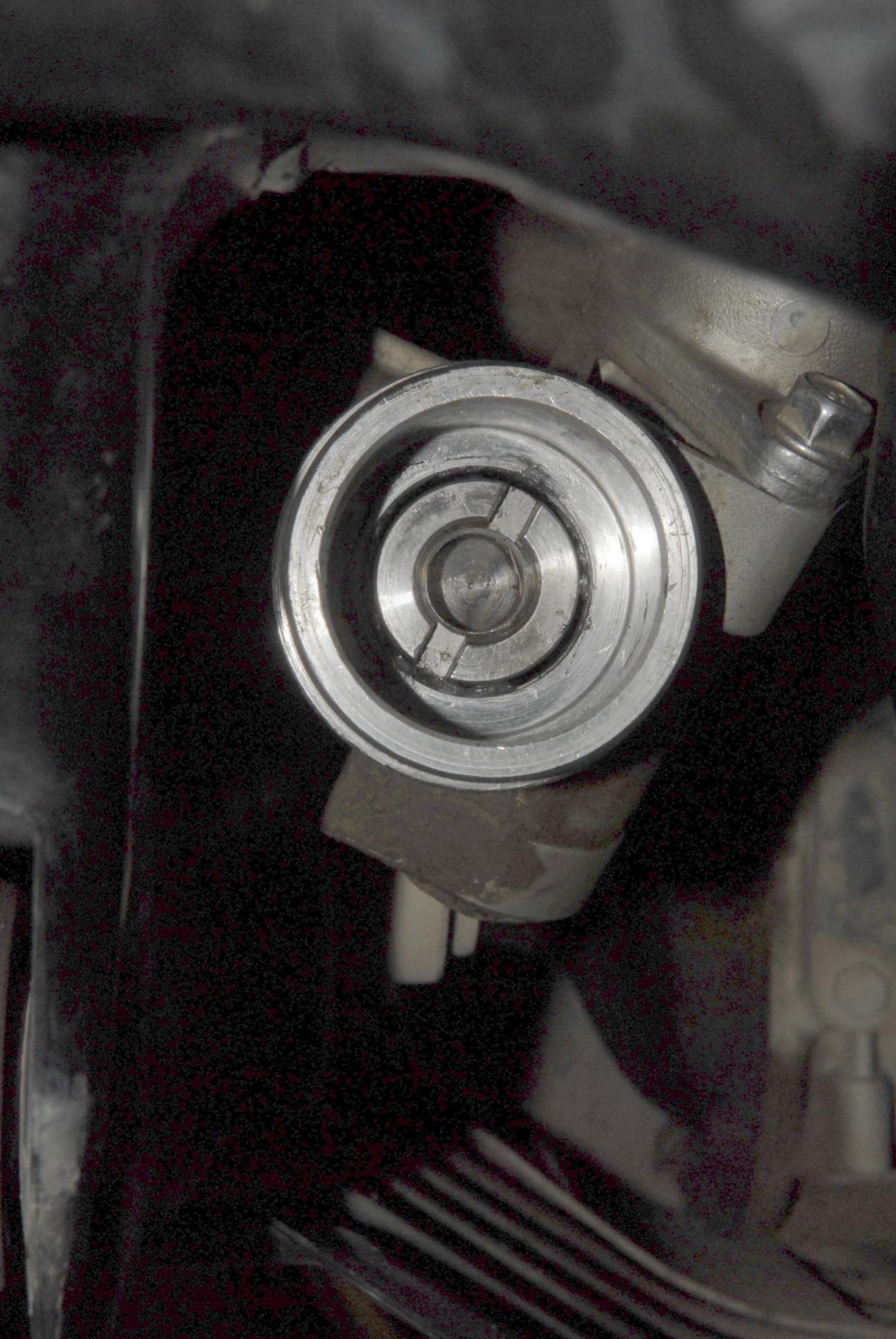

It is probably the seal in the end of the rack. That would be hard to replace without taking the rack out and making a tool to fit the slots. Not even sure about the availability of a seal specific to that.
It's possible a good hydraulic shop could repair it but guessing it would cost as much as a rack.
Until the supply of racks goes away,
If your mileage is high it's possible the other end may go.
With tie rod removed it looks like this with the seal way in there.
I will attempt to upload an image direct to the forum.
