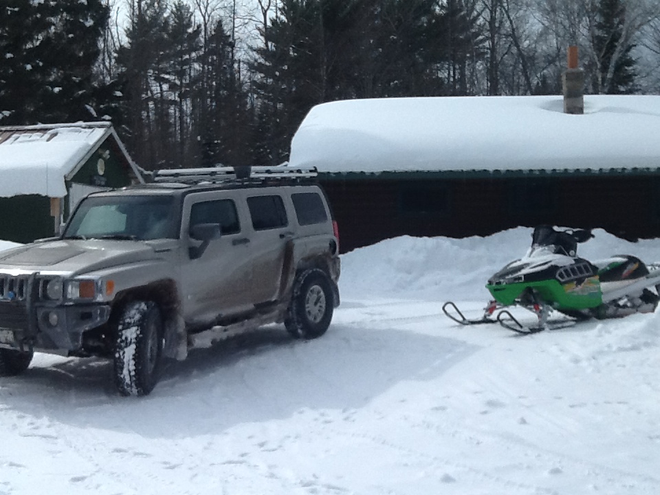

I have the Gobi full rack and I have a sun roof, I never stick my hands out the roof anyways when driving and I prefer the extra storage.
