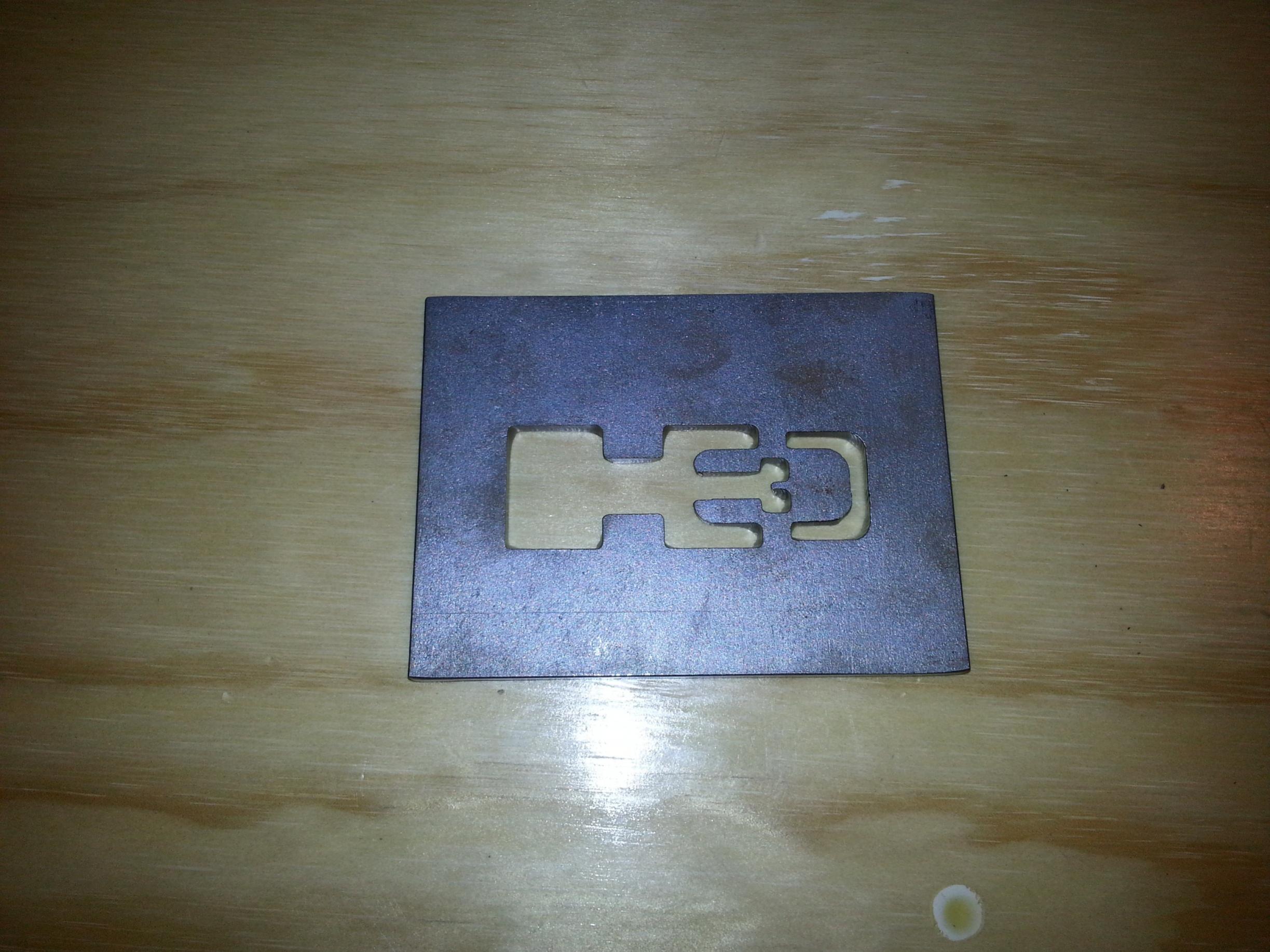

I need to give Knight Metal Works some credit. I want that rack but shipping is killer. I did buy his mounts with the H3 logo, I started to use them but I put them in the brake backwards and bent them the wrong way, they will be used for another project though. I will be adding all the extra mounts for lights, jack, shovel, & etc.

How much where there mounts? I didn't even think about buying theirs, to me the hardest part was making a decent mount.
Now I've never done that! I don't have any backwards brackets sitting in my shop at all!!! :confused:
Sent from my C811 4G using Tapatalk
2,830
I plan on using them for spacers between the top and bottom rails.
