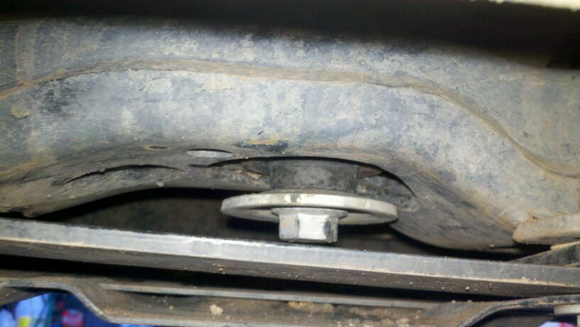

Could be a worn crossmember bushing.
Both CV joints swapped out...same noise...noticed cross member bushing was shredded on the bottom...it looks like it is missing something...could not find at parts geek...anywhere else I might be able to get one??? Is it as simple as pulling 4 bolts and dropping the crossmember???

This is from another members photo...exactly what mine looks like...could this be the source of the popping popping while under acceleration and turning???
10,673
Usually the diff mount noise is strong, less from turning and more from torque applied or unapplied from the engine. When torque is applied, or released, if that bushing is broken then the diff will slam against the crossmember.

I only get the clanking/popping under torquing conditions...perfectly smooth on the highway...
Outfitter Design makes a bushing kit. Scorpworks has a crossmember exchange deal. Both can be found in the Sponsor section.
Outfitter design sells the bushing kit that you can instal yourself. The dealer doesn't provide the bushing only, it comes as part of the crossmember assembly.
I have the O.D. kit and it solved my problem.
