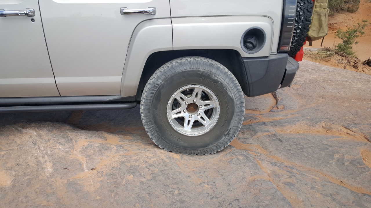

Very happy with the SOA. New measurements are 26.25" at the rear and 25.25" in the front center hub to bottom of fender. Very happy with the flex too. Got to really test it out at Moab this week
Here is almost full compression, maybe another 2 inches up.

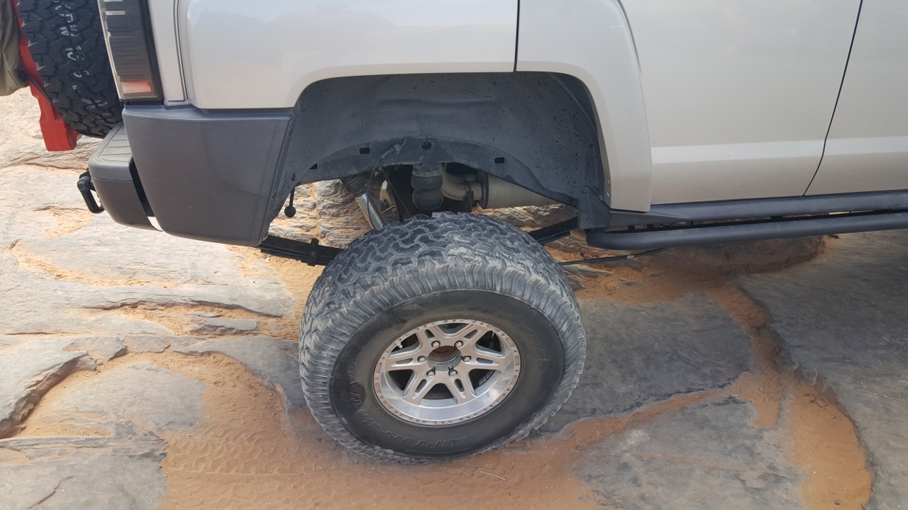

Here is almost full droop.
