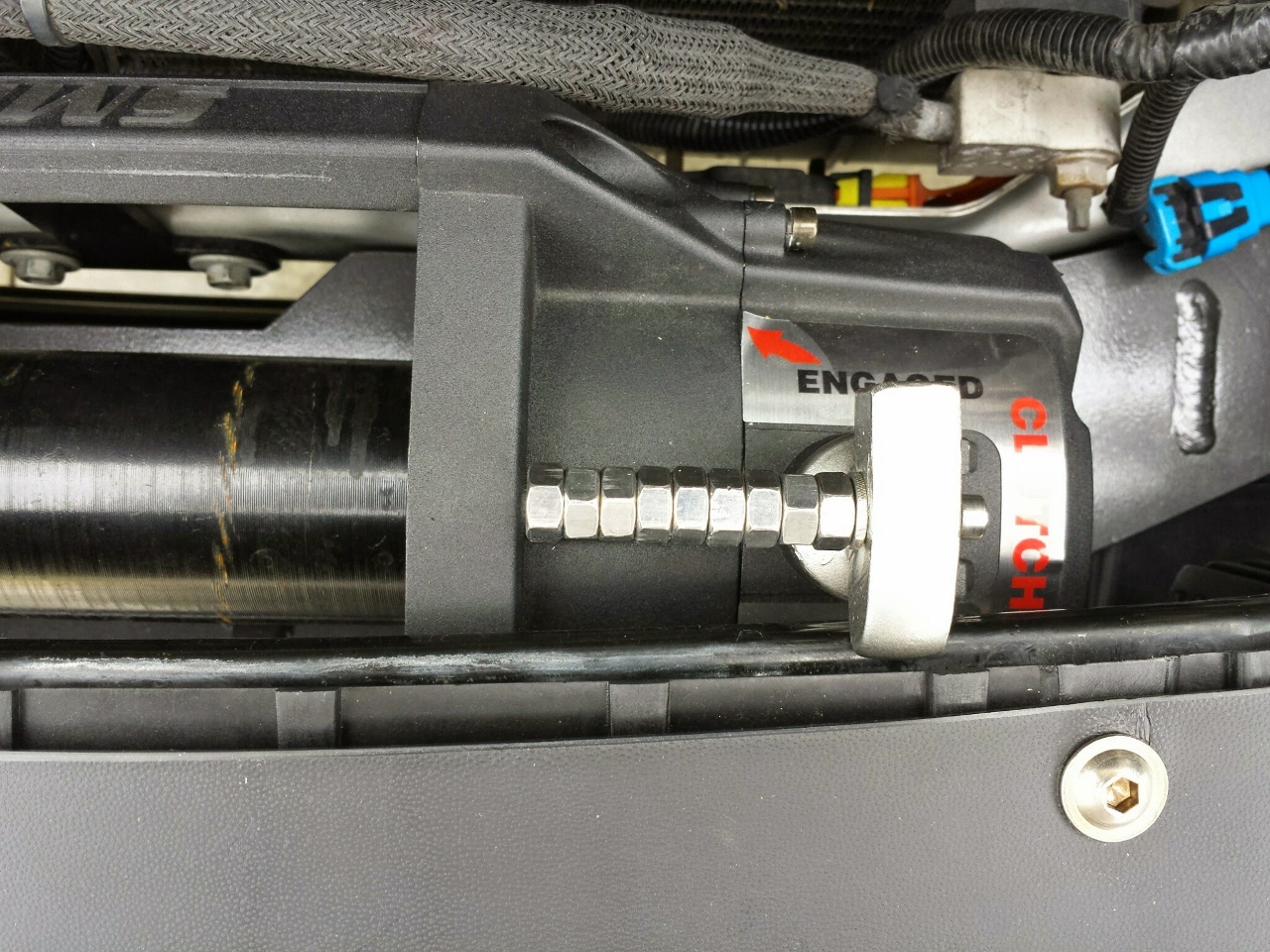

So I finally got around to start my install of my Schwarttzy hidden winch. I have had a very bust weekend schedule with kids in sports and work. It is only half way done but I should have it completed no later than Thanksgiving weekend, the last weekend of my sons football.

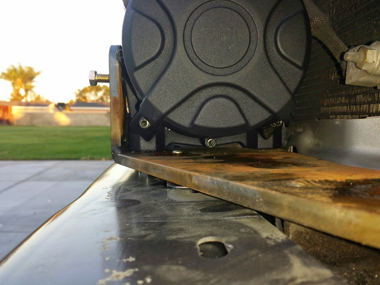

I was going to buy a Smittybilt 10k but there was some miss-communication at 4Wheel Parts and I never was notified that they ordered the older model. They fixed it by giving me the new model, X20 12k, instead. Great customer service.
Fitment is tight but it seems that it will work. Front of winch touches the mount and the back feet touch the core support but I didn’t have to pry it in. I haven’t mounted the bumper yet, just a dry fit so I don’t know if there will be any trimming needed.

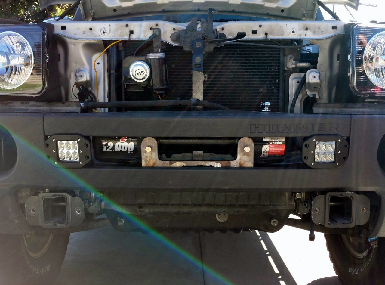

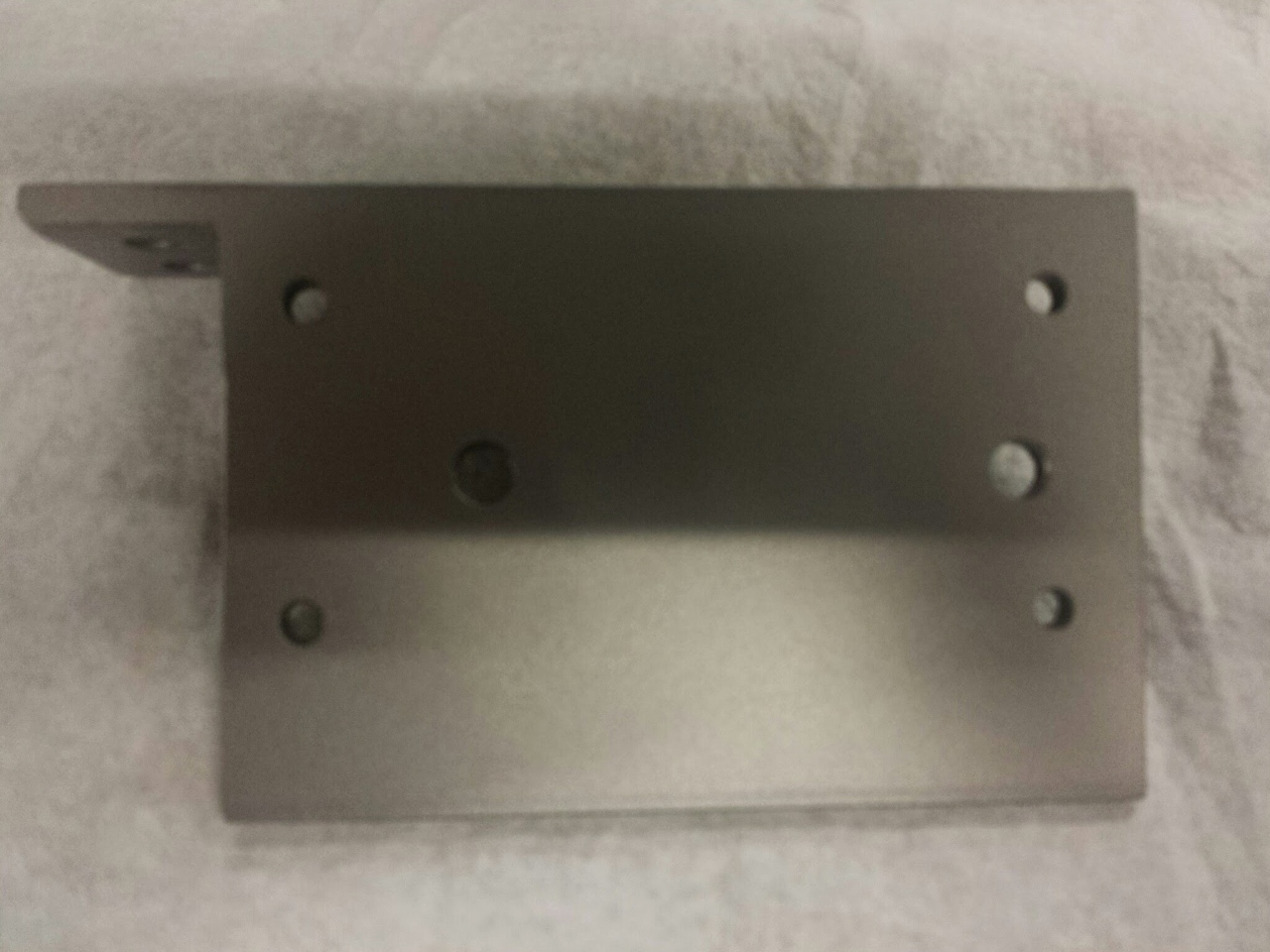

I ordered the mount plain because I want to mount some LEDs in the grill next to the fairlead. I am unsure if I am going to add a bracket on the mount to add regular LED's or add a piece of sheet metal where the plastic grill goes and add flush mount LED's.

I'd put a set of LED's hidden behind the grill mesh, would look nice and stealth!

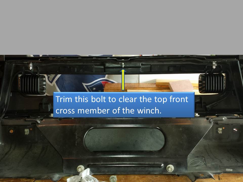

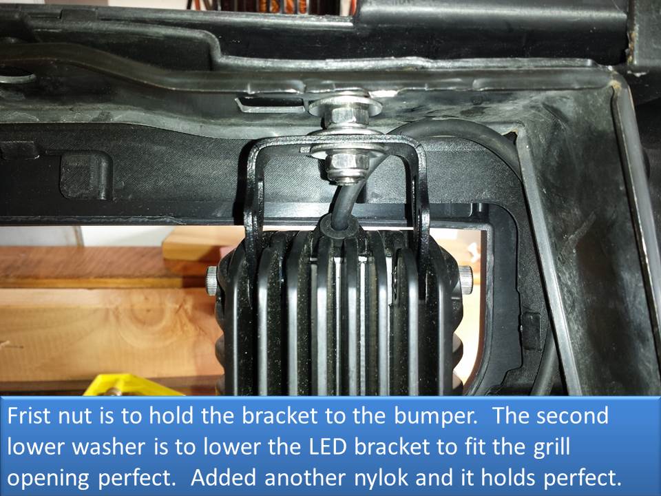

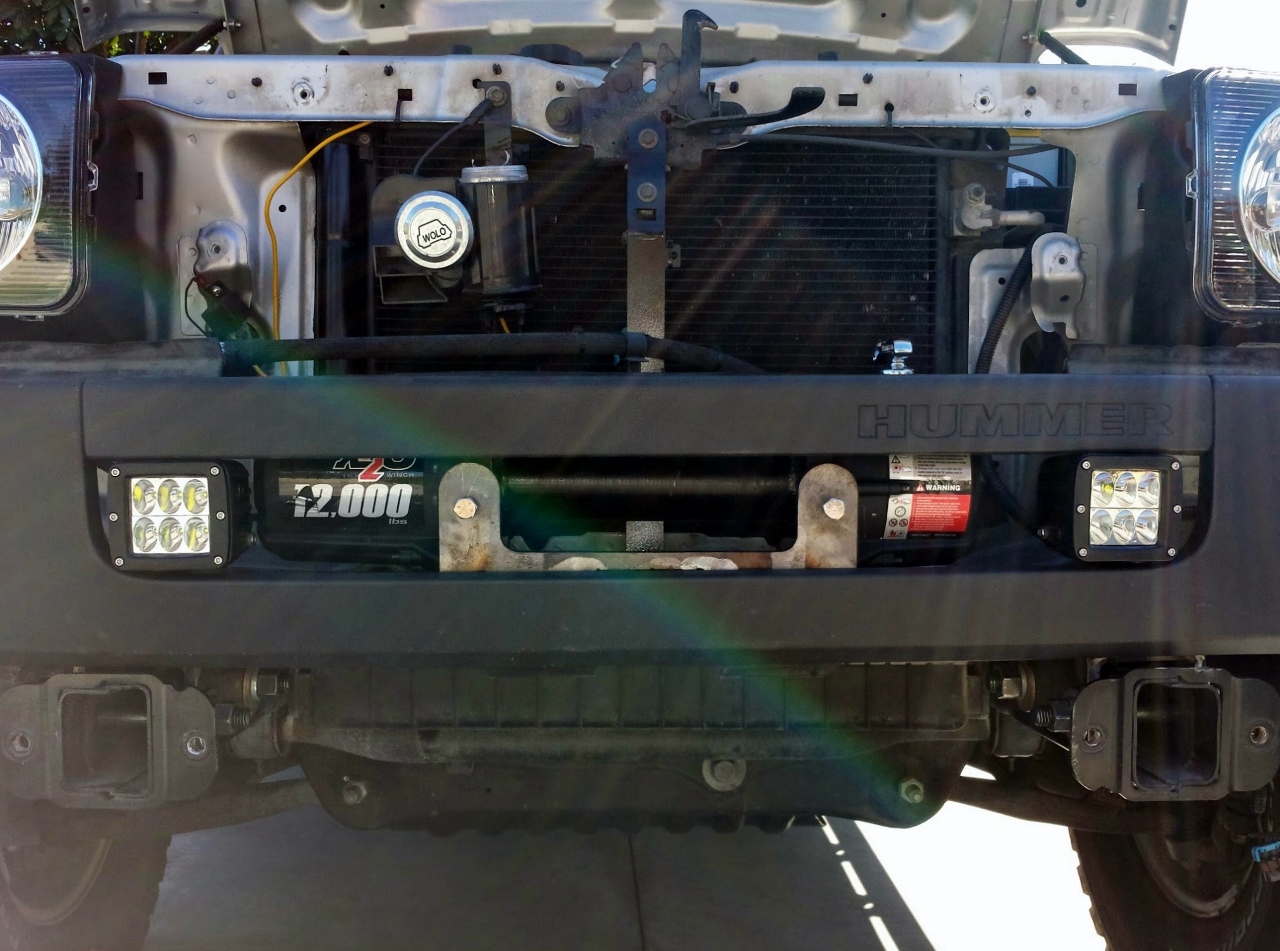

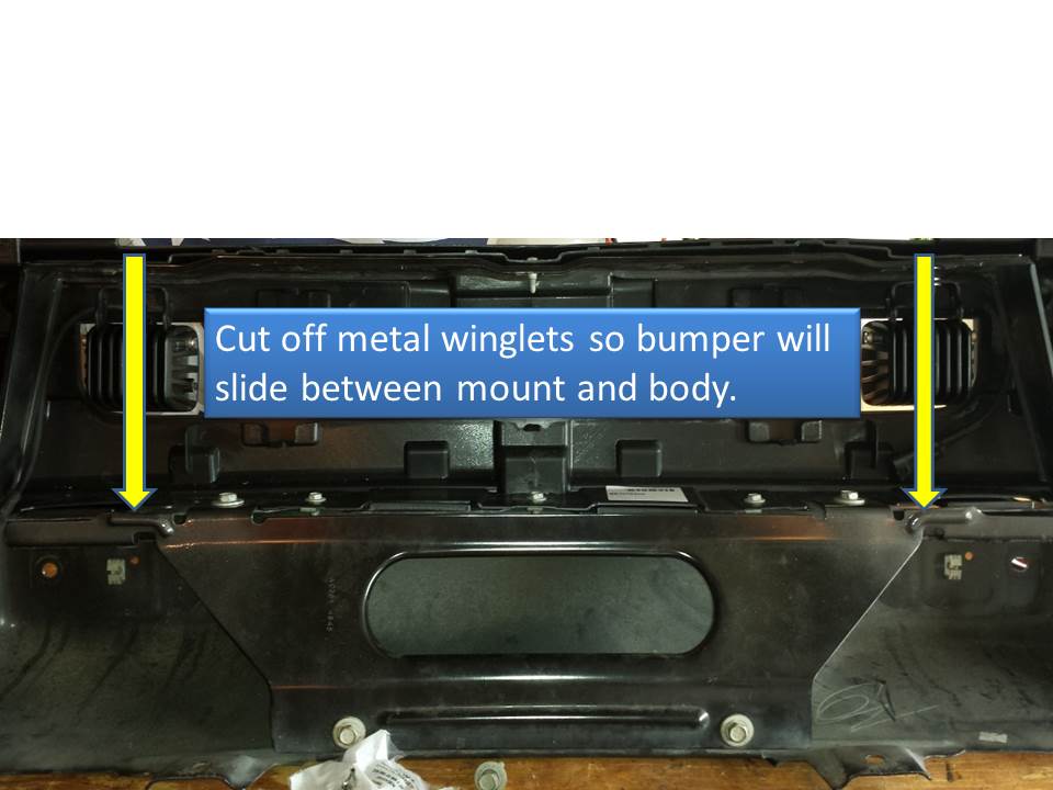

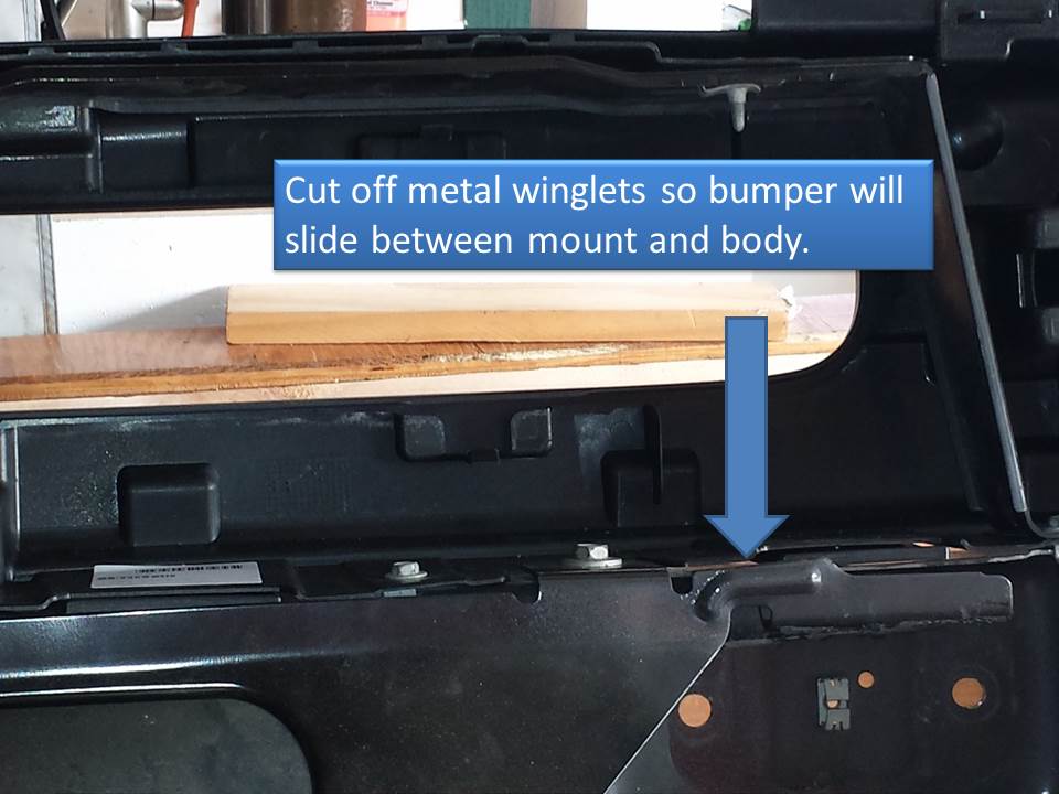

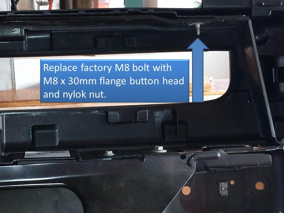

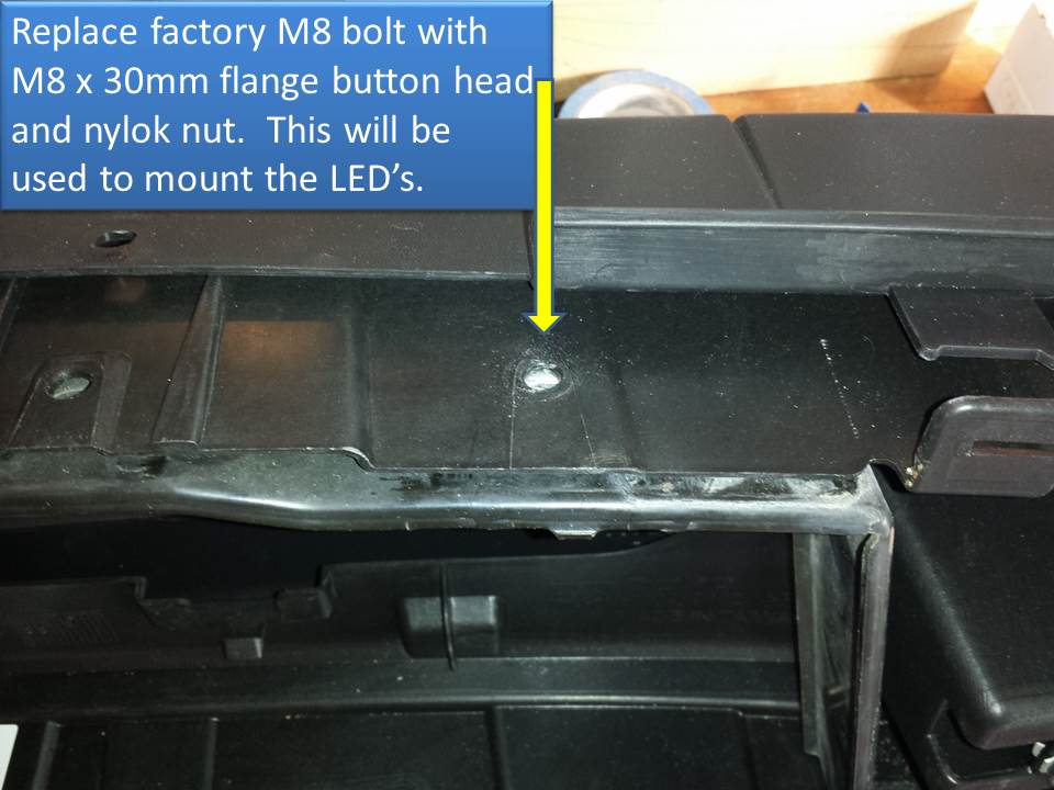

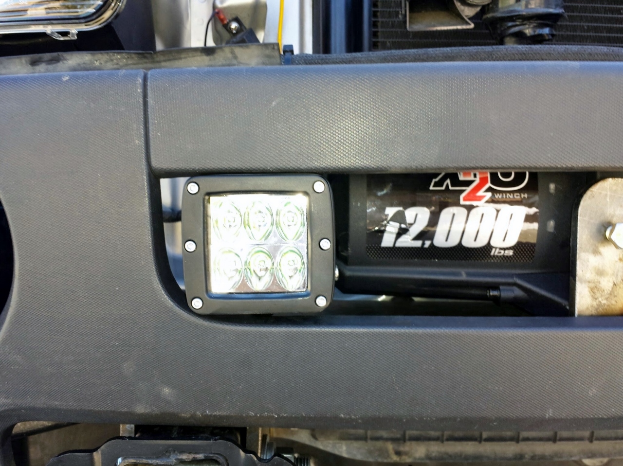

Made some more progress this weekend. I did have to make a few small mods but nothing big. I did find a bonus though, the metal support bar behind the plastic bumper has a great location to mount the small square LED's.

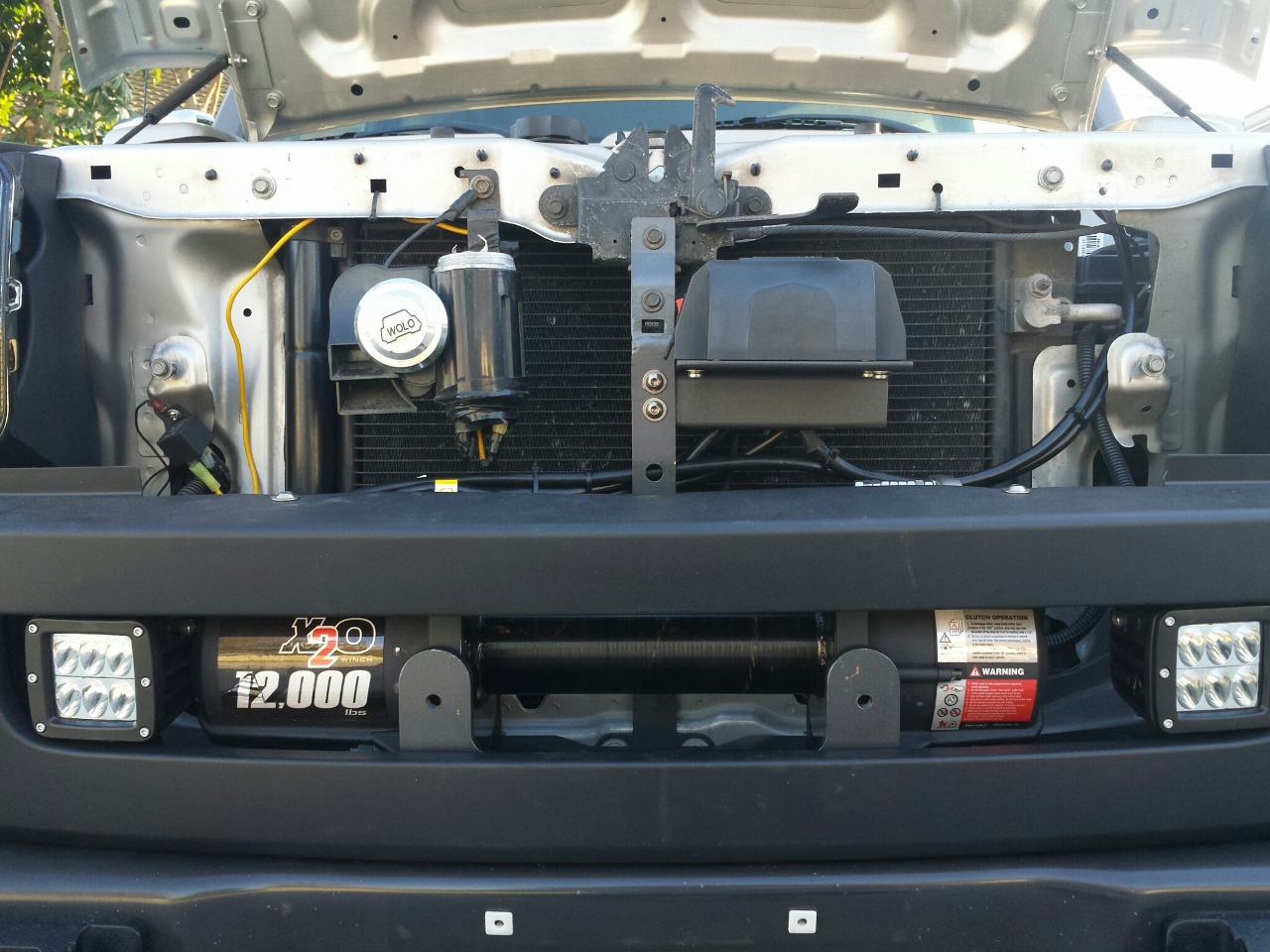

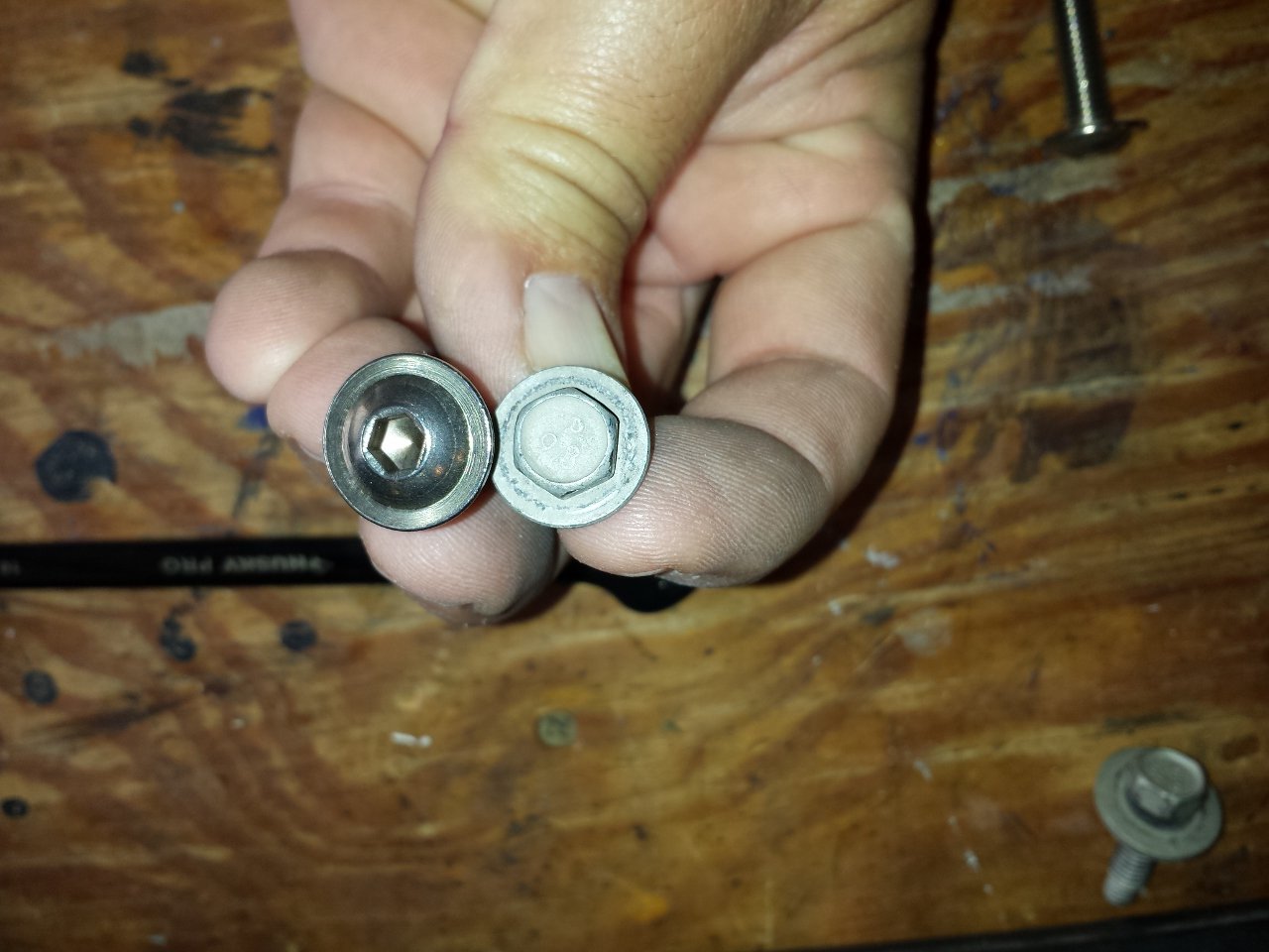

Mounting is perfect. Now pull it all off, paint the mount, then re-install it all. I did use some of the shorter M8 stainless bolts I had to replace the plastic body rivets.

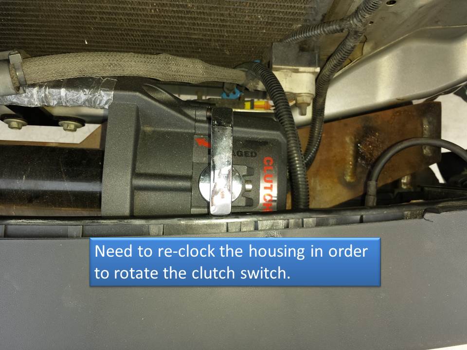

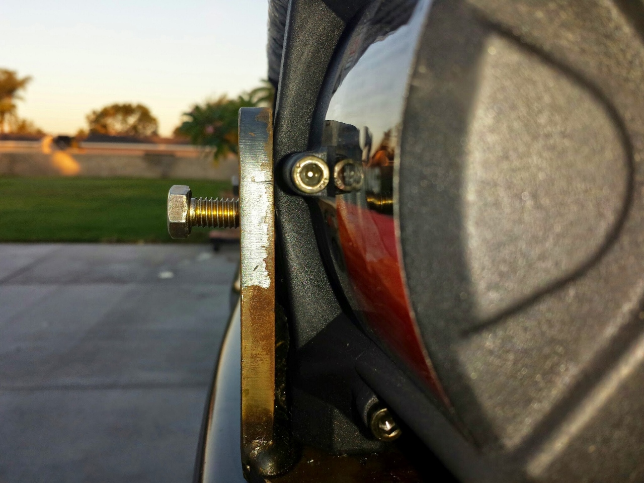

Ran in to a problem today. The Smittybilt only clocks at the 12 or 3 o'clock positions. Clocked to the back and it hits the AC tube. May have to trim level down.

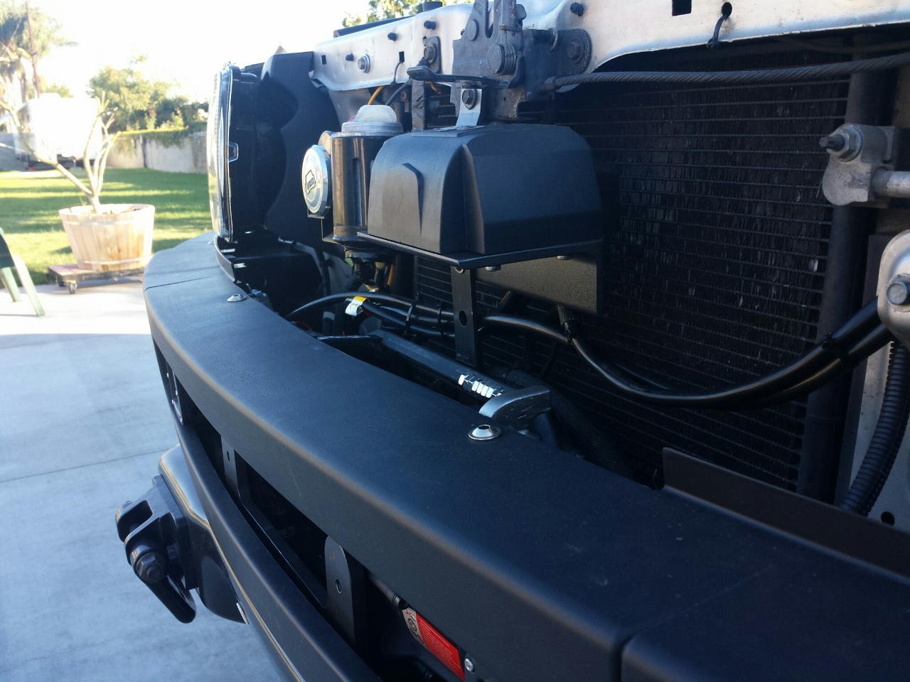

Update, so my work and family schedule allowed me to spend some time this weekend to work on the winch.

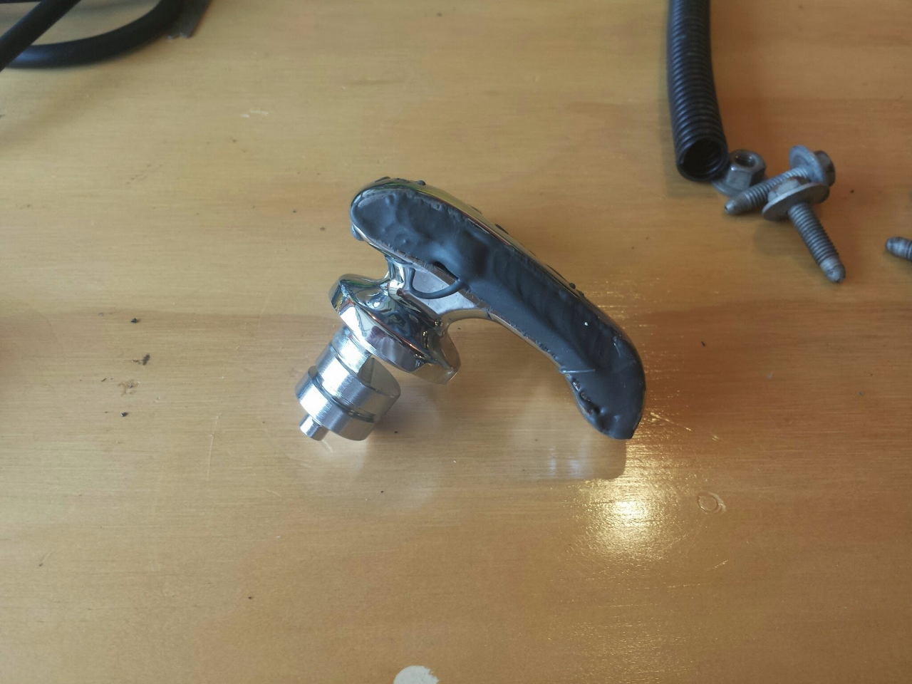

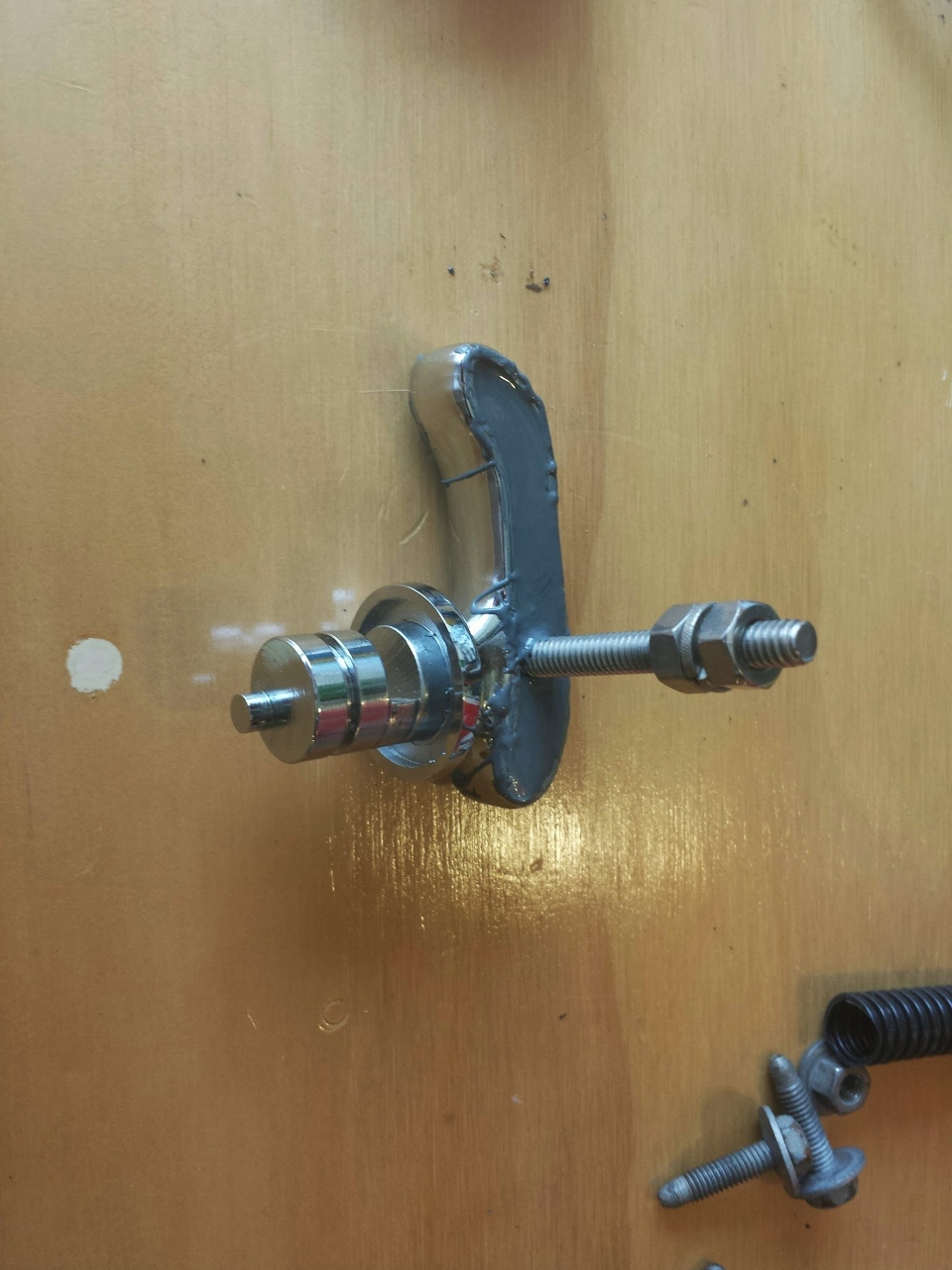

I had to modify the clutch handle so it would not hit the bumper. I added a 1/4" bolt through the side of the handle, filled the recess with JB Weld, cut it down, sanded it and painted it. Now it works great.

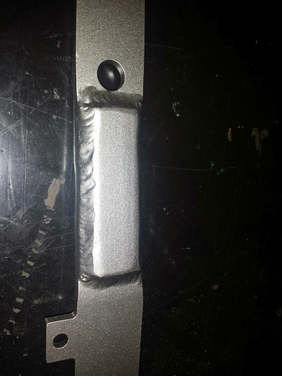

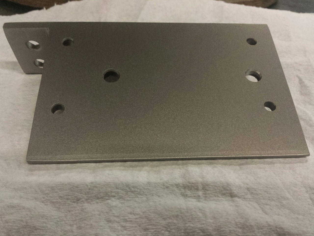

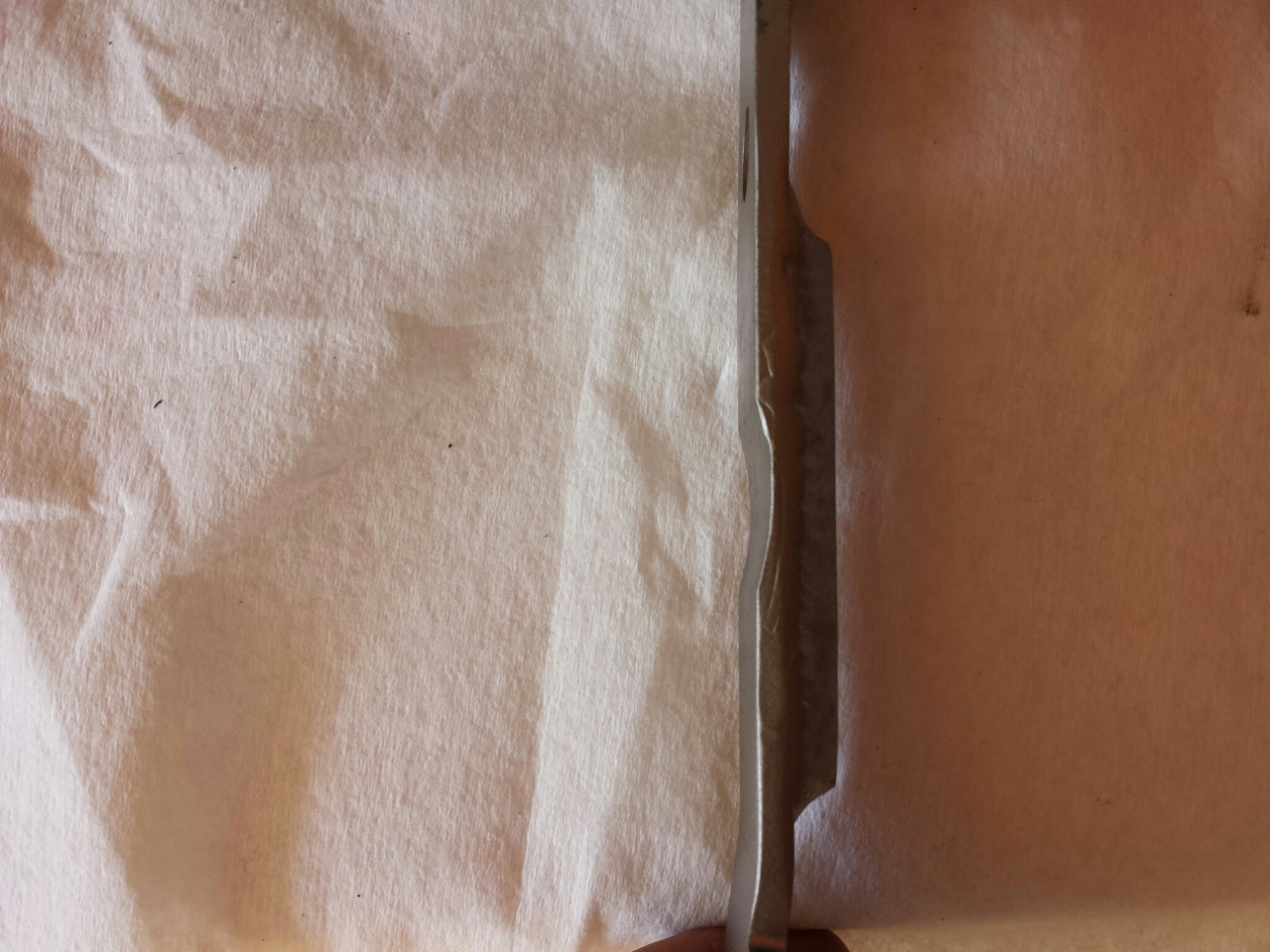

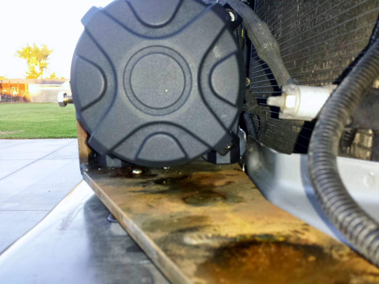

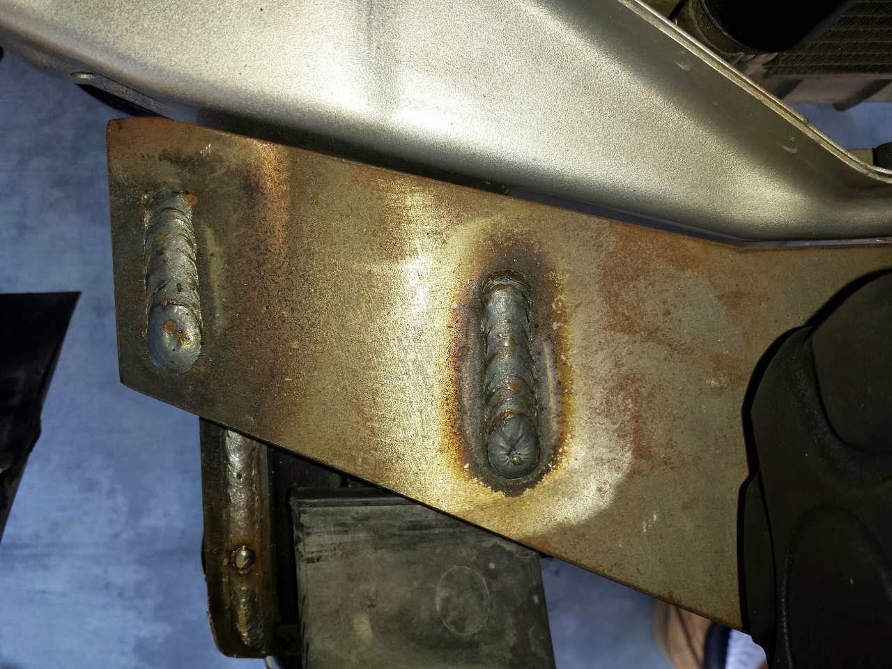

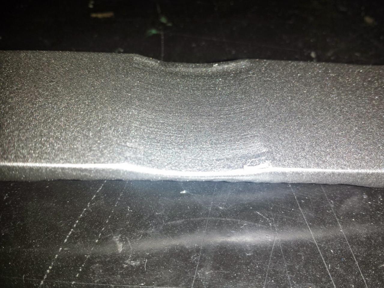

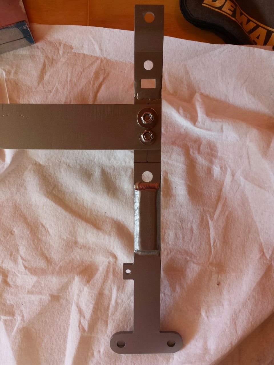

Update #2 for today. I had to make a small modification to the core support bracket. The backside cross support from the winch was rubbing on the bracket. I didn't want it to wear down to a weak spot and rust the bracket. I welded a support to the backside and ground down a recess to give some clearance.

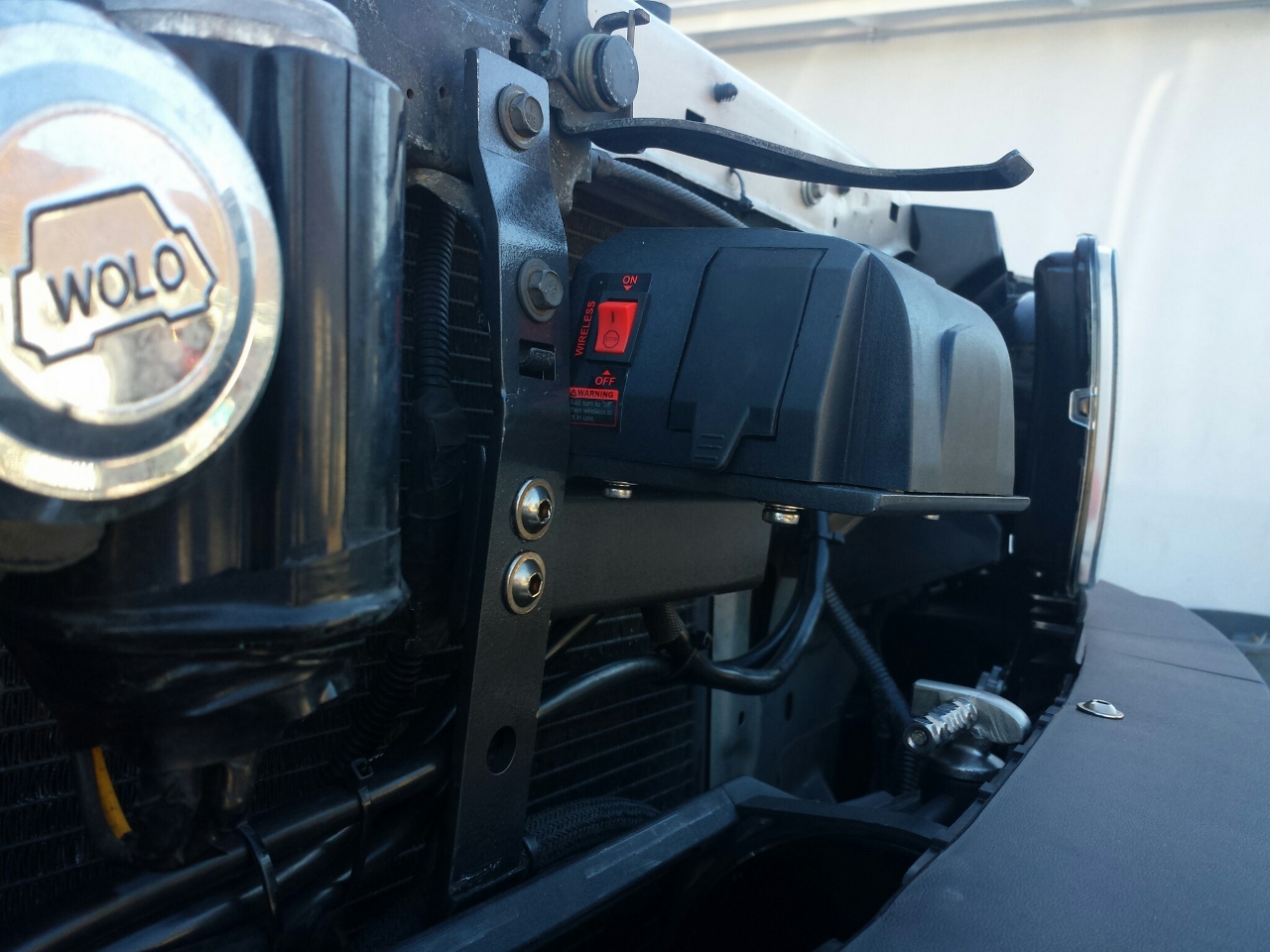

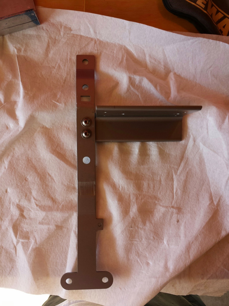

Update #3. Installed the controller behind the grill. I wanted to mount the controller as close to the winch as possible without making all new wires. I got a piece of 4x2 aluminum channel and made a bracket to mount it to the core support bracket. Sure glad I took the time to plan it out.

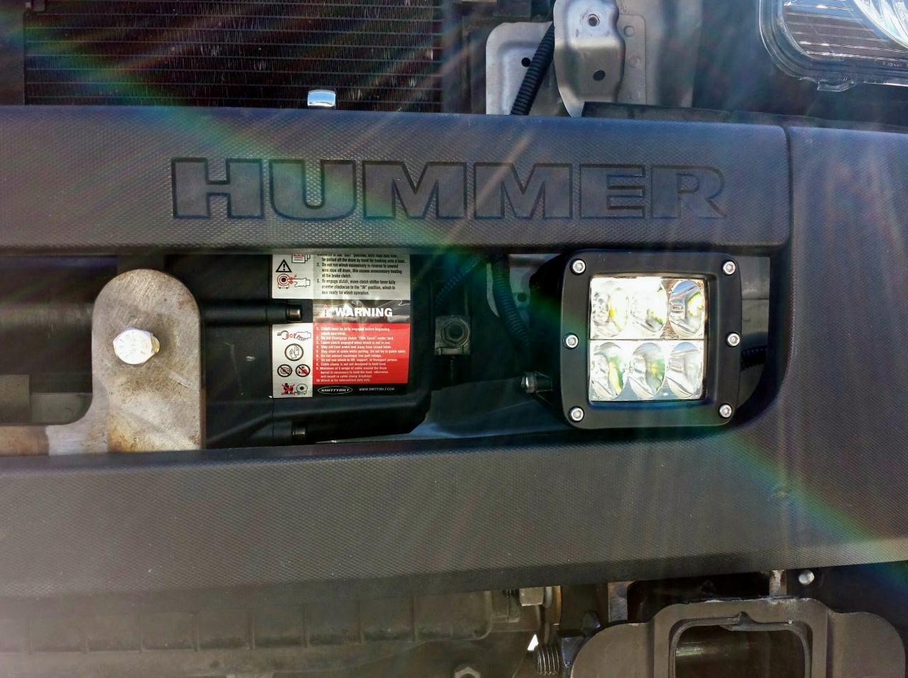

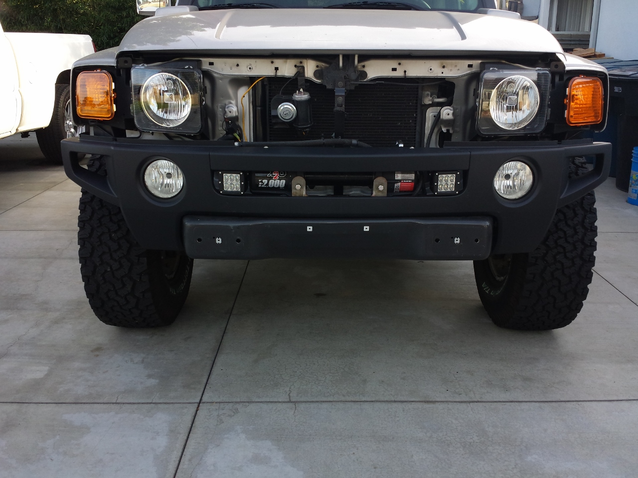

2,837
So it is now all wired up and runs like a champ. The controller is easy to plug the remote in, wireless is even easier. Last step now is to machine the Hawse fairlead down so it will fit between the plastic gap. Should be done this week so I can spool up the line.
