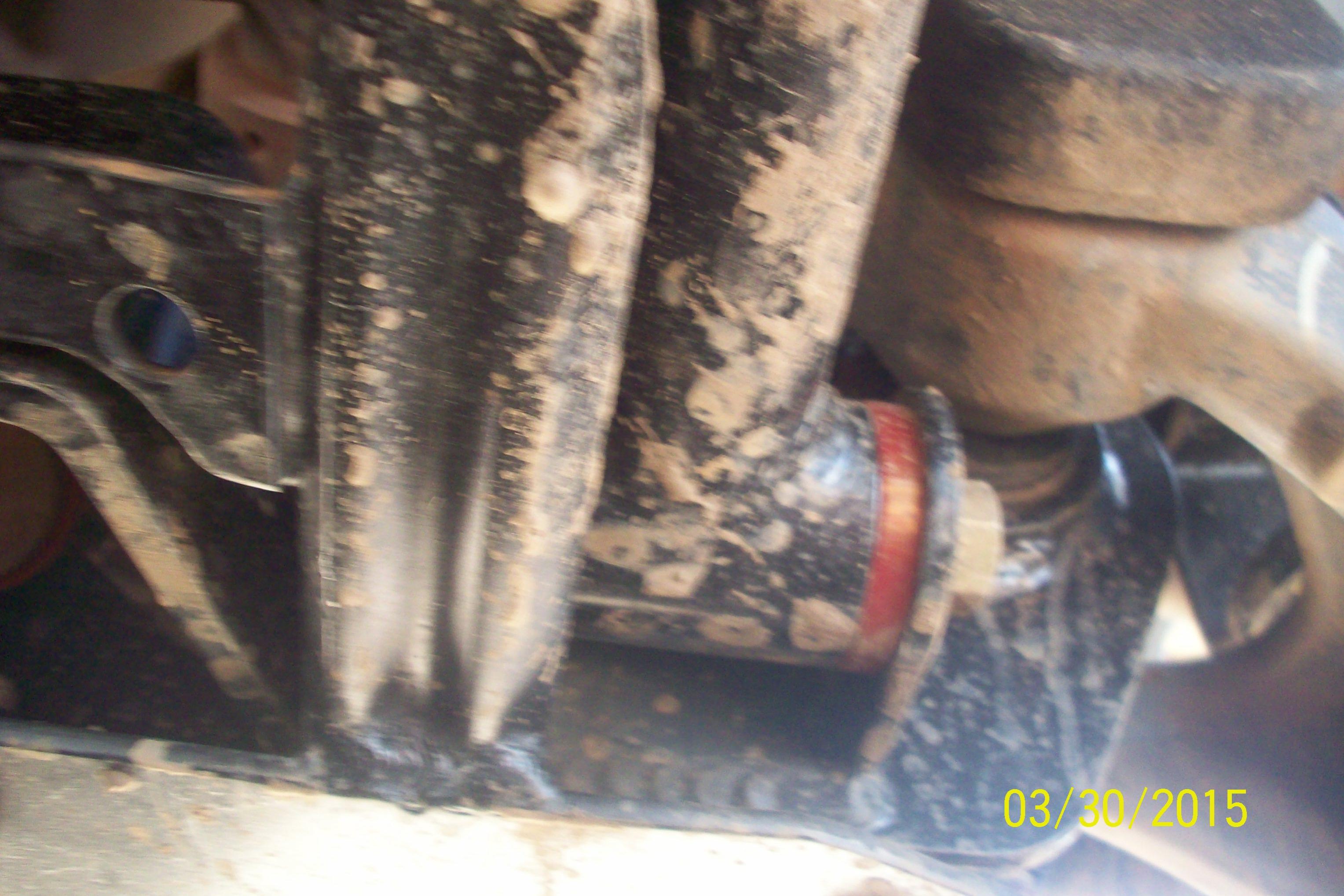

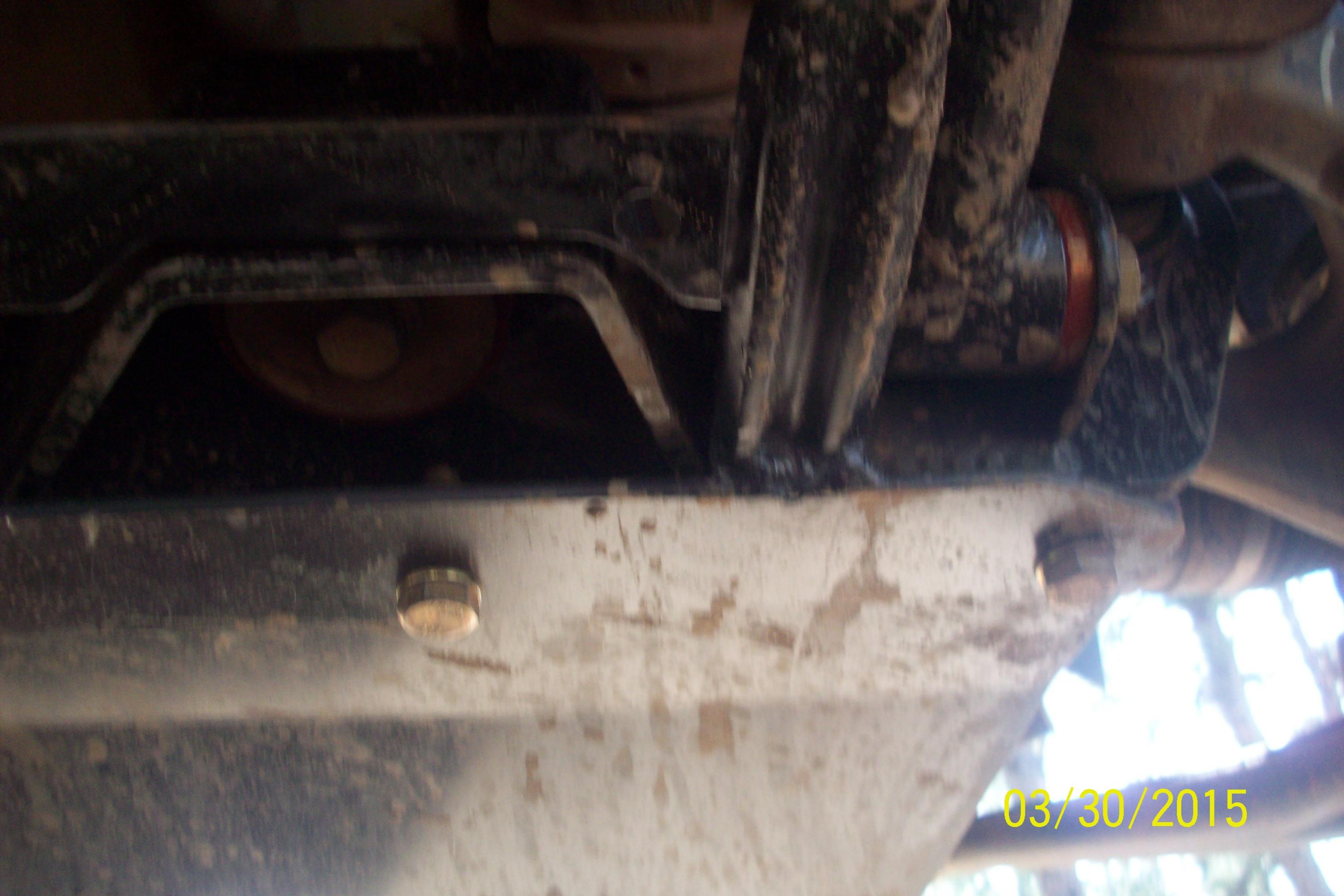

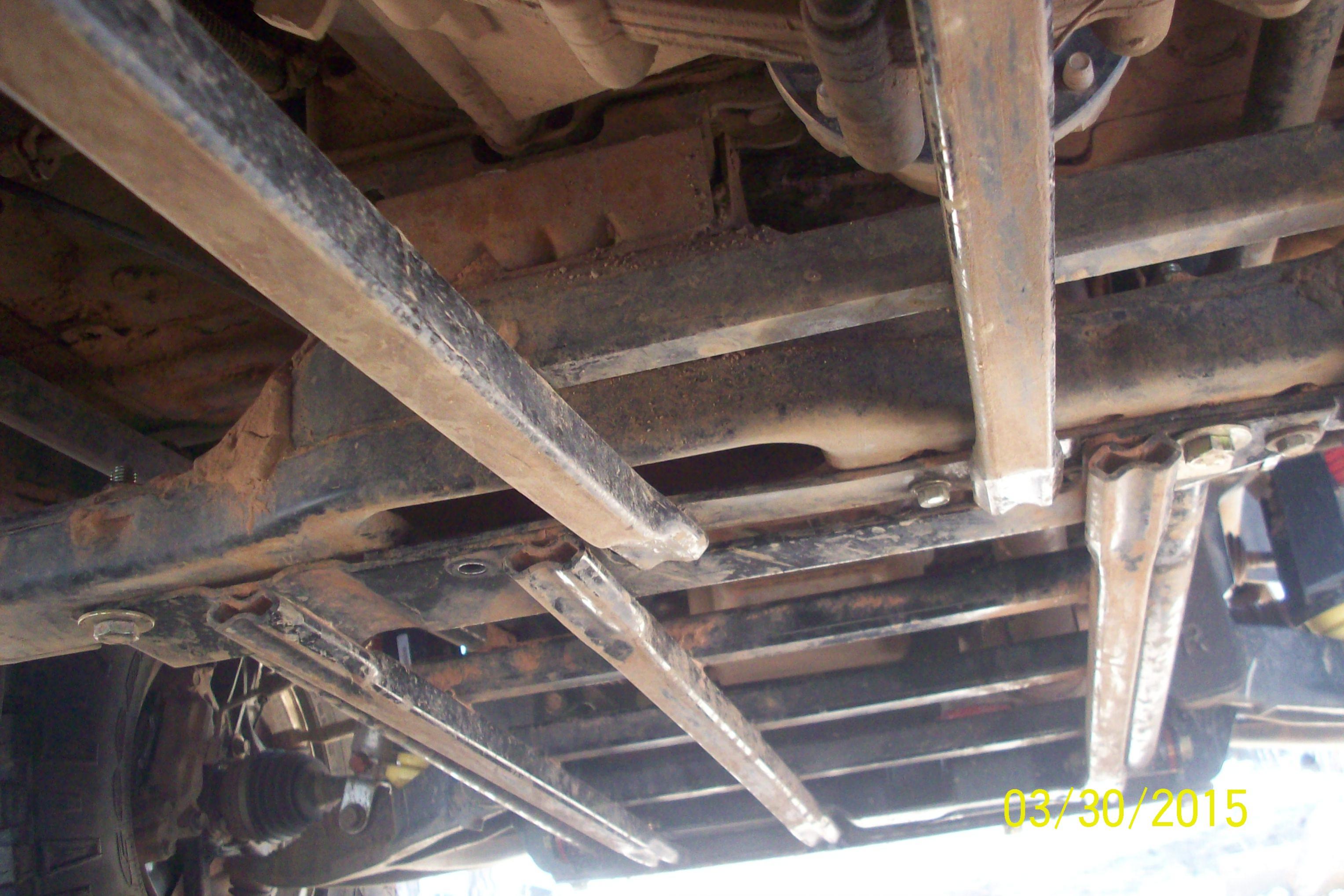

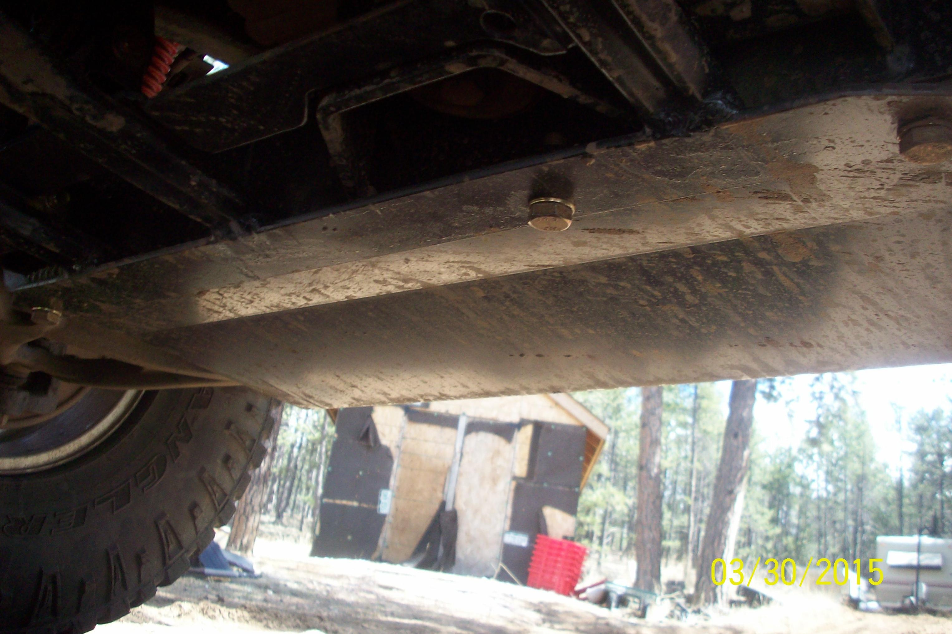

Yes for the back half and the front needs to be modded...Its alittle hard to see, hope it helps
