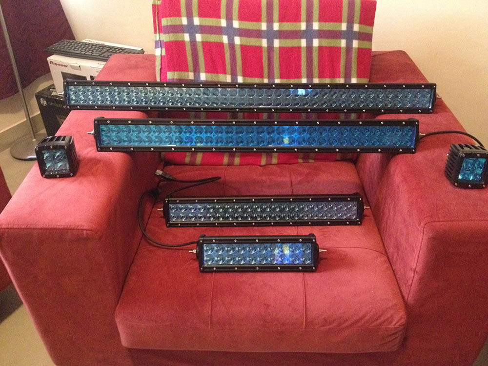

I need to get this out of the way, LED lights arrived and I'm super excited
