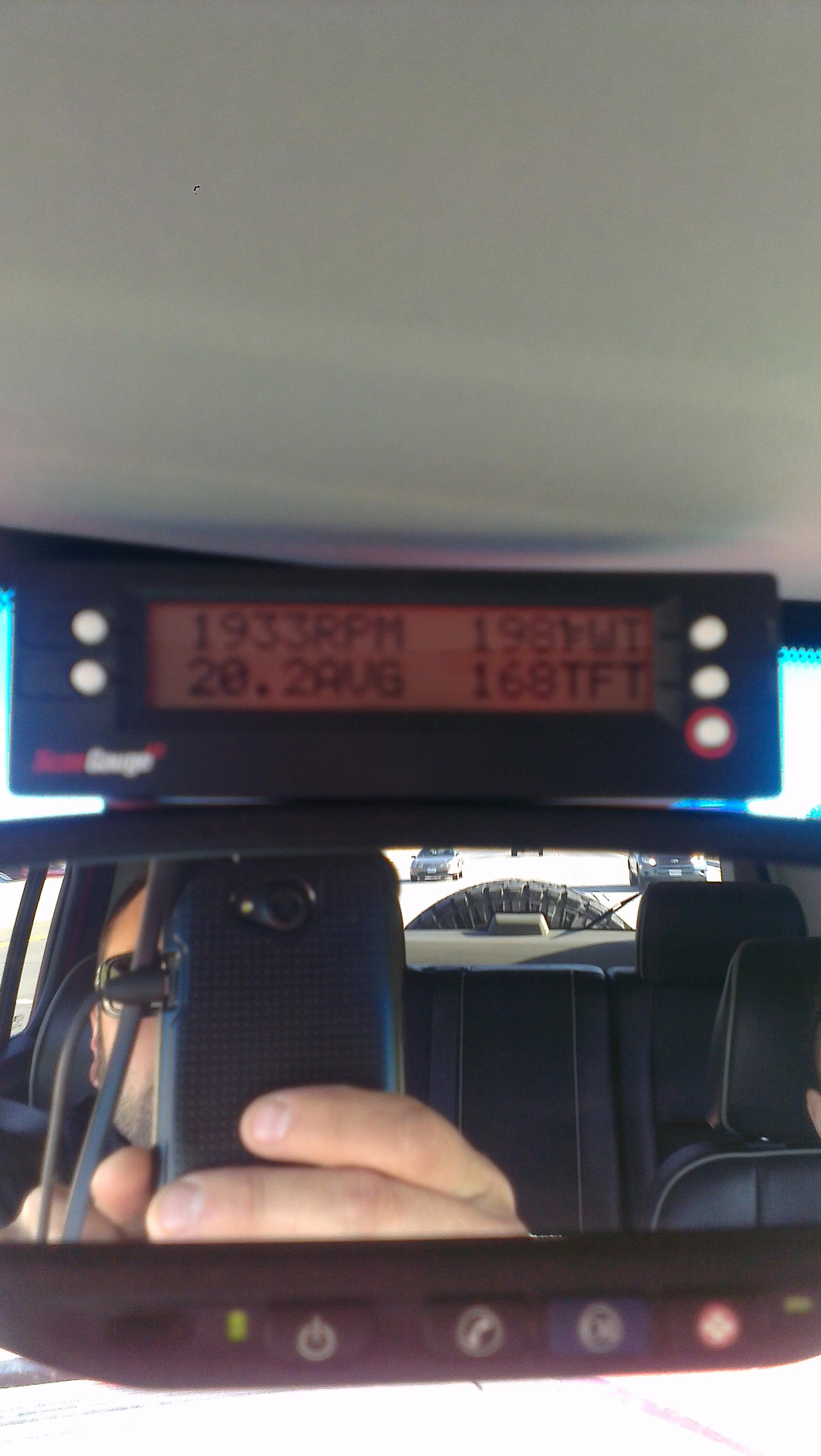

17+ HOLY CRAP, I would drive like even more of a granny than i already do. Where can i get a scan gauge? That seems pretty useful.
digglesworth
1,789
illinois
IMAG0716.jpgI picked mine up on amazon for like $130... Search "Scangauge II"... They do a LOT of stuff. You can program in the code to monitor trans temp too. I got a mount to mount it to my rearview mirror... They plug straight in to your OBD port...
