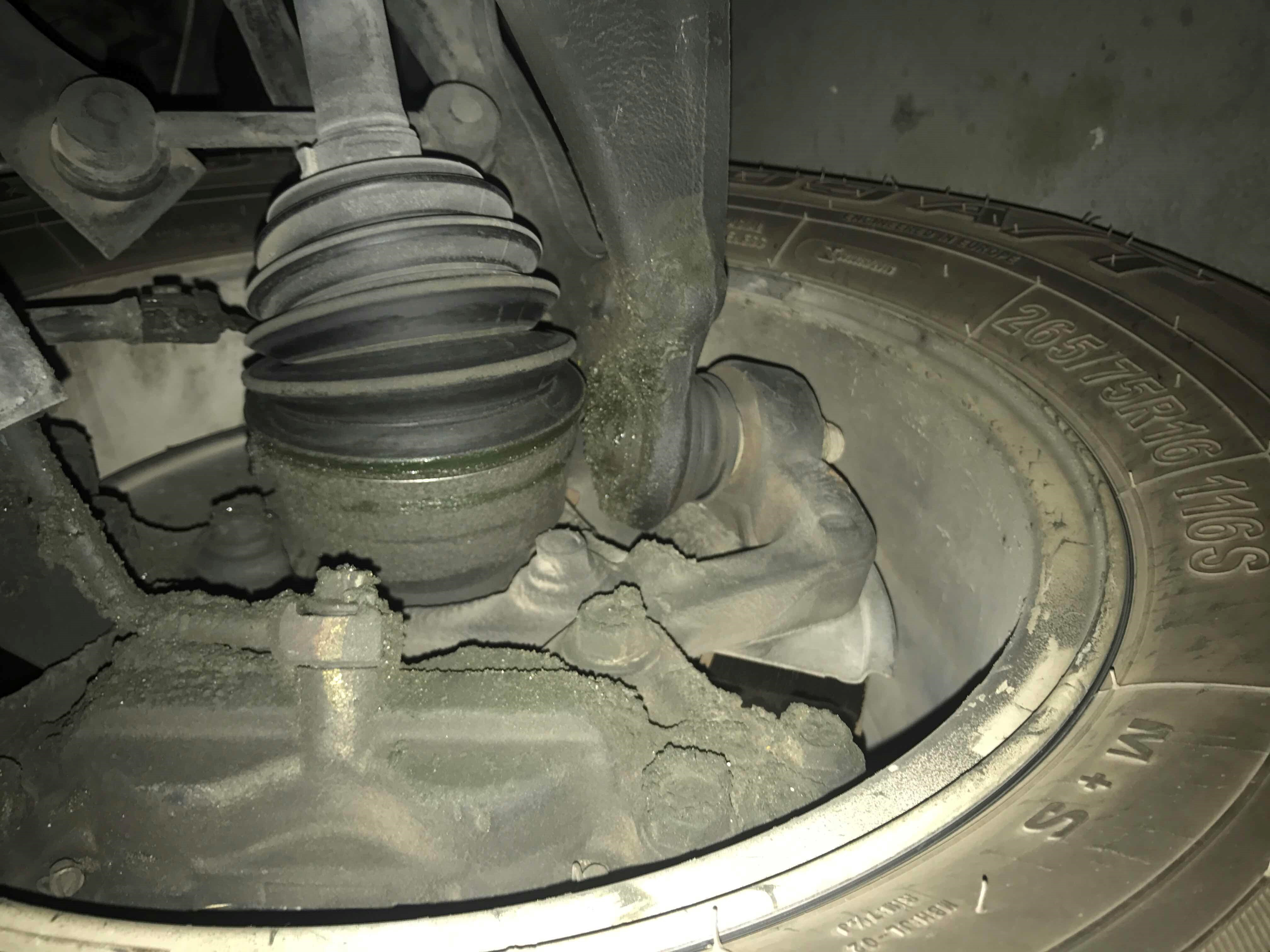

And leading to premature failure of the CV axles, steering rack and possibly even diff internals. Don't over-crank the torsion bars.
I understand.. so that's probably why this happened, right? v v
10,667
That just looks like a loose band on the boot. May or may not be related to CV angles. It's "normal" for a CV boot to fail. I've had a few develop cracks or rips.
