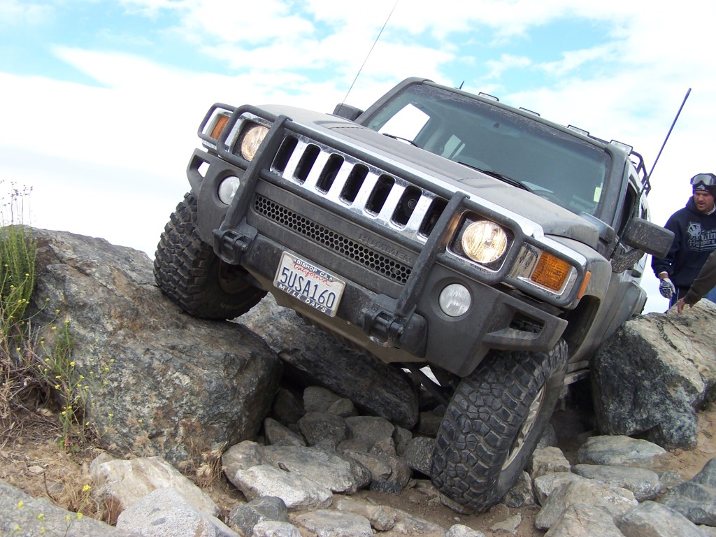

If you intend to do some rack crawling with your truck, I would skip the OEM and get the Rocky Roads. I can't tell you how much they have saved my truck from door dings in parking lots and rock bashes on the trail.
The piece hanging out worked well here:
However, the OEMs are a great price.
