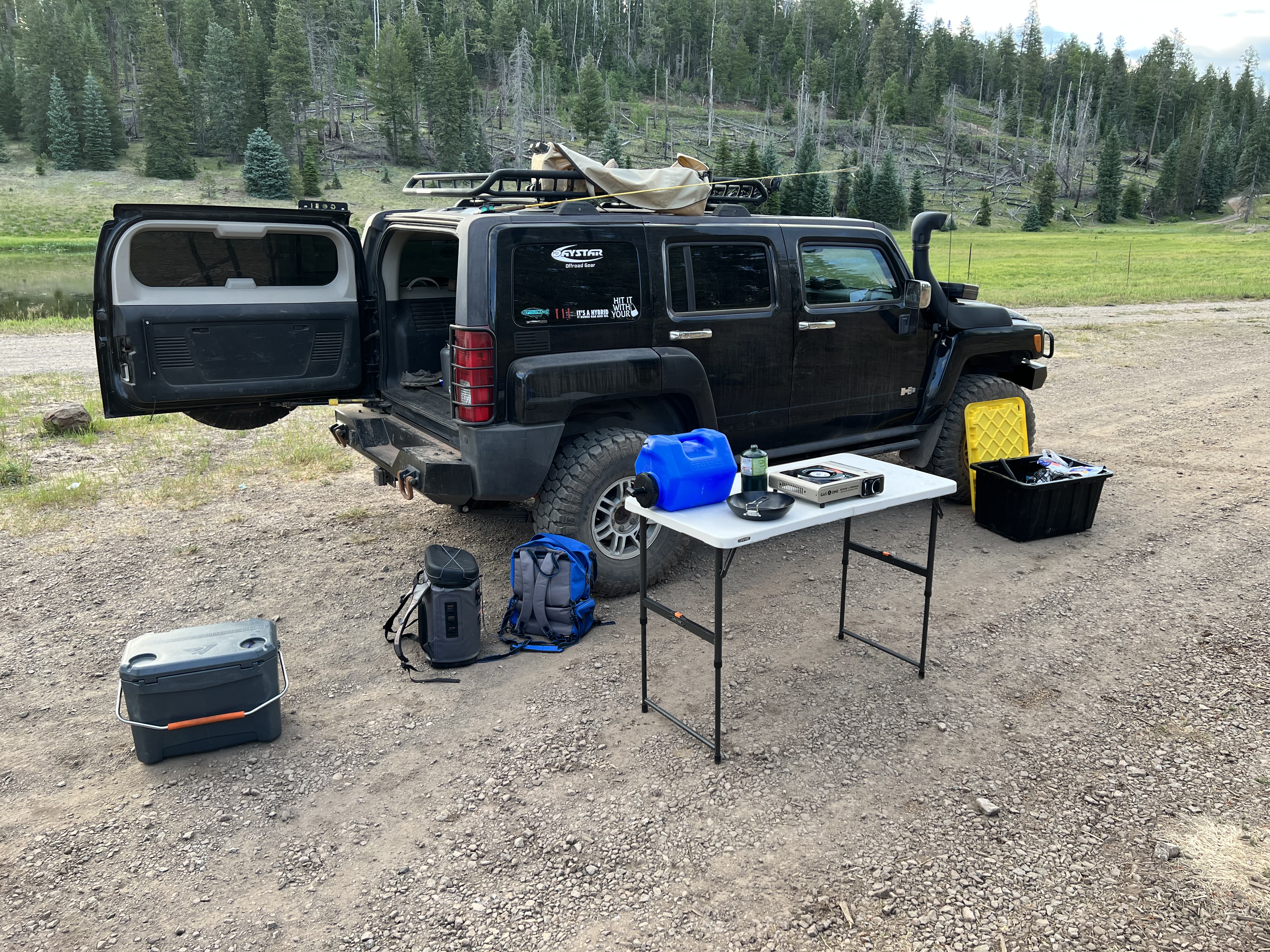

Have some miles since last comment. Drove up and did a lot of fishing up in the white mountains this weekend, including the climb getting to Hannagan meadow. Lots of high rev, 6-8% grades all weekend totaling 550 miles.
Only burned fuel.
One thing to note is that at 9k feet the truck had no power. Would take a horrendous amount of time to get up to 55mph. Probably will do a compression test as the motor has 194,000 miles on it now.
Side note: Drove back to the valley today and the 109*F and 17% humidity makes me want to go back.
