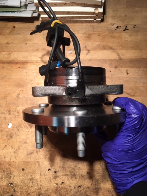

Alright it’s a wheel bearing hub…had to really yank on it, then it “broke loose”
left to right it wiggles a ton. Happy my tire didn’t fall off.
why are good brand wheel bearing hubs cheap online, but $300 locally?
Jeepwalker
978
WI
Don't buy a cheapie. Buy an AC Delco. They're made by AAM, the same as original. RockAuto or Amazon. Great quality. I bought an OReilly's in a pinch and the hubface was 'off' by .005 out of the box! That's a defective part. My wheel would have been wobbling going down the road and you'd never get the rotor to run true. I was glad I checked it.

I got one on Amazon. Somehow oreilly and autozone are upward of $289….much better brands are half that on Amazon.
had no 12/6 play but 3/9 was wobbling, what seemed like 1/4” and clunking. No other suspension or components were moving behind the tire, just the tire and wheel.
just found out I have Michigan metal works upper control arms. That’s pretty cool!

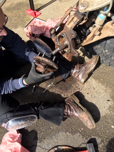

Well. I been pb blasting the wheel bearing hub forever, bashing it with a hammer….it won’t come off lol I’ve watched some videos and apparently that’s all you can really do. I’m pissed haha. Any advice? Heat? Remove the knuckle and pound it out reverse. YouTube tells me to use a large nut and bolt to walk it off of the axle splines.

No, don't use any heat. It would take a lot and weaken the knuckles.
What's worked real well for me is to lower the A-arm onto a piece of 2" diameter pipe or square tube about 12" long (or so) that's standing (upright) on the concrete. The balljoint will fit right inside the pipe. That way the lower A-arm will be good and rock-solid when you beat the old hub with a sledge hammer. Supporting the A-arm with a floor jack doesn't work very well, and blocks of wood are better, but not as good. If you don't have some pipe, go get some at a buddys. Then, you gotta use something heavy duty like a splitting maul or a 6-8 lb maul with a long handle. It might be difficult to not damage the brake rotor dust shield. If you do, you can probably hammer it back into shape once you get the hub off, or buy a new one (like $26 ea). I was going to advise buying a new brake dust shield too, ...but nobody usually listens to me anyway lol ...so...
Repeat: You gotta get the lower a-arm rock solid and get mean with your BFH on the old hub. I've done lots this way (supporting with a piece of tube on the concrete) and it works the best IMO.
Be careful on those Youtube videos. I see guys trying to use their steering to pry a hub loose. Don't do that ..it's just screw up your ball joints or steering. There's a lot of bad ideas on youtube. Once you get it to start coming loose it doesn't take much from there. Yeah, you'll get a good cardio work-out before you get it off!! I did a couple last summer on my H3 and a rusty old Jeep ...on a really humid July day and the sweat was just streaming down my face and the mosquitos were all over me. It sucked ..but I got in my week's workout w/o having to run on a treadmill!! lol. Get the A-arm supported 'solid' and then your hammer whacks will mean something and it'll come off a lot easier.
You did remove the center nut and tap the axle loose, right? Don't beat it hard, just tap it loose.

Autozone puller was a no go. My god. I’ve beat the **** out of it. Soaked it multiple times.
what else guys? Take off the knuckle?

Mi hubs were rusted and like baked on all the rest when i changed them. I've purchased the entire kit hubs+bearings and ABS cable.
To remove mi old hubs, put LOTS LOTS of Rust blaster and WD40. Wait few hours !!!!!
Then with a 2.5kg hammer, hit the hub from behind left,rigt, left, right .......... and they came out.
if you have more truble, put some old 19mm bolts on the hub and hit them from behind left rigt , up down.
It took me like half an hour each side but the hub came out without any damage around.

I think I’m going to remove my knuckle. I’ve gone through a while can of rust spray and murdered it with a hammer. I’m a big strong guy haha I got my ass kicked by a hub.

:shame:eek:k big guy don't give up so far, if you have a solid steel bar and drill 2-3 hols in it to fit on your hub, you can bolt the bar on and hammer all out, i'm sure you can :thumbs:
