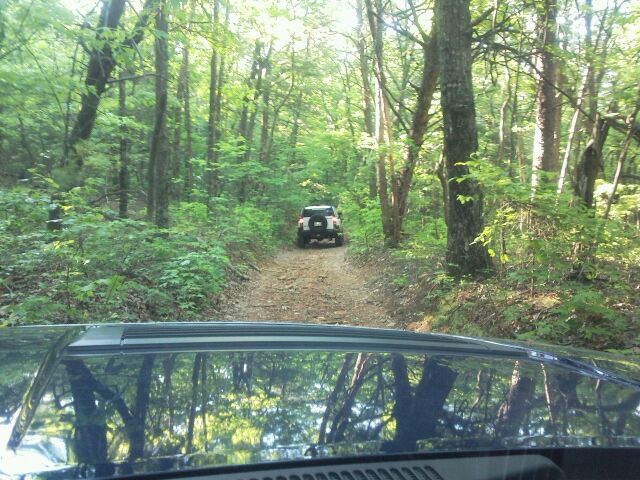

Yeah man, the trip started out so well, one minute we were heading into the deep ga woods and then Bam! stopped dead in our tracks.
heading in
the moment before impact, we had just finished picking a line to take.
