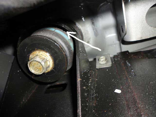

After dealing with clunks/clanks when taking turns in my H3, and fiance's popcorn factory H3, we decided to come up with a plan to fix the body mounts once and for all. After doing lots of research on the so-called TSB fix, with the new upper body mount anti friction material, as well as other threads of fixes none seemed to address the real problem. Folks that have had the TSB fix, have stated that the noises returned soon after. They all masked the problem. They didn't fix it. The noise comes from the upper bushing being compressed when the body flexes, making the complete bushing assembly loose. See diagram below:
After determining that there is no pre-load on the lower body mount bushing, a quick solution to obtain preload was to add a spacer/washer, between the lower bushing and the frame. The only other way to add pre-load is to cut the metal sleeve (please see pic below) and cut the bolt approx 1/4" each.

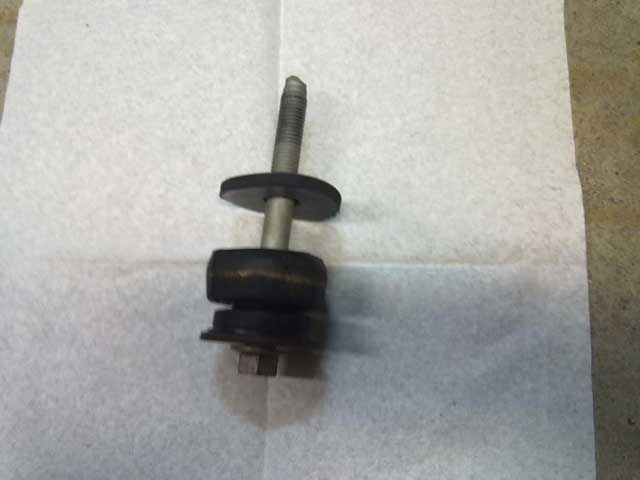

Instead of cutting the metal sleeve and bolt, we made a 1/4" rubber washer out of heavy duty rubber mat. By using a 2 1/4" hole saw and 3/4" inch hole saw on a drill press, the homemade washers were less expensive than the local hardware store. We made 12 washers for each vehicle.

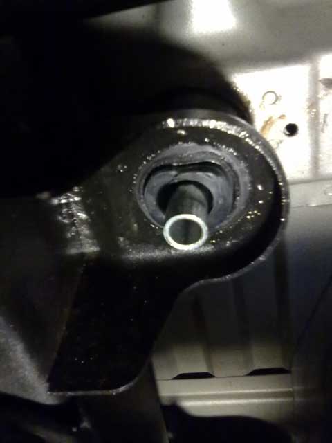

Next we placed the washer on the metal sleeve up against the frame, and reinstalled the lower bushing/bolt assembly. The hole in the middle of the rubber washer was cut so that it fit snug onto the metal sleeve. The metal sleeve fits up inside the upper bushing between the frame and body.
The pics below show the washer placement.
This is the finished result. The lower body bushing now has pre-load, which in turn holds the whole assembly snug. By design there was no pre-load on the lower bushing because of the sleeve. The bolt would tighten the two washers up on the sleeve, not allowing adequate pre-load on the lower bushing. The top bushing has the weight of the body on it.

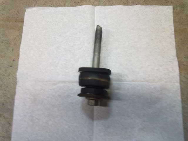

Similar results were achieved when I installed new front shocks. I had to cut the stock sleeve approx 1/4" so that the shock bushings would have adequate pre-load on them. This resulted in eliminating pounding when driving the vehicle.
The arrow in the pic below shows the placement of the new washer when installed.
