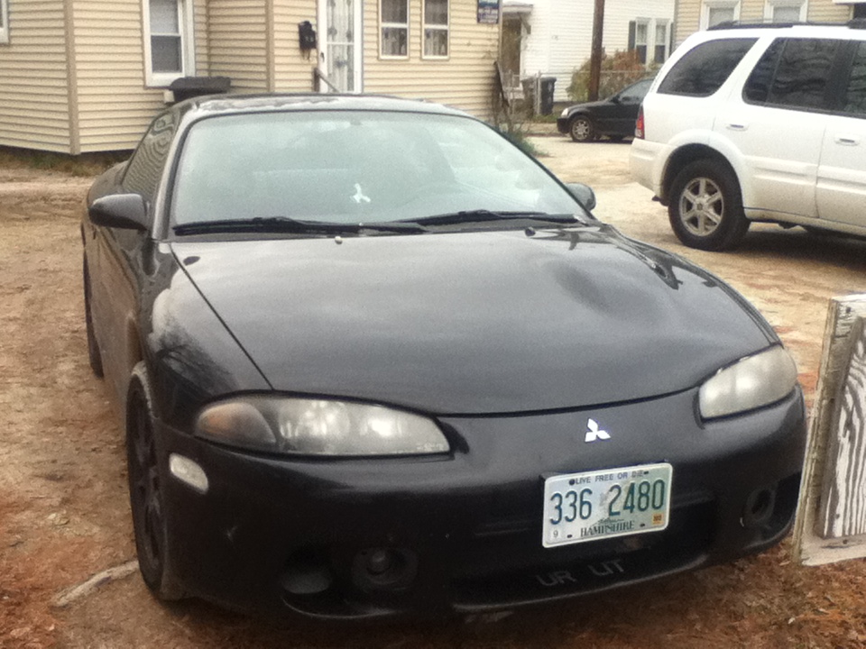

Well, here's what I hope to pickup soon................as long as the wife ok's it. :p

Nice! Does it have the 6 cylinder in it?
Nope. 4g63 turbocharged 2.0 liter I4.
The 4g64 V6 in Mitsubishi Eclipses started in 99.
I believe the turbocharged I4 made just a little more HP and torque than the V6 did.
The one i'm looking at has all the best options. GSX turbo with AWD!
